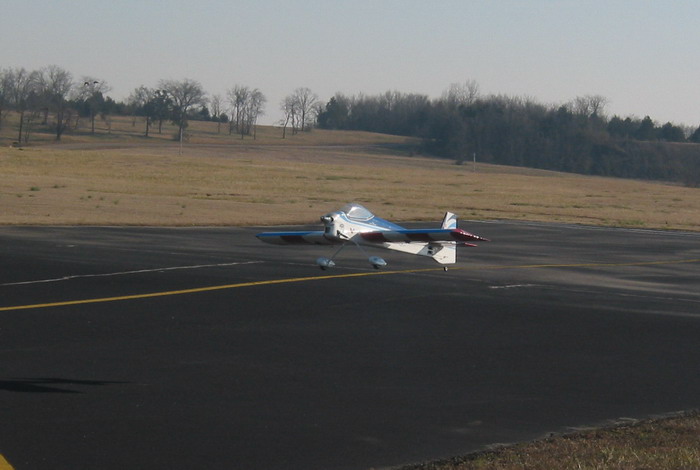

The temp hit 50 around 2:00 so I headed out to the field for the maiden flight. I had adjusted the servo horns so they were pointing towards the stab and then figured out a way to adjust for the off centered elevator servos. I adjusted the control horns so the push/pull rods were level with the servo horns and then adjusted the control horn connector to the short push/pull rod to take out the difference in the throw. For fine-tuning I used sub-trim to get them perfect on one servo only. This mechanical with sub-trim adjustment allowed me then to use equal throw programming when mixing in the Tx. The benefit is that I now can adjust the throws in the Tx. without having to counter for the servos being off centered. The wonders of a programmable Tx.
The maiden flight went very well. I had my friend Chuck along for help just in case. We had a few mishaps form the get go. For some reason that I haven't determined yet, the remote glow failed after starting the engine one time. Will have to check this out to see if their is a ground issue or if the lead into the remote glow came lose. Then one of my mounting blocks for the cowling came lose when starting the engine. Hm....poor epoxy job on my part but easily fixable.
I had 100% throws to ailerons and 60% to the elevators with 100% to the rudder. Way too much aileron for the low settings. She would spin on a dime and was very touchy on the ailerons. Brought the ailerons back down to 55%, changed the rudder to 110% and left the elevators at 60%, so I can get a good feel for the airplane. Even with these settings she was very responsive.
I didn't try anything wild and crazy on on my first flights because I wanted to get the feel for the airplane. The other stuff will come. Just flew her around for a while to let the engine break in and to get the feel for how she flies. Take off was simple at about 1/2 throttle in about 30 feet she was airborne. Tracks very well down the runway even in an 8-10 mph crosswind. Very stable. Flies very easily at very low speeds and goes easily vertical with the 91 Surpass. Nice engine for this airplane IMHO. Landing was just as gentle and easy. She will float with the elevators holding the nose up to make a nice touch down. Just a nice overall airplane, but then I took it very easy on my first flights.

Roger, Congrats man. Looks great! And you brought it home to boot. Try going lower on your rates, don't let this kitten fool you. It can get out of attitude just as quick as it responds. Ease into the higher settings. Good luck and keep us posted. Joe
