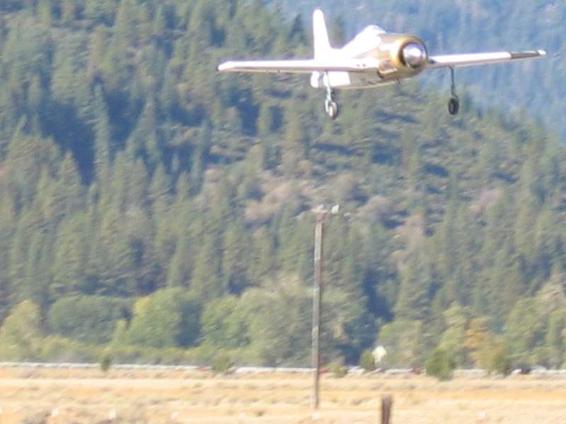

Well, My Bear flies!!!! It had a nice, uneventful Maiden flight. No issues what so ever other than needing some more ponies under the cowl (I fly at 5000', so the YS 91 would probably be just fine for sea level flyers. Other than that it took about 2 clicks of right aileron, and about 5 clicks of down elevator to trim it out. A friend has a YS 110 sitting on his bench, so I'm going to see how much better that will do than the YS 91....But I'm pretty much set on the fact that I need the YS 140 or a saito 180 for this bird....I'll probably get which ever ones heavier, as I'm almost certain that it will still need lead up front. But The Bear flew great!!!
here some photos!!

Congratulations!
nice site you fly from [sm=thumbup.gif]

Old 09-29-2004 | 05:22 PM
  #395
HighSierra's Avatar
Posts: 572
From: Nor Cal, CA
Default RE: ThunderTiger Rare Bear
Thanks!!!
I fly at a little country airport Itsees about 10 planes on a busy week and has no services so "real" airplanes aren't really a problem. Good ole Uncle Sam just spent $250,00 re paving the whole thing so it's really nice (allthouhgh I should probably call Tom Borckaw and NBC news to do a "Fleecing of America" episode on it....)
As for the cowl DT, It wasn't off by much, so I just tried my best to get it centered (It acctually seemed to be a little more off in the vertical axis than the horizontal) I'd at the furthest point where it lines up with the fuselage, maybe an 1/8 gap at most, and that's being liberal..... But in no way does it line up straight if you push the cowl on as far as it will go against the indentation on the fuselage.
