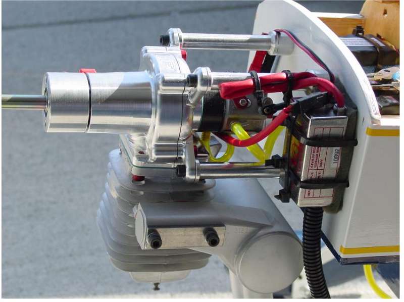

Hey guys,
Thanks John for the complements on the Edge. This is the one John flew and it does fly sweet. It is the old one but it’s not old to me. Here is a run down of the setup I used:
DA-50R on 3 ½†stand offs, w/stock Slimline Pitts Muffler
Bisson 3.5 Fiberglass spinner, 24x8 prop
Servos, 4x5945 Digitals, 1x8611, and 2x225 soft mounted servos for choke and throttle
SWB servo arms all around
MPI Super Switch regulators and extensions
Fromeco 3x2400 batteries (Ni-Cads were in first, now replaced)
Du-bro hardware
H9 titanium links on ailerons
Central Hobbies CF push rods with titanium links on elevators
20oz fuel tank
Airtronics radio
Bevel-to-Bevel on elevators high rate 70% expo, 15 deg low rates 30% expo
40 degrees ailerons (blistering roll rate) 40% expo, 25 deg low 30% expo
45 degrees rudder high rate, 35 low no expo
Total weight came to 16.5 pounds and with the new BME CF upgrades I should be around 16 flat. It balanced right at 4.5†when complete and I am now flying it a 5â€
The model was covered in Monocote. The model originally came in the teal scheme and was an absolutely fantastic covering job on the aircraft. I wanted a scale look so ended up striping it down to the bones and recovering it. I have pictures of the aircraft in the buff I can post if anyone is interested. Thanks Max for the Arc’s
I have used over 12 gallons of fuel and hundreds of landings on this aircraft and have had zero problems with the airframe, cowl, landing block, or motor. New or old, this is a fantastic airplane.

Nice job on the recover. I am undecided to do the same on mine. I may just say the hell with it and fly the snot out of it. On that note, it's good to see the Edges being sold in ARC form as well. Just noticed your setup. My carb is 180 deg from yours.
No issues with it so far, after getting it back from DA for all of the updated mods. When I bought it I asked if it had been updated, and my vendor informed that it had, but the DA work sheet says differently. Pretty new everything. I had to redo the break-in. Not enough juice through her yet, as I have been leaving it rich and am slowly coming up on the high needle, and on a NX 22x8 prop, I have it at 6300 right now.

Hi Spar,
The covering was a personal thing for me. The original covering was great but I did not care for the colors. Always wanted one is this scheme anyway. Thanks for the complements, BTW beautiful picture of yours climbing out.
As far as the motor, mine is one the first from DA with the new updates. The carb came mounted that way and since it was a new airplane there was no reason to reverse it. I am now flying it on a 24x8 BME prop.

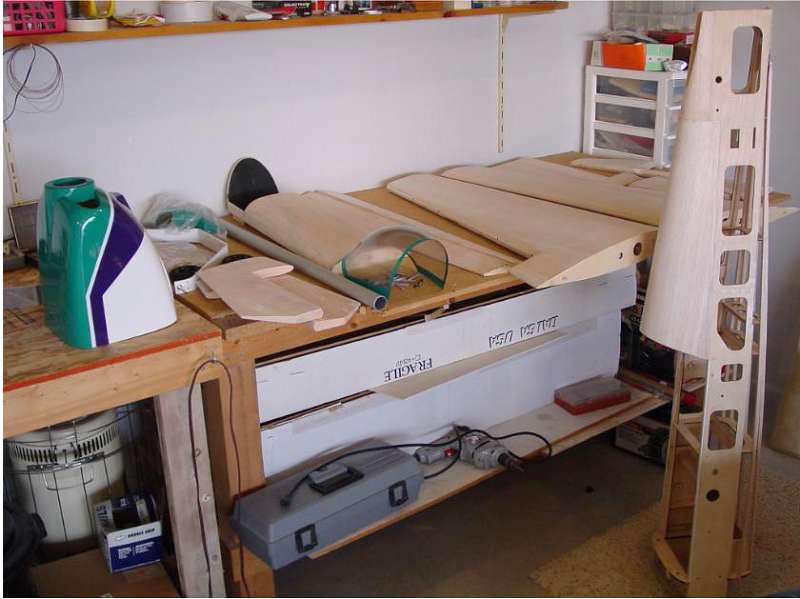

Here are some pictures of the Edge prior to the recover. First picture is out of the box, second picture is 30 minutes later after pulling the covering. Third and forth picture is after the final sand and ready to recover.
Ken

Thanks Ken, that looks very well built, don't see any fillers on the joints like some other ARFs.

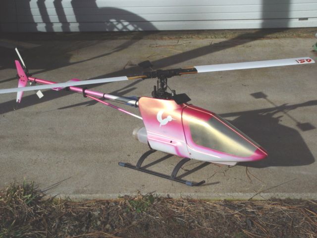

I have been selling off some of my unwanted RC stuff to finance the rest of my Edge parts. I will be contacting you soon for more goodies!
Dan Clemens
Summerville, Oregon
PS Know anybody that wants a nice 60 size helicopter and radio? hehe!
