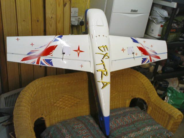

Hi
Ive been bought a CMPro Extra 330L 50 size for Xmas, still boxed and untouched. Looks great I thought! Nice looking kit, well made at first glance.
However two club members have already flown theirs, one electric and one with a .70 4 stroke and both have turned out to be complete dogs in the air. One of the club members is an ex competition flyer and his opinion means a lot. Unfortunately I do not know what motor he was running or prop but his just sank in the turn. Both were very tip stally, if you cut the power they just drop out of the sky! I think CMPro has made this plane too heavy to too smaller wing area and need to be flown fast. Both members have decided to sell this extra.
I wouldnt call myself an expert flyer or anything but I can perform most 3d manouvres. I dont want to waste time on a plane thats going to cost too much tinkering. I want it to be fun and slightly challenging, not bloody impossible!
Do I stick or twist?
Theres little user reviews online, anybody here got one? whats the story on this plane?
Many thanks
Guy

If you mean one of these: http://www.nitroplanes.com/blex332c404c.html
Make sure that you do everything you can to avoid adding unnecessary weight.
I put a 2C .46 Tower Hobbies engine into one and it flies pretty well. No problems with verticals.
You have to experiment with the C.G. if you do not want the nose to drop in turns, although I'm quite used to this with all of my biplanes, so I normally correct w/o thinking.
The C.G. placement is a bit touchy, moving it .5 " back or forward makes a big difference so be careful.
If I recall correctly the thrust angle needs a bit of adjustment as it comes. I recall that it had too much down thrust and maybe not enough right thrust.
Once "dialed in" it's a good flyer.
I really haven't had problems with uncommanded snaps, as I never let it slow down that much on turns into final.
Like most highly acrobatic planes, it is designed to snap quickly.
If you are not used to this, it may catch you unawares.
I'd suggest keeping it high in the air until you are comfortable with the way it flies. Likewise make longer approaches straight in until you know how it will react, especially in cross winds.
It's not a "difficult" flyer, but you'll want at least 20% expo on low rates and about 45% on high rates ( over 50% makes no sense on many planes.... ) to keep it from seeming twitchy, due to the excellent response. It rolls very quickly.
It's not a "dog" by any stretch of the imagination, but a .70 4C engine may produce too little power for this plane depending upon the output of the engine. e.g. the cheaper OS .70 sized 4C will definitely produce an anemic performing plane IMHO.
The finish and build is excellent ( re-enforce with thinned epoxy and CA everywhere you see wood ) but I wish CMP had used CF landing gear on this plane like they did on the Giles 202 .50 ver. 2.0. Not a huge problem though.
The hinges use pin hinges instead of CA hinges, and are both pre-drilled and slotted very well. Installing the control surfaces is trivial because of this.
The only hardware I changed was the tail wheel gear, for which I substituted a much better $2.00 cost, assembly which you can order from Tower as a part for the GP Ultimate and other planes.
Other than the engine mount and tail, I actually used the provided hardware and haven't had any problems with it.
Standard sized ( cheap SG5010 ) HiTorque servos all around on mine.
That's all I recall off hand.

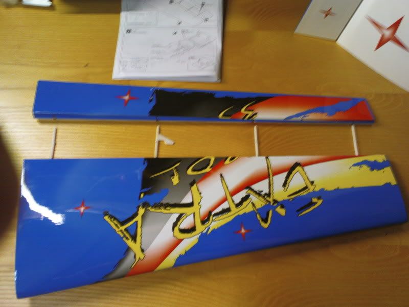

me and my dad got given one of these planes each for x-mas last year, dad built his with 55ax and i left mine in box, and thank bloody god i did!!!, its honestly the worst flying plane i have attempted at flying to date. landing is a nightmare. and ohh yeah makesure you check for the gluejoints where the wing tube enters the wing, this plane only got 3 flights, and that was only doing circuits trimming it out and about 2 knife edges along the strip, and WHAM!!!, the right wing ripped off as the glue had let go around the wing tube brace, so in goes a $250 lawn dart on its 3rd flight, if you want my advice, stick with the twist
Now im not bagging cmpro, as i have there 140 giles, 140 extra, katana 50, extra 90 size, and they have all been great quality and flying planes, but in all honestly i think they made a very big mistake with this 50 size one, it is just WAYY to heavy for its size and the wings are tiny. and it needs around 100 grams of nose weight if you use a 46 engine

One of the guys I know said the main wing pole is tight when you first put in on but becomes very loose when the over hanging paint layers wear off i.e. after a couple of times putting it together.

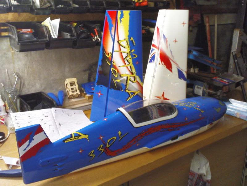

I finally started the build tonight. Short on time at the moment with a new born. Got the ailerons glued. Tomorrow I will steal the radio gear from a mustang I will not be flying for a while. JR 591 servos and JR receiver.
I will reiterate what others have said about the instructions with this ARF. They are rubbish.
Cheers
Guy

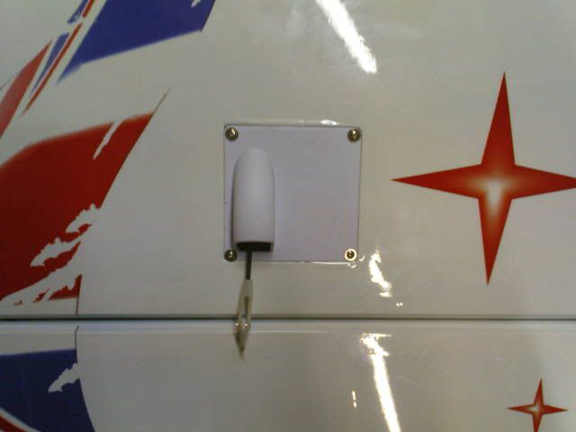

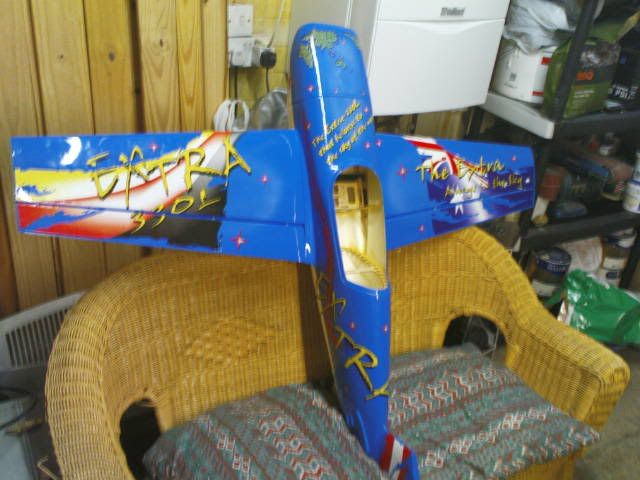

Hi all
Well still not got a great deal done yet. Tried the wings on for size. Seemed to fit nice and tight. One of the criticisms I heard was after removing the wing pole a few times it becomes a loose fit. Mines stayin put then. May even glue in after a few flights.
Servo hatches installed, so far so good and no complaints about the hardware like I have seen on other threads about this plane.
I did start sanding the fuse where the stabs are to be glued last night. Checked pole for size and its very tight, so tight in fact the pole is permanently fitted into one stab with no glue. Any ideas how I should remove it without breaking so I can glue it? Or should I leave well alone considering I will take great care in glueing the stabs to the fuse.
I have a 12x8 apc prop for the Saito FA80 so far, any other props I should take for the first test? I recall somebody saying somewhere they used 14x?
Also what is the easiest way to change the thrust angle from the standard?
Cheers all

ORIGINAL: GuyP
Cheers all
Cheers all
Use something that will grip the wood, such as a small pipe plyers set... and try turning it a bit first.
Don't damage the dowel, you are merely trying to see if it will turn if only a bit, at all.
If it does, then turn slightly in each direction as you attempt to pull it out, to work it free.
If it doesn't, wick thin CA into where it joins the wing. This will adhere it even more.
