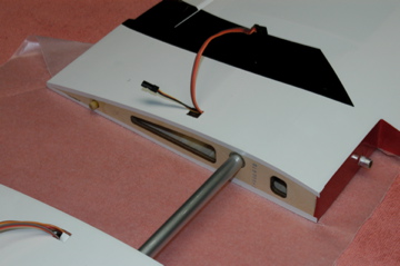

Here are a couple of photos of the wings and how packaged. Also how I modified the servo mounting plates to minimize the opening for the servo arms.
More on the assembly later.

So there are 4 servo's in the wing then? 2 ail/2 flaps?

That is correct. That is why they tell you seven servos. Install is easy.
The hardware package is complete and of decent quality. I have decided to use all that is sent with the plane to make it a good review. I plan to do a full report once done, but here are a few more photos. The wing matched up perfectly and the aluminum tube did not need and filing to fit. 12 minute epoxy used to hold it together. BH include a white plastic masking tape to cover the seam. The control horns are unique, the aileron and flaps have holes pre drilled and using a hot pencil soldering iron I melted out the covering and inserted the black plugs and screws. I used blue thread lock to keep both nuts secured. I did not use the pushrod keepers, Z bended the rod instead, lost a plane to a bad keeper.
More tomorrow.

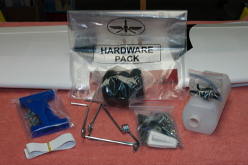

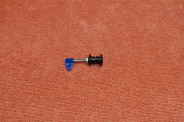

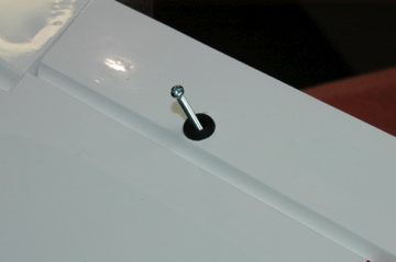

Hardware package, wing joining, servo horn and install.
More later today

looks like accesories from a phoenix arf I bought from tower, I think they are made in vietnam.
Thanks for posting pictures.

I was going to say the same along with saegull. They both have the same hardware supplier by the looks of it. Not too bad I guess.

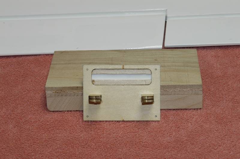

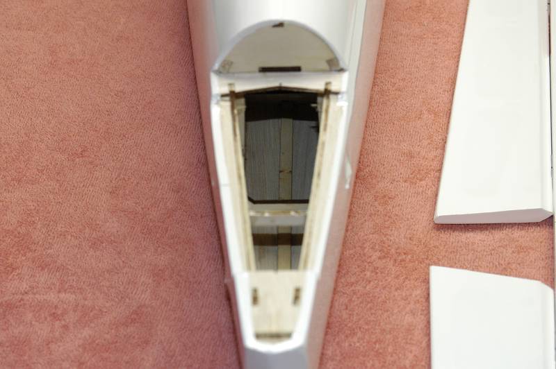

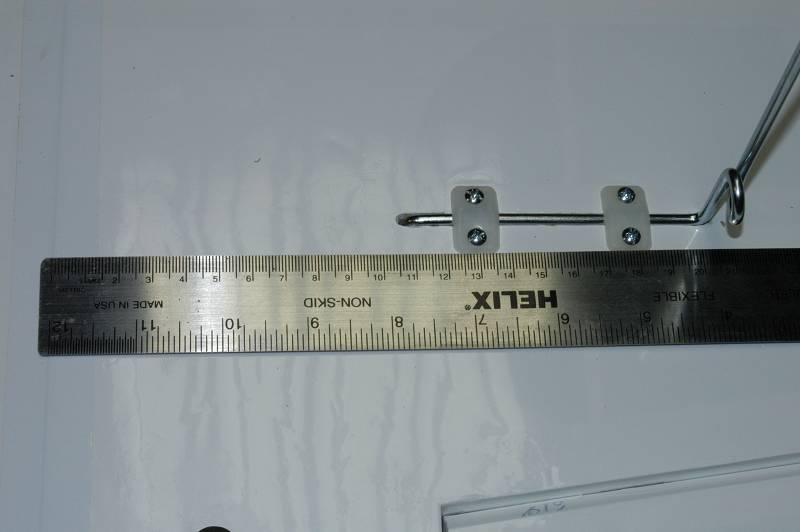

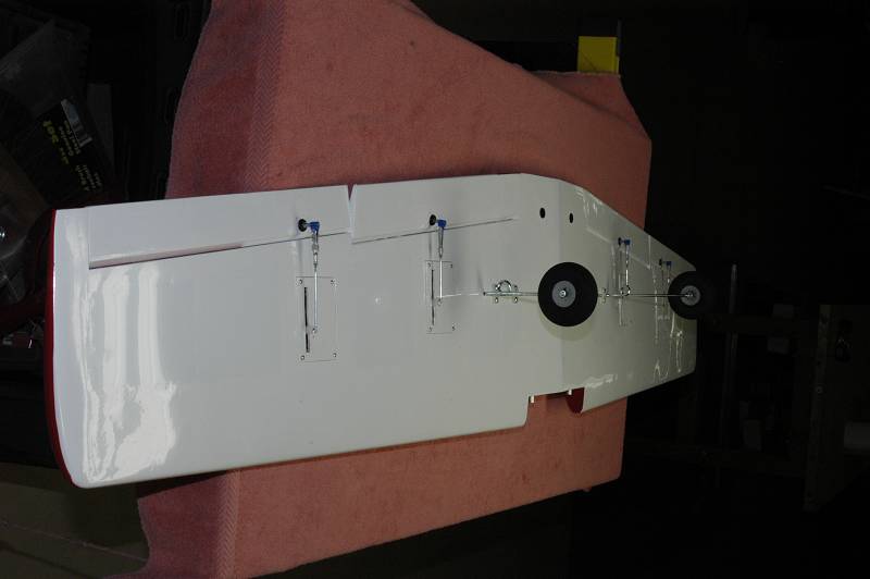

Here are the rest of the wing and landing gear install. About 3 hours to make up the wing, including the mods to the Servo plate.
In doing the landing gear install by shear luck I found that there are holes predrilled for the landing gear plastic hold downs.
There is no mention in the instructions regarding these holes. I have shown the approx location for those of you about to build.

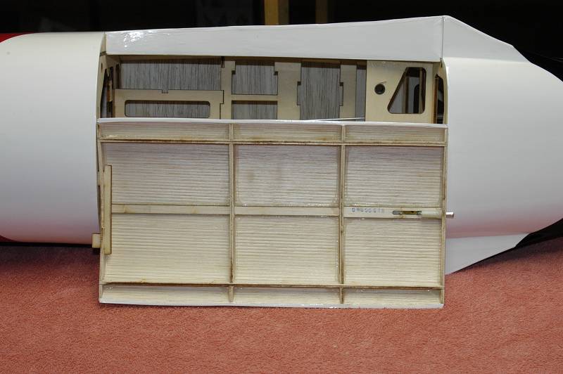

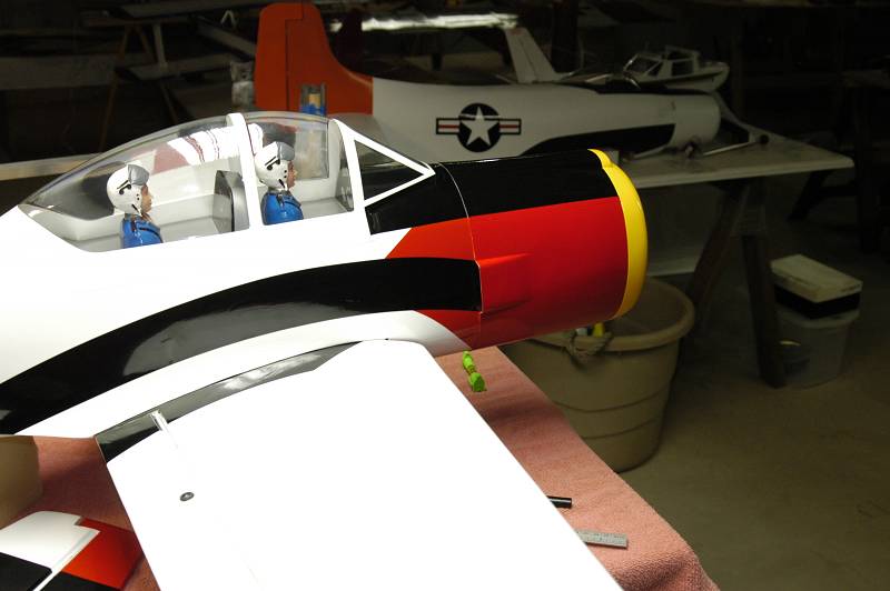

Now for the real heart of the build, the FUSE.
YOU are in for a treat !!!!!!!
Here are the first photos, Makes a grown man want to cry it is so beautiful.

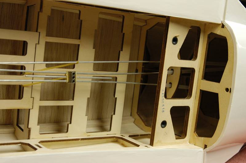

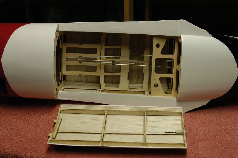

Internal shots of the fuse. Nice construction.

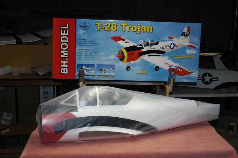

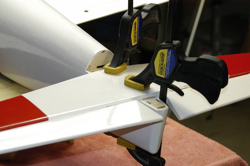

I have skipped over the engine install, next in the instruction book, as my Saito is on the test bench after installing a new Carb. Here are some photos of the Tail feathers build up.
Also note that I will be out of town tomorrow for a golf outing. Not playing scoring, www.egolfscore.com Will not be adding any more to this site till most likely Saturday. SORRY
As I have noted in the original thread I plan on doing a complete review for RCU once the T-28 is completed with Cheers and Jeers. There are additional notes about the build that I will add to this review.
For the most part it is straight forward and an easy ARF to assembly.
JimO
