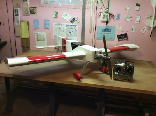

Wile E 07-03-2018 09:05 PM
Thread revival: Rascal 110 firewall dimensions
Hi Rascal fliers. I have a 50cc gas 4 stroke that has equivalent power to a 38cc gas 2 stroke, just swings a high pitch prop very quietly. Can anyone give me the dimensions of the Rascal 110 firewall?
Thankshttps://cimg0.ibsrv.net/gimg/www.rcu...b903421785.jpg
SrTelemaster150 07-12-2018 10:42 AM
Here is a Saito FA-180 installed in the Rascal 110. It barely fits. It is 138 mm from the prop hub to the back edge of the carburetor and 113 mm from the crank C/L to the top of the ricker covers.
https://i.imgur.com/W9Sjw21.jpg?
https://i.imgur.com/EB1q4px.jpg?
https://i.imgur.com/NuKbboI.jpg?
A gas powered Saito FG-30 would have a similar footprint but only puts out about 2.5 HP while the High compression FA-180 with CDI and methanol makes about 3.25 HP.
