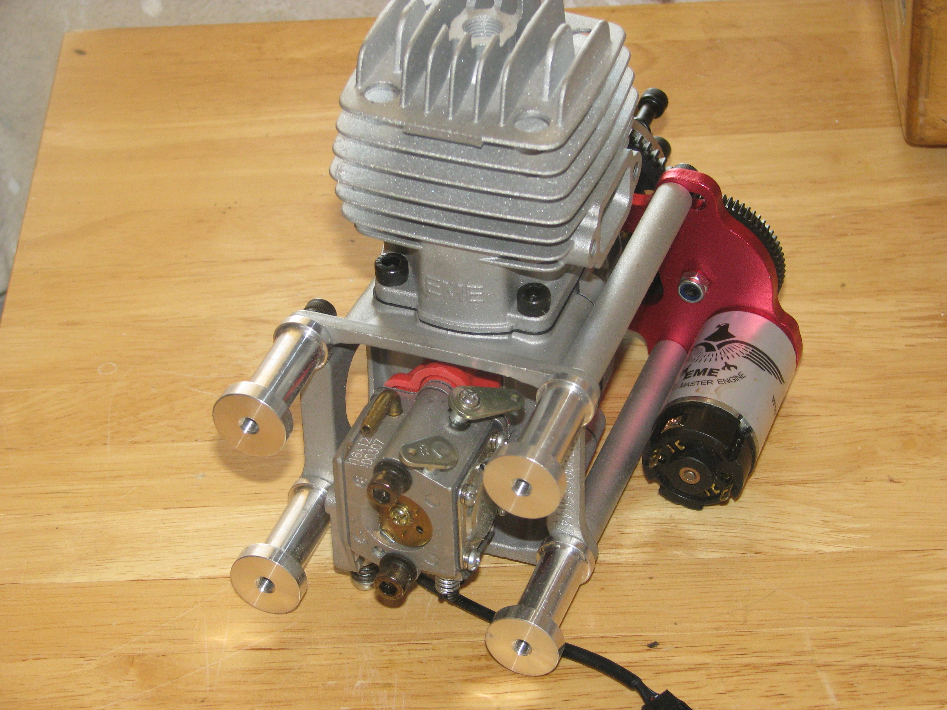

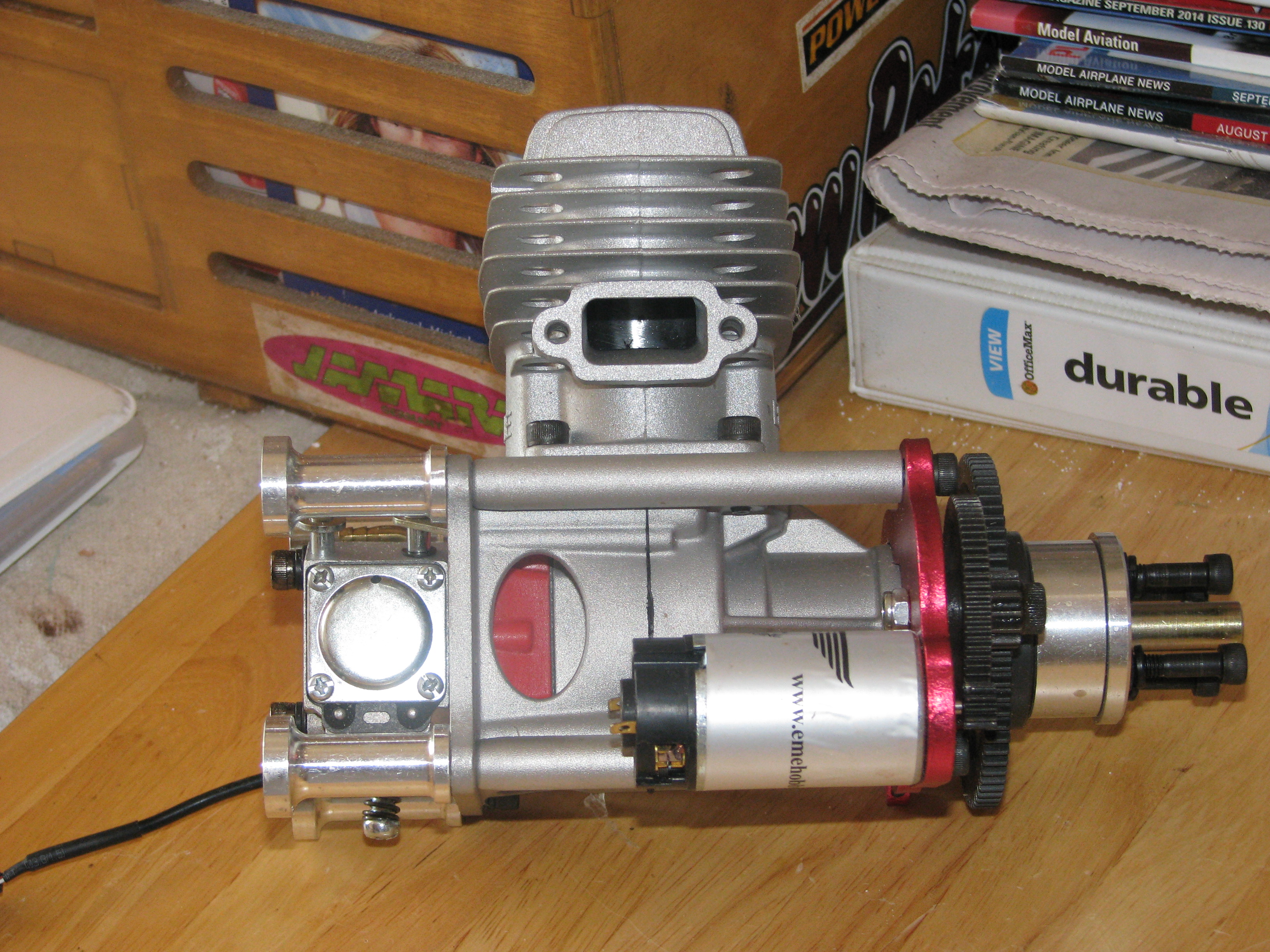

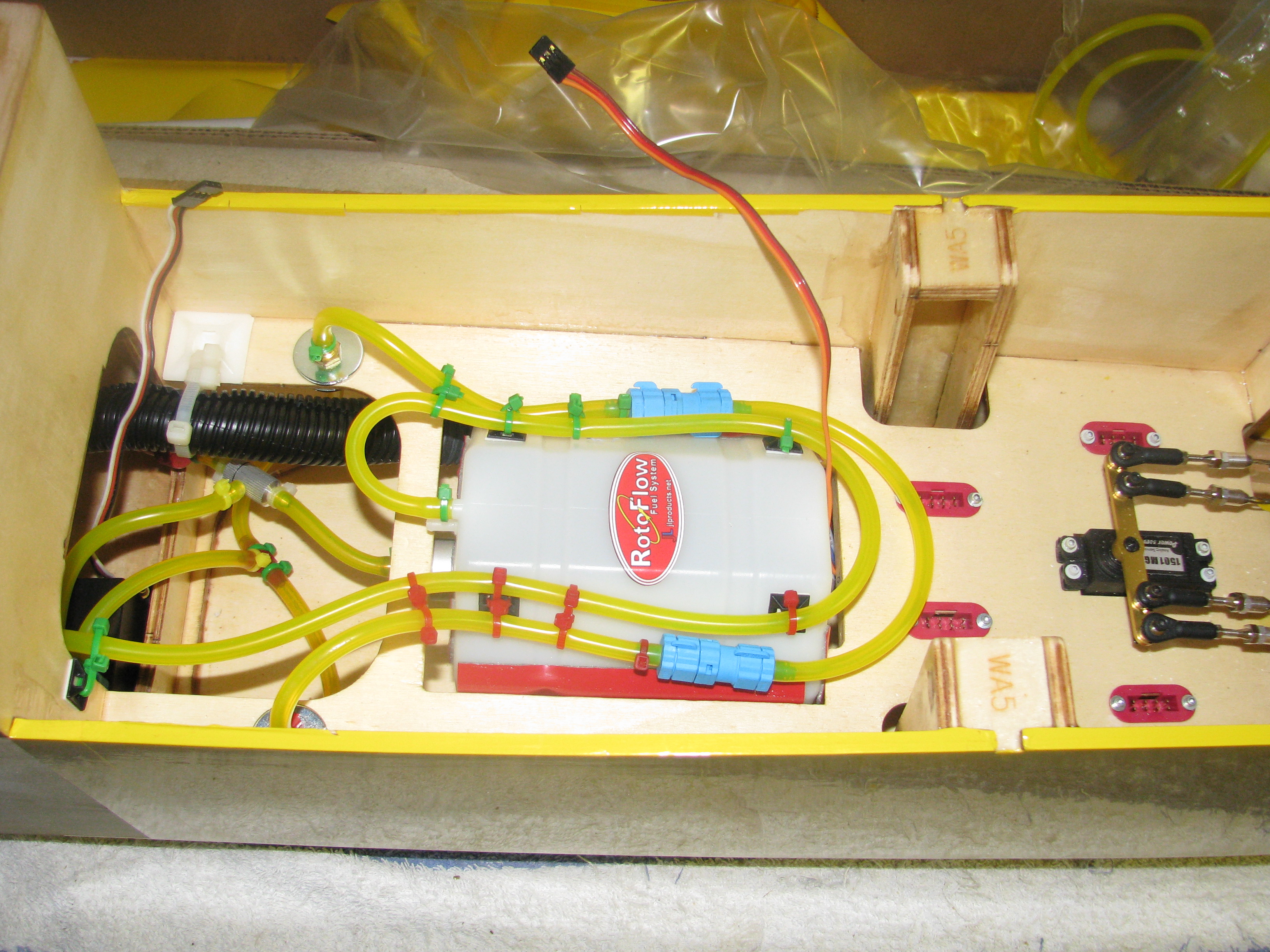

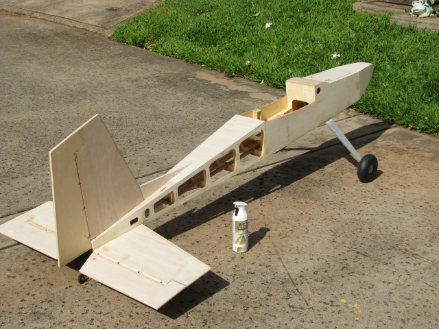

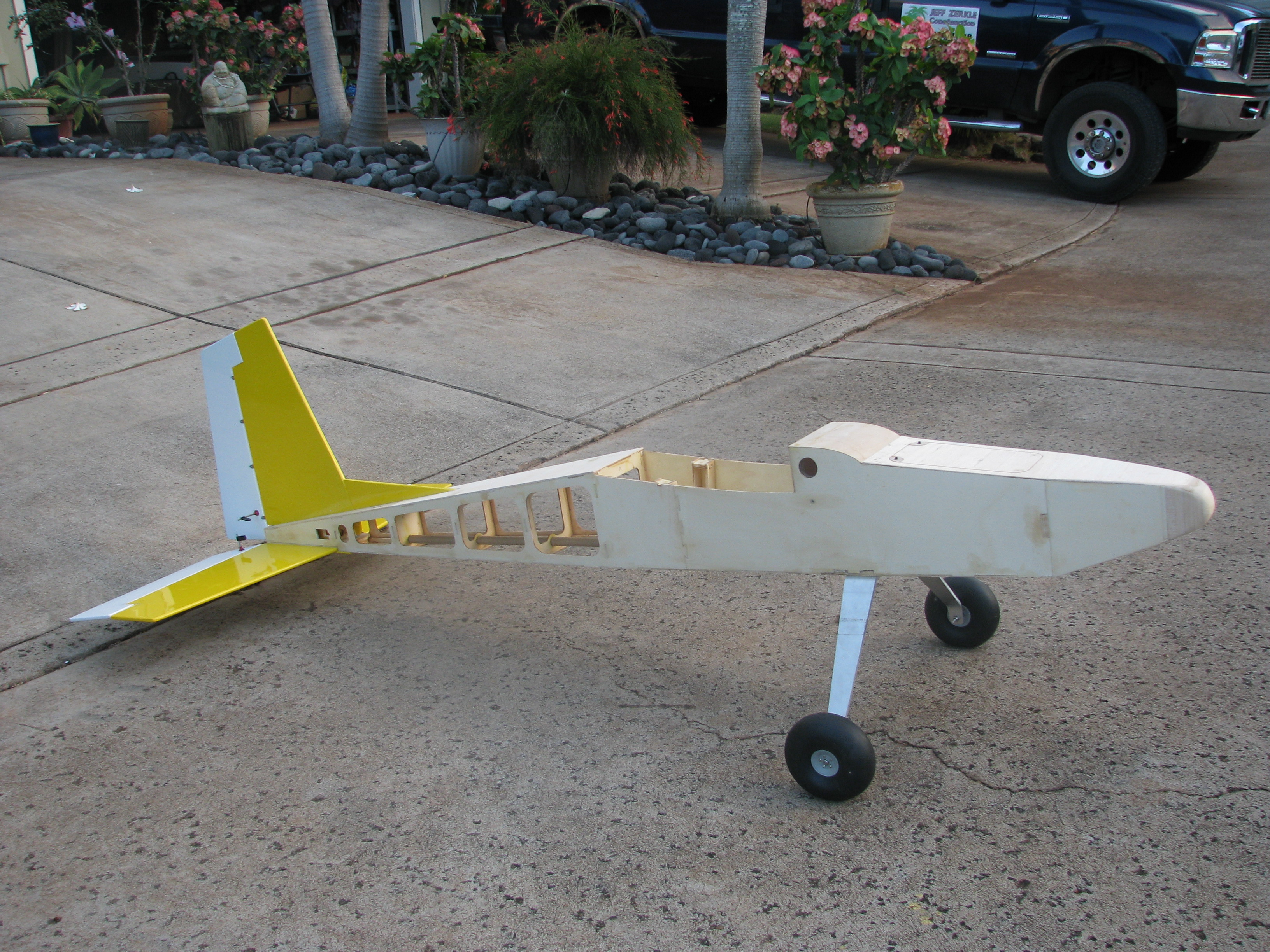

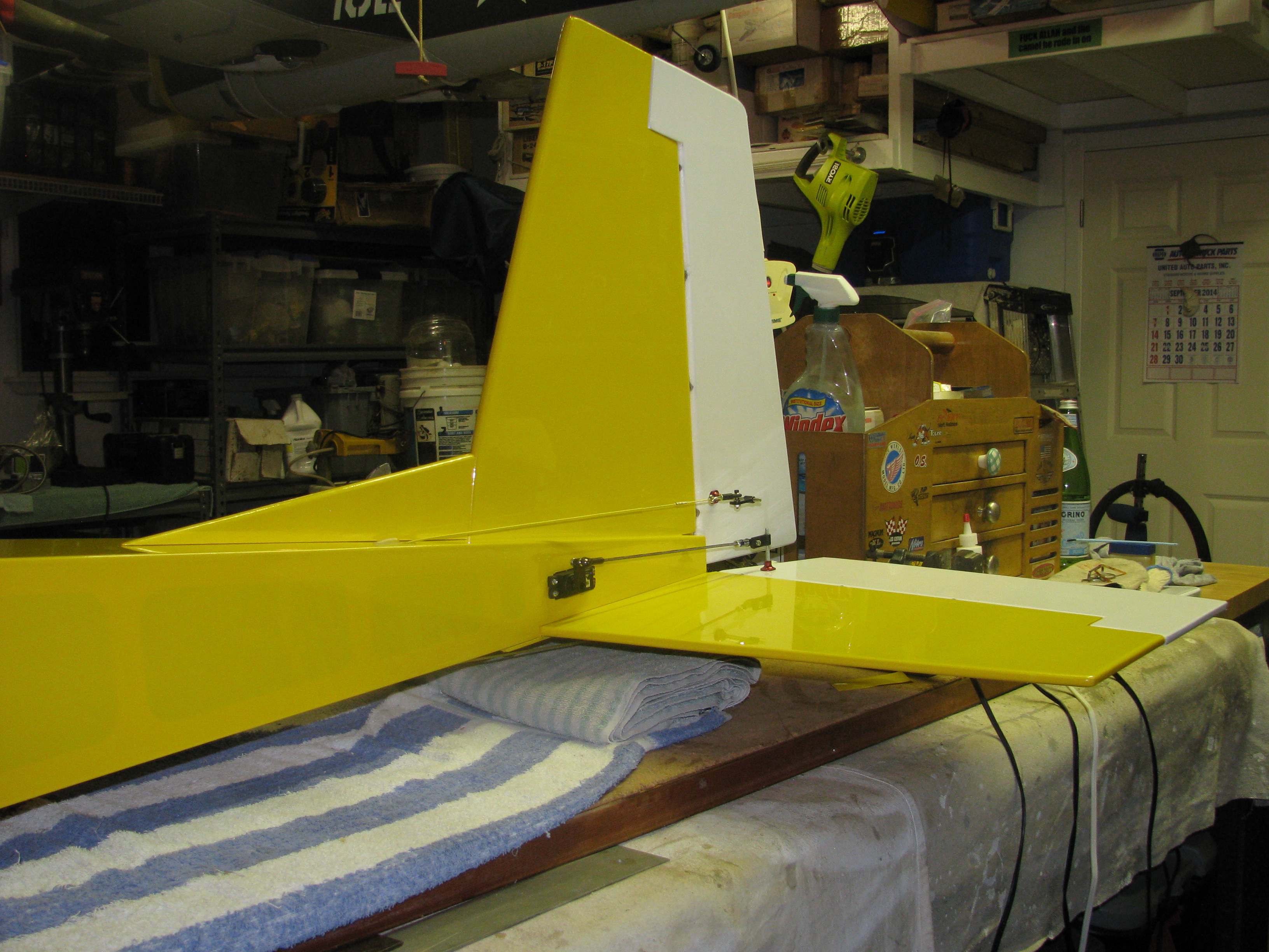

Bob Paris 05-16-2015 11:52 AM
7 Attachment(s)
Hay StZ,
To be honest the fire wall on my last stick (stik...who cares...) was not modified to hang on to the RCG 20cc gas engine. I did coat the inside of the fuel tank bay with thinned epoxy to keep things tight and it work well, until the ground jumped up and disabled...reknitted my airframe...Grrrrr ( I just hate it when this happens). Since I did add fuel tank bay top hatch, I made sure I beefed up the hatch area and used six servo mounting screws to secure the hatch. I made a solid 1/8" aircraft grade plywood frame inside the fuel tank bay to support the hatch door, and the hatch door was made out of the same ply. This is important so that the stress of the power plant will not distort the forward part of the fuselage. I like a solid nose to all my Sticks, because this area gets a real pounding and if its weak...in time things will come lose in this area. Did you ever see an engine depart an airframe...I have...and on my models too, so learned a while ago to make this area nice and stiff. I will even lay in 1/32nd. aircraft grade plywood onto the sides, inside the fuel tank area to strengthen up this area of the nose.
Please take notice, that there are two kinds of plywood available to us in the hobby. Aircraft grade quality plywood and light ply. Most of today's ARF's are built with light ply...and not a good selection in my opinion, but cheap to buy. I use light ply in some applications, but I buy and use mostly "aircraft quality plywood." What I mean by "aircraft quality plywood" is the stuff real man carrying aircraft are made of. The difference in price is a bit more, but in strength..."aircraft quality plywood" is hands down, triple the strength for the thickness, then light ply. I buy my plywood from Balsa U.S.A. and I have used them for my plywood and balsa purchases for many years. If you ever see a larger model built of light ply have a hard landing, most the times...the damage done is near total. Usually the landing gear is ripped out and the fuselage is seriously damaged. If you kit build or build from plans...the same model and can select proper ply wood, most the time all you will do is spread the landing gear a bit with little or no damage. In the years past, there were no ARF's in the hobby and every one built from kits or scratch built from plans. But today that is not the way most fly. Where light plywood will have three layers to the plywood...aircraft quality plywood will have five or seven layers of wood, with better wood too. Asia light plywood is no were near the strength of quality aircraft grade plywood and is made out of softer wood too. Quality aircraft grade plywood 1/64" thick has three layers, 1/8" five layers and 1/4" up to seven layers.
No need to split the ailerons for flaps...go with flaperons. If you have a computer radio its a simple mix and they work like a charm...and in the air...you will have a much more responsive Ugly Stick, with full span aileron action. I set my flaperon option to three settings. "zero" flaps, 15% and 30%. With full flaps, make sure your ailerons have full travel. If you make full flaps go down to far, with flaperons, you will not get enough down movement to the aileron down deflection. You do not need a lot of flap to get a real reaction to your Ugly Stick.
Another thing I use is "differential ailerons." That is more up aileron then down aileron, with aileron application and this helps with adverse yaw issues. While were at it...use a bit of CAR, coupled aileron and rudder. You mix in a bit of rudder with aileron movement and this helps cancel out adverse yaw action with aileron application. If you do not know how to mix this with your transmitter, either find a more skilled pilot to help you mix your Tx (transmitter), or go to the manufacturers web site and call some one that can dial this in for you. Most all modern Tx's can do this today...40 years ago, only Kraft with their Signature series Tx's had this option available to the hobbyist. Understand...you need a bit of experience to know how much is good...so maybe in the beginning, its better to keep things simple for yourself. Its going to take some time to understand how a model flies for you and what you like...but its a much more complex and interesting hobby then most folks understand in the beginning. Being a retried military and commercial pilot...I've been in aviation all my life and at 68 years young...have knocked a few models around in my time. Your choice of an Ugly Stick for a leaning model is a great choice in my opinion.
My current kit build is an AMR Giant Ugly Stick Twin. It has a 106" with span, is for twin 35cc gas engines and the largest Ugly Stick build for me. The elevator was made removable for easy transportation (no matter how large your model is...you have to get it to the flying field and all I have is a VW Vanagan to do the chore). I've the fuselage built and now about to get into the wing build. The model I'm building is modified from the standard kit, but the beauty of building from a kit, or a scratch build model...You can make it into anything you want. I am installing two auto electric start EME 35cc gas engines, smoke for both engines, an electronic yaw dampener, electronic twin sync for the engines and one of the more complex models for me.
Have a great time on your Ugly Stick...
Soft Landings Always,
Bobby of Maui

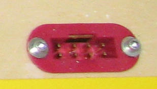

StZ 05-18-2015 05:06 AM
1 Attachment(s)
Bob,
what are these red oval things that are screwed in the fuse?
http://www.rcuniverse.com/forum/atta...mentid=2096730
Oh, and I can see that you are also using the popular 1501 Power Hd servos.
Bob Paris 05-18-2015 01:47 PM
Hay StZ,
These are triple servo connector plugs, that I purchased from "Tail Dragger R/C" and allow you to plug in three servos into the fuselage with one connection. Since I have a twin engine model, with multiple servo connections...I needed to connect six servo connections from each wing half's, into the fuselage to set up the model to fly. By using two-triple servo connectors for each wing, I only had to connect four plugs to connect the wings into the fuselage...not 12 servo connectors. It cleans up the wing and fuselage connections and makes a simple chore to mount the wing. By color coating the four multiple plug connector, you will not miss connect any servo to the receiver and besides being quick and easy...it also looks kind of cool.
http://www.taildraggerrc.com/exclusi...nels-one-plug/
There are now other products out in the modeling world that will allow you to connect up to four servo's into one plug connector.
I use and highly recommend HD1501BBMG servo's. I buy mine from Troy Built Models and the last time I purchased these servo's from them, I got them at less then $13.00 a servo. I've used these servo's for years and I've never had one fail yet. These are powerful with an excess of 230"/#'s of torque with 6 volts. These servo's are the same size as any standard servo, in most cases, are cheaper then most standard servo's from any radio manufacturer and are the best servo deal I can find. They are reliable, standard size, so fit into most all model applications and work. I only use five cell nickel batteries in my models now and all my models fly with HD servo's and nickel batteries.
http://www.troybuiltmodels.com/items/HD-1501MG.html
Bobby of Maui
