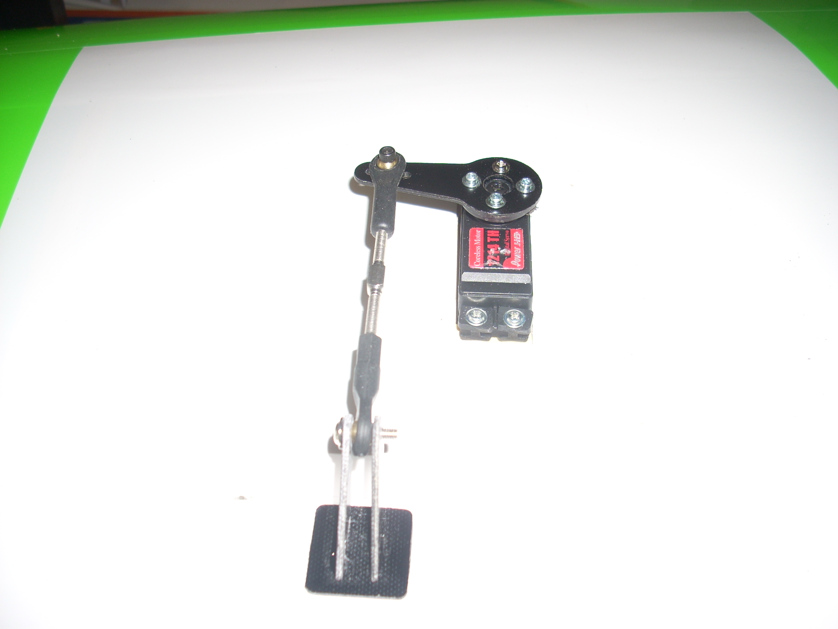

2 Attachment(s)
Got the ailerons & Servo's installed. The rods that came with the kit where to long for the servo's so I had some shorter rods that worked better. I am using Power HD 1214th servo's on this plane. They are coreless with titanium gears. Here are a couple more pics.

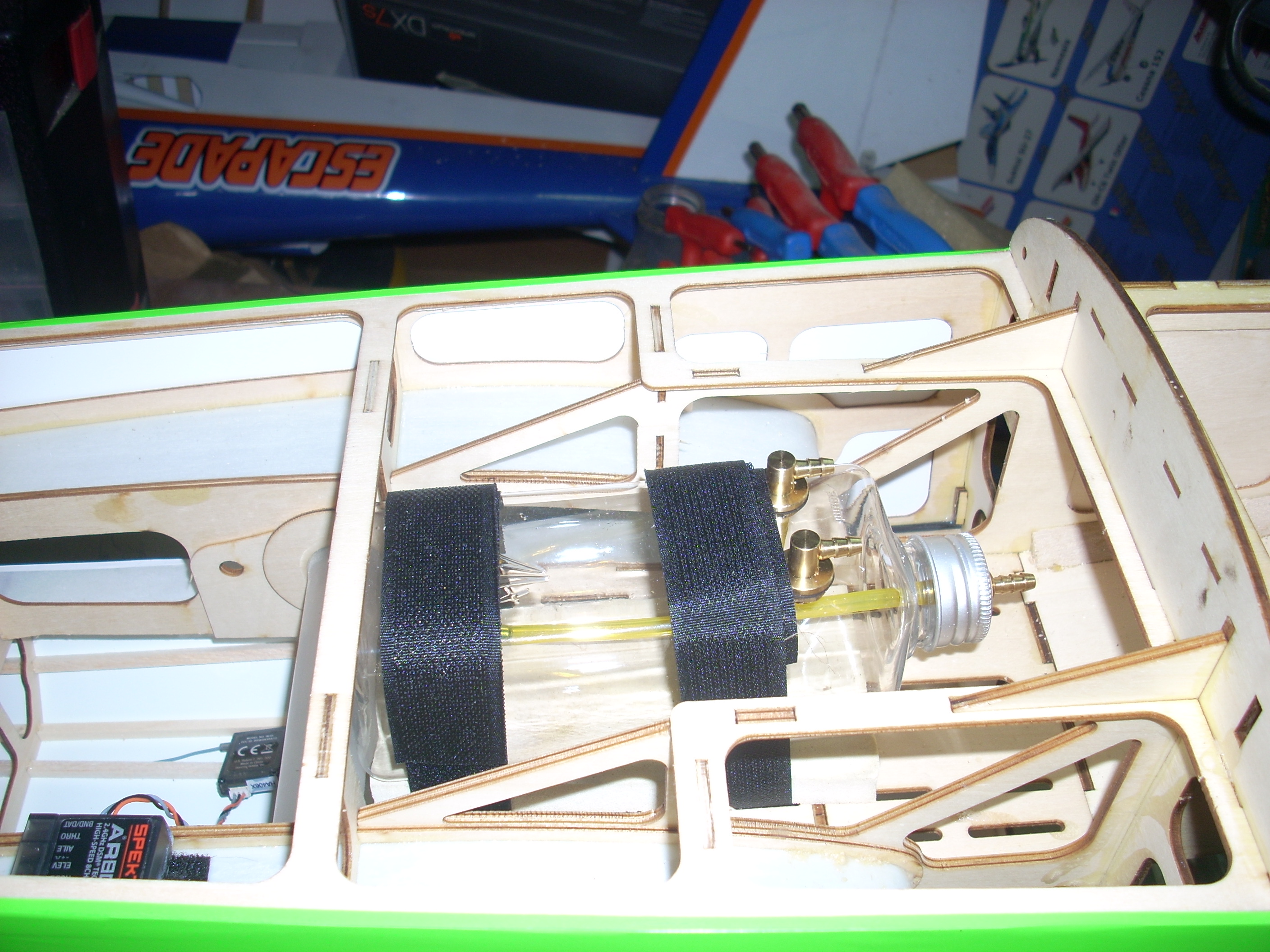

3 Attachment(s)
Got the horizontal stabilizer installed and the fuel tank along with the EME-35. There were no instructions on how far to put the prop hub out from the fire wall so I installed the cowl and measured with a ruler that it needed to be 6 3/4" out. The EME-35 was 6 1/2" so I use the plywood spacers that came with the kit to get the 6 3/4". Here are a few more pics.
