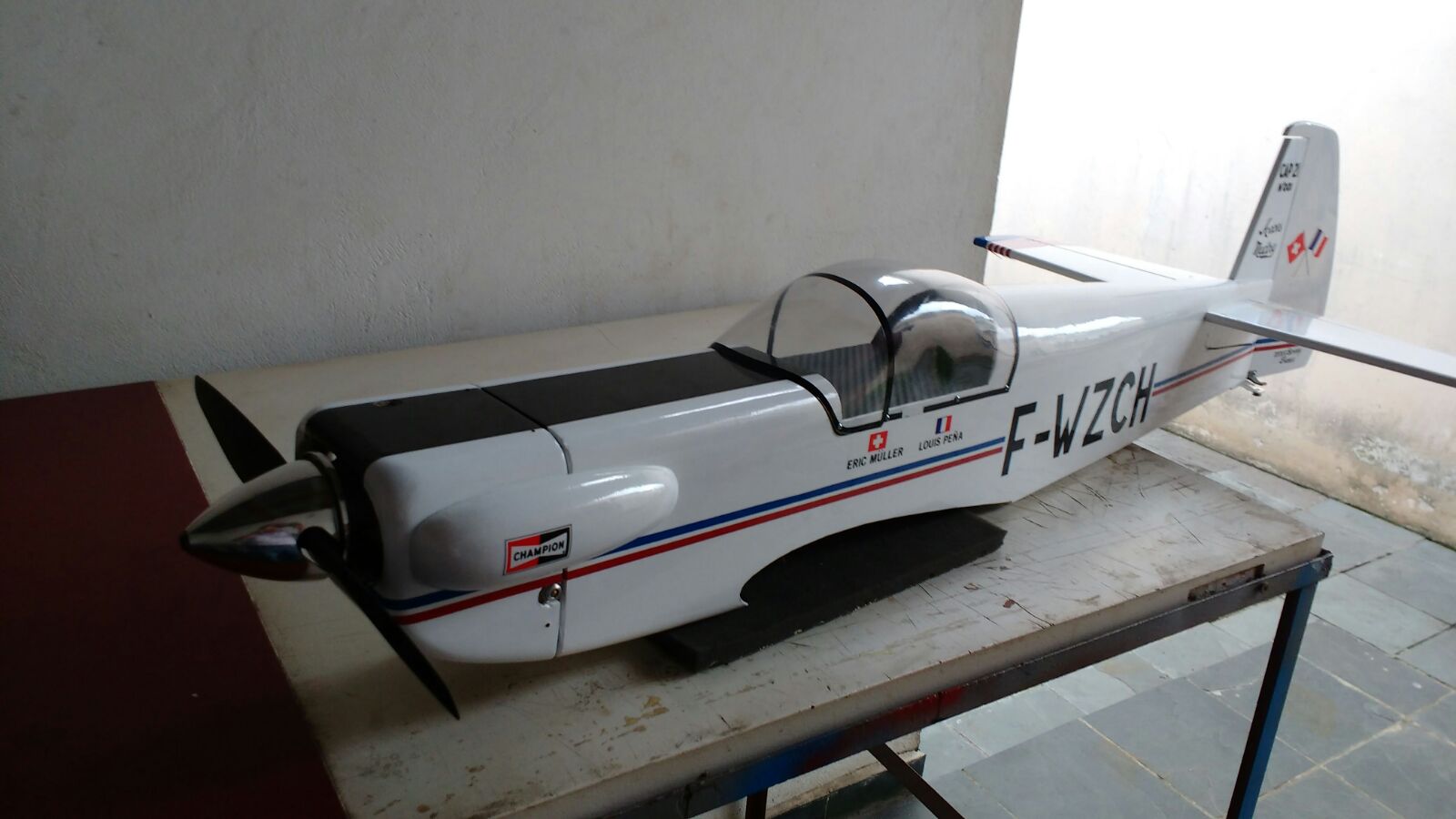

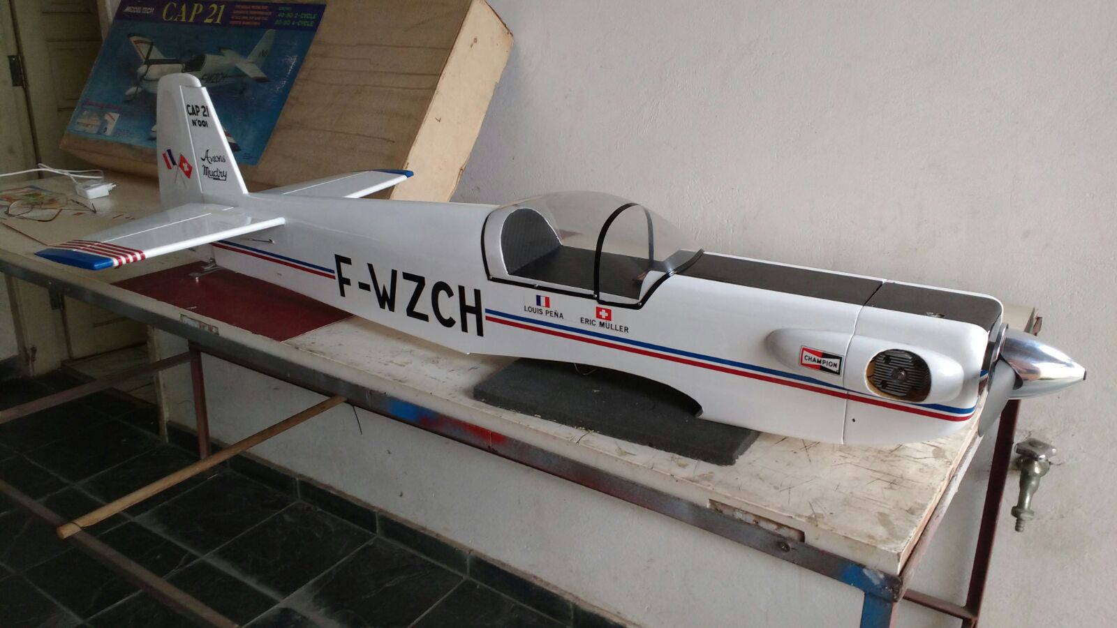

leojzamboni 11-22-2015 03:47 PM
6 Attachment(s)
SheŽll be ready for xmas.http://www.rcuniverse.com/forum/atta...mentid=2131951http://www.rcuniverse.com/forum/atta...mentid=2131952http://www.rcuniverse.com/forum/atta...mentid=2131953http://www.rcuniverse.com/forum/atta...mentid=2131954http://www.rcuniverse.com/forum/atta...mentid=2131955http://www.rcuniverse.com/forum/atta...mentid=2131956
EF 11-22-2015 08:32 PM
Looks very nice indeed !
You might want to consider allowing more exit area for cooling air perhaps ?
I just flew mine last Friday, it is really one of my favorite models.

leojzamboni 12-02-2015 03:15 PM
4 Attachment(s)
Almost ready.
Really afraid of the maiden.
http://www.rcuniverse.com/forum/atta...mentid=2133590http://www.rcuniverse.com/forum/atta...mentid=2133591http://www.rcuniverse.com/forum/atta...mentid=2133592http://www.rcuniverse.com/forum/atta...mentid=2133593
EF 12-02-2015 09:52 PM
Beautiful job !
Looks far far better than mine !
Well done and good luck on the first flight !
leojzamboni 12-04-2015 08:00 AM
Thanks Erez.
But surely mine is heavier than yours....
IŽll keep maximum respect for the plane during the maiden, on December 20th, if wheather helps.
