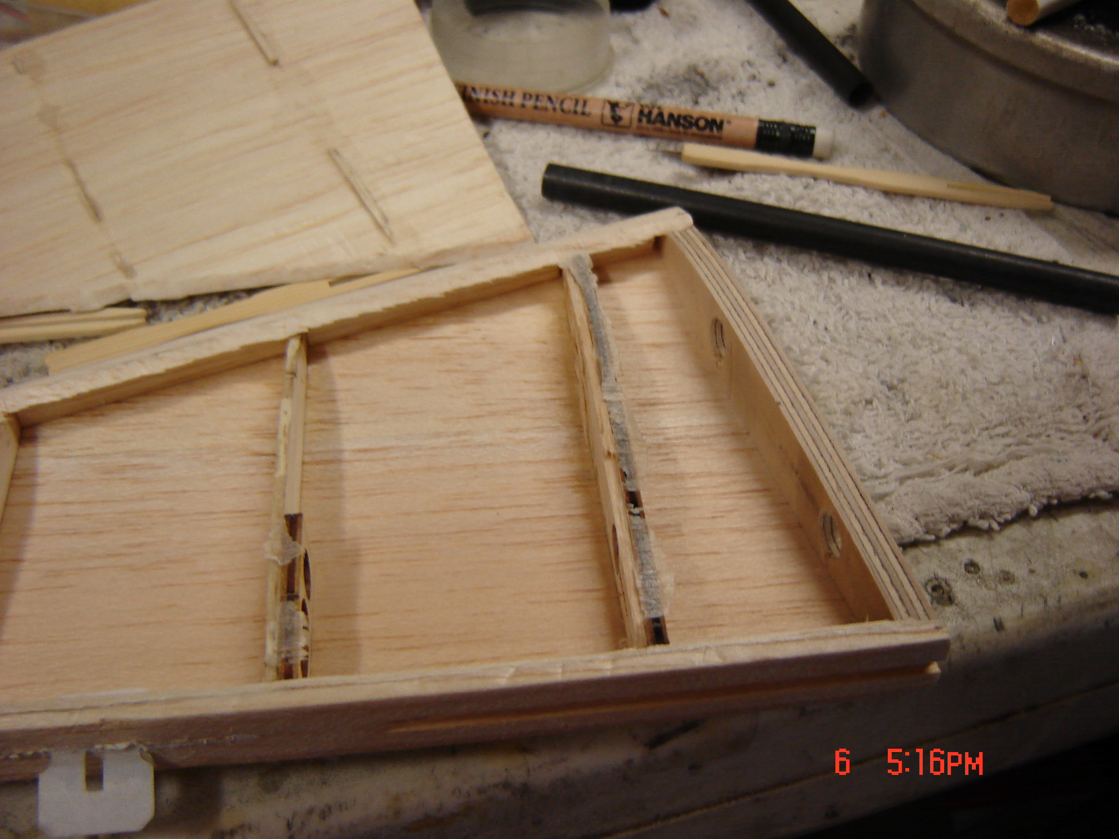

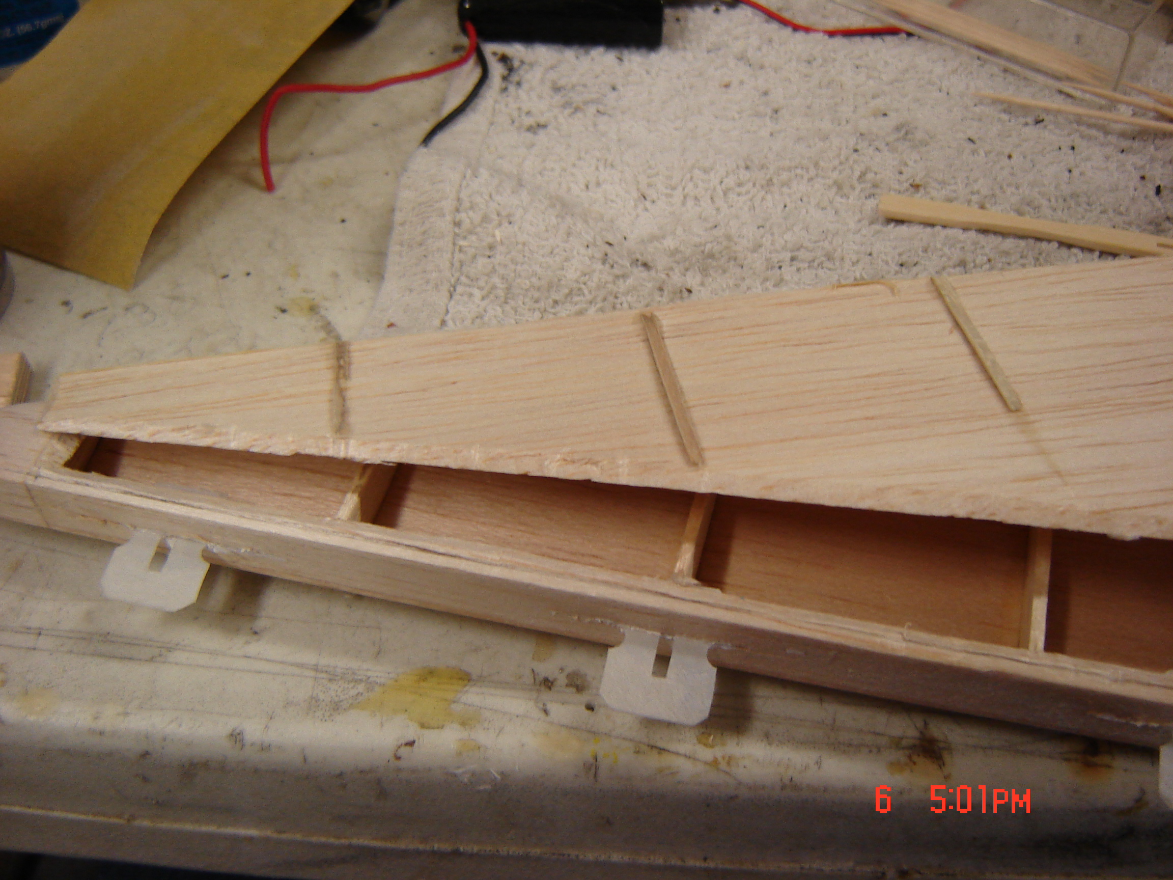

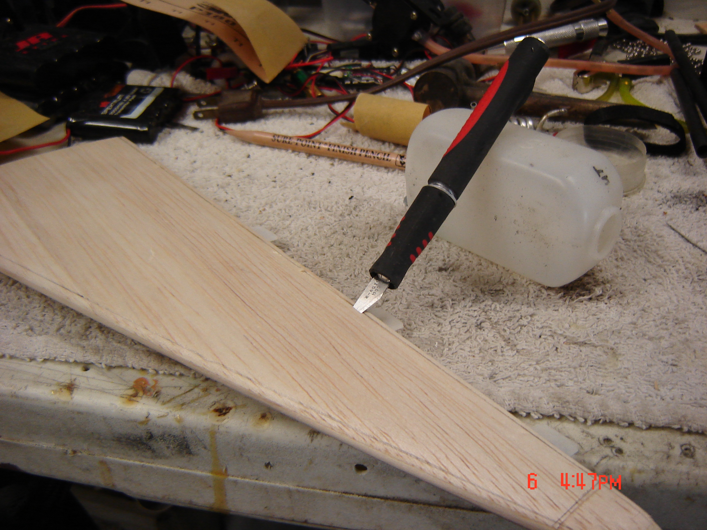

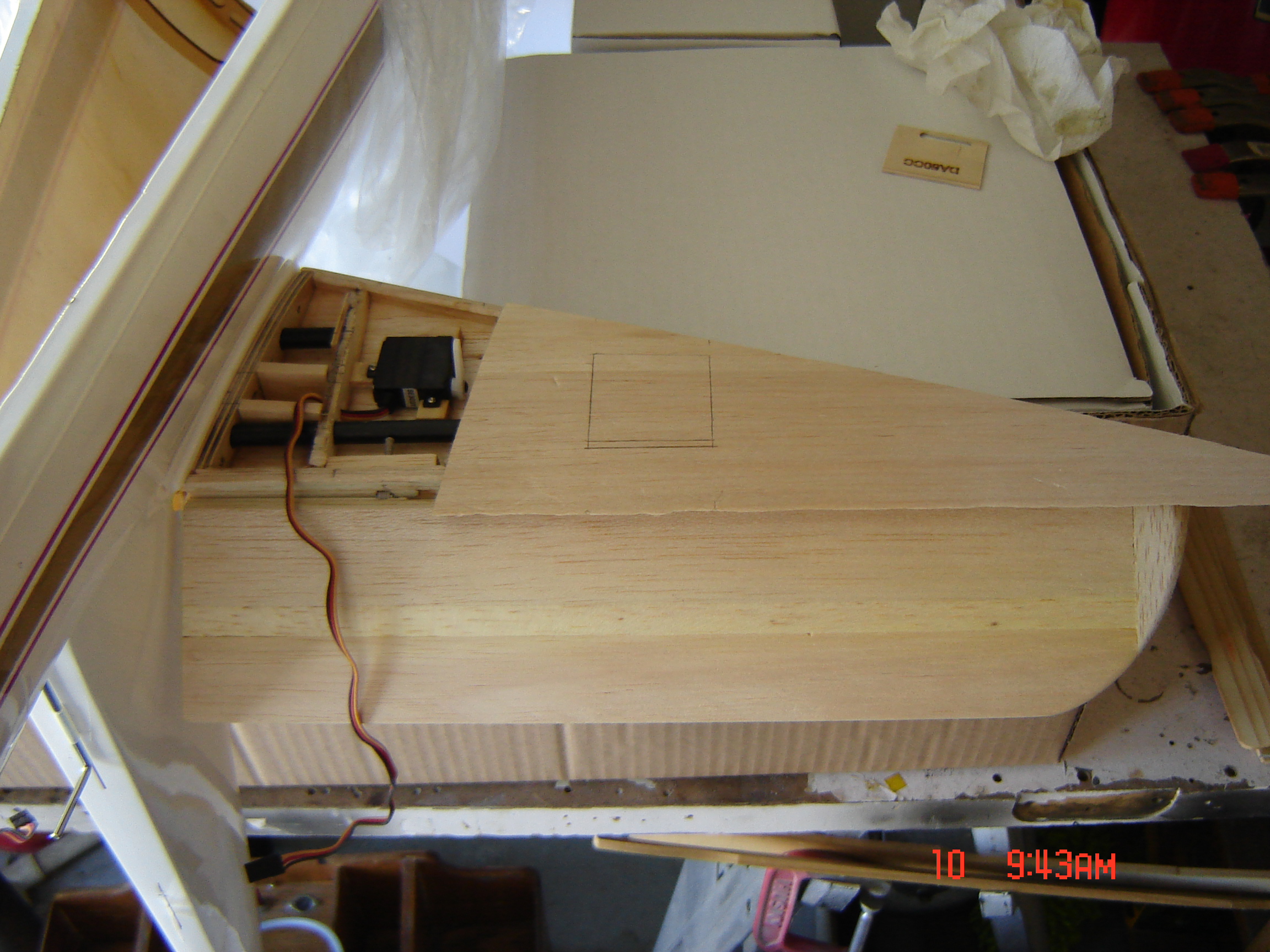

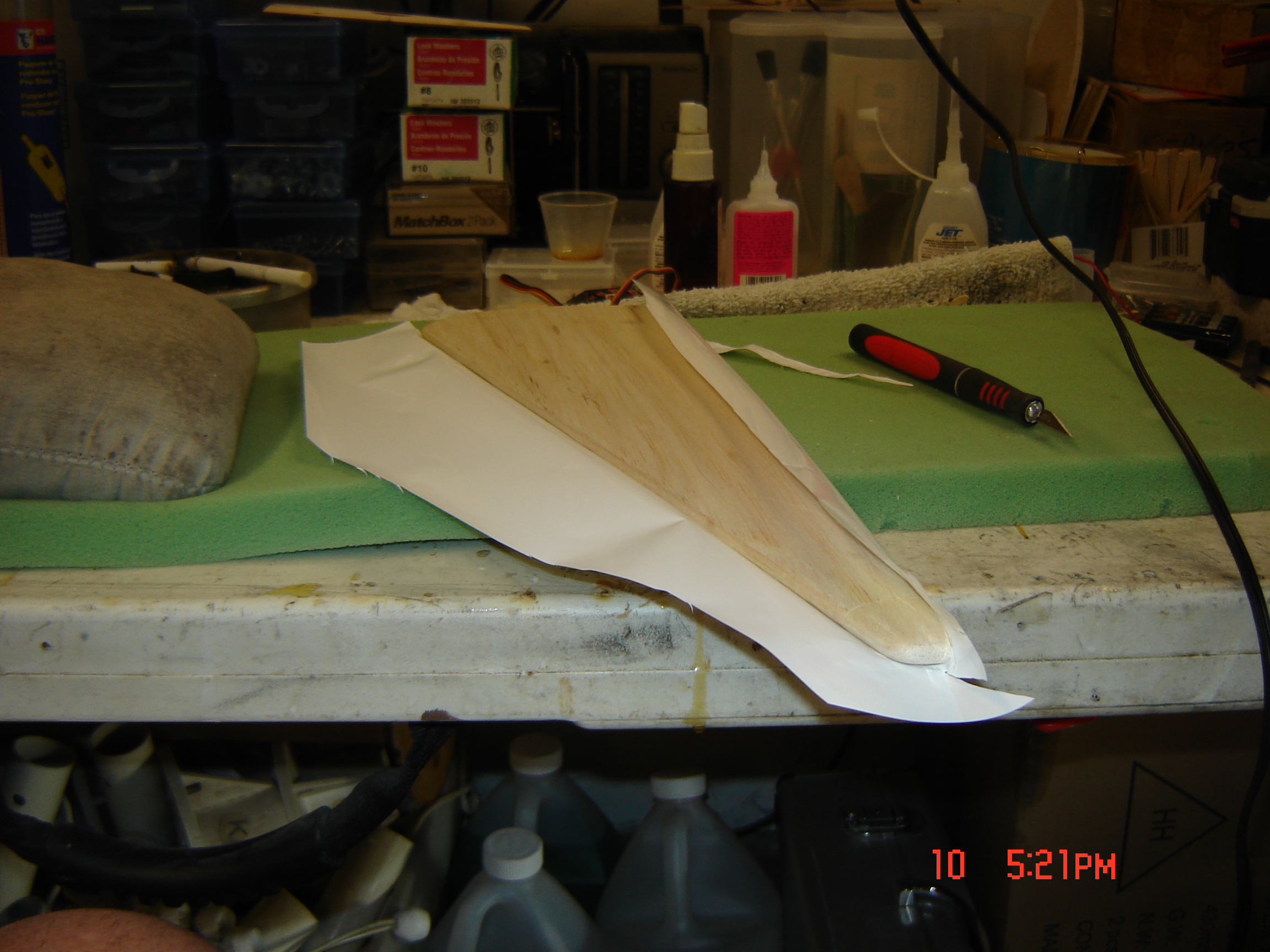

11 Attachment(s)
Well after great thought I have deceided to revise the plane. The mfg. date on my RB was 8/28/03. I would be a ? mark if it had been modified by TT. I stripped the horizontal and opened it up, sure enough I'm glad I did. I cut the bottom sheeting by carefully cutting the balsa @ a 45degree so when I glue it back on I will have a strong diafram for strength, I cut 1/4" behind the LE and 1/4" in front of the TE. The root rib was a peice of junk it was1/16" thick. I replaced it with high quality 5 layer 1/4" ply. I also duplicated the root ribs so as to sandwich them on the inside of the fuse at the stab location. That area has flex movement and needs to be stiffened. It might have contributed to the high speed flutter and stab failure. The CF tubes are 21/32" if you choose to copy my mods to drill the root rib. Like other owners my CF tubes were to long and had I forced them in I would have broken the seat ribs.I reglued all of the ribs as again they were not done correctly. I will be installing the elevator servo's, HI Tech HS125MG. in each stab for optimum function and eliminate the potential for flutter, it's added weight in the tail, I would rather compensate than crash. I will be adding more comments and photo's as I proceed with this build.http://www.rcuniverse.com/forum/atta...mentid=1984880http://www.rcuniverse.com/forum/atta...mentid=1984884http://www.rcuniverse.com/forum/atta...mentid=1984886http://www.rcuniverse.com/forum/atta...mentid=1984888http://www.rcuniverse.com/forum/atta...mentid=1984895http://www.rcuniverse.com/forum/atta...mentid=1984889http://www.rcuniverse.com/forum/atta...mentid=1984891http://www.rcuniverse.com/forum/atta...mentid=1984893http://www.rcuniverse.com/forum/atta...mentid=1984881http://www.rcuniverse.com/forum/atta...mentid=1984882http://www.rcuniverse.com/forum/atta...mentid=1984883
Cougar429 04-07-2014 04:48 AM
Great pics and description, (can tell a fellow card-carrying builder).
A servo in each stab has been posted here before, but with the improvements in linkages and design that may unnecessarily complex now. I placed my servo above the wheel and even that could have been moved forward. As with any copy of a radial warbird, the nose on the 'Bear is short-coupled, to the point they moved the battery above the engine. It's difficult to balance weight added to the tail.
You obviously have the skill and tools. You may want to strip the bottom surface of the wings, as well. You will be shocked at the construction, especially in how they mount the wing tube. If you copy my setup for the gear mounting it will be bulletproof and you can tailor it to fit whatever retracts you decide to run.
It would have been nice to add inner gear doors and really not that hard to form by lamination. Unfortunately I have so many systems stuffed in there a central micro servo and linkage would be difficult or impossible to add at this stage.
Was curious to know if anyone has measured the wing washout of the stock build. When I redid the Bear I built in 2 1/2 deg negative and it's behavior was radically different.

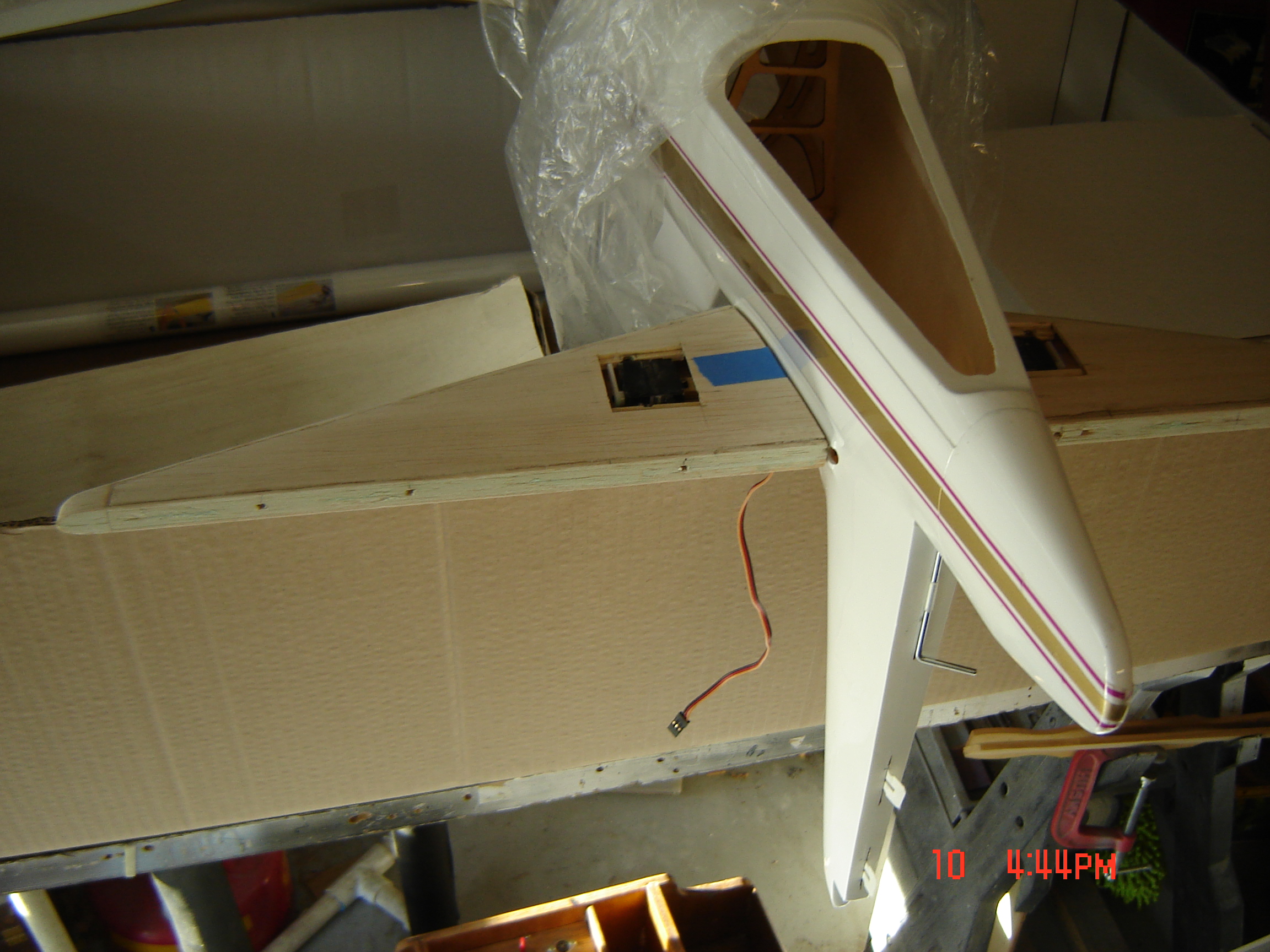

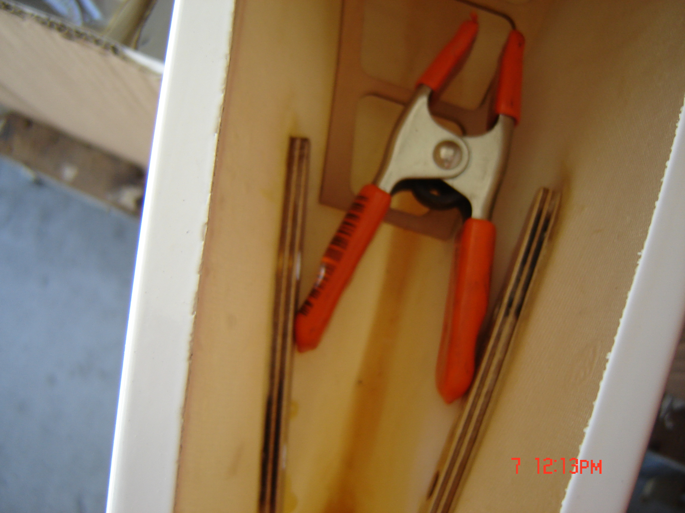

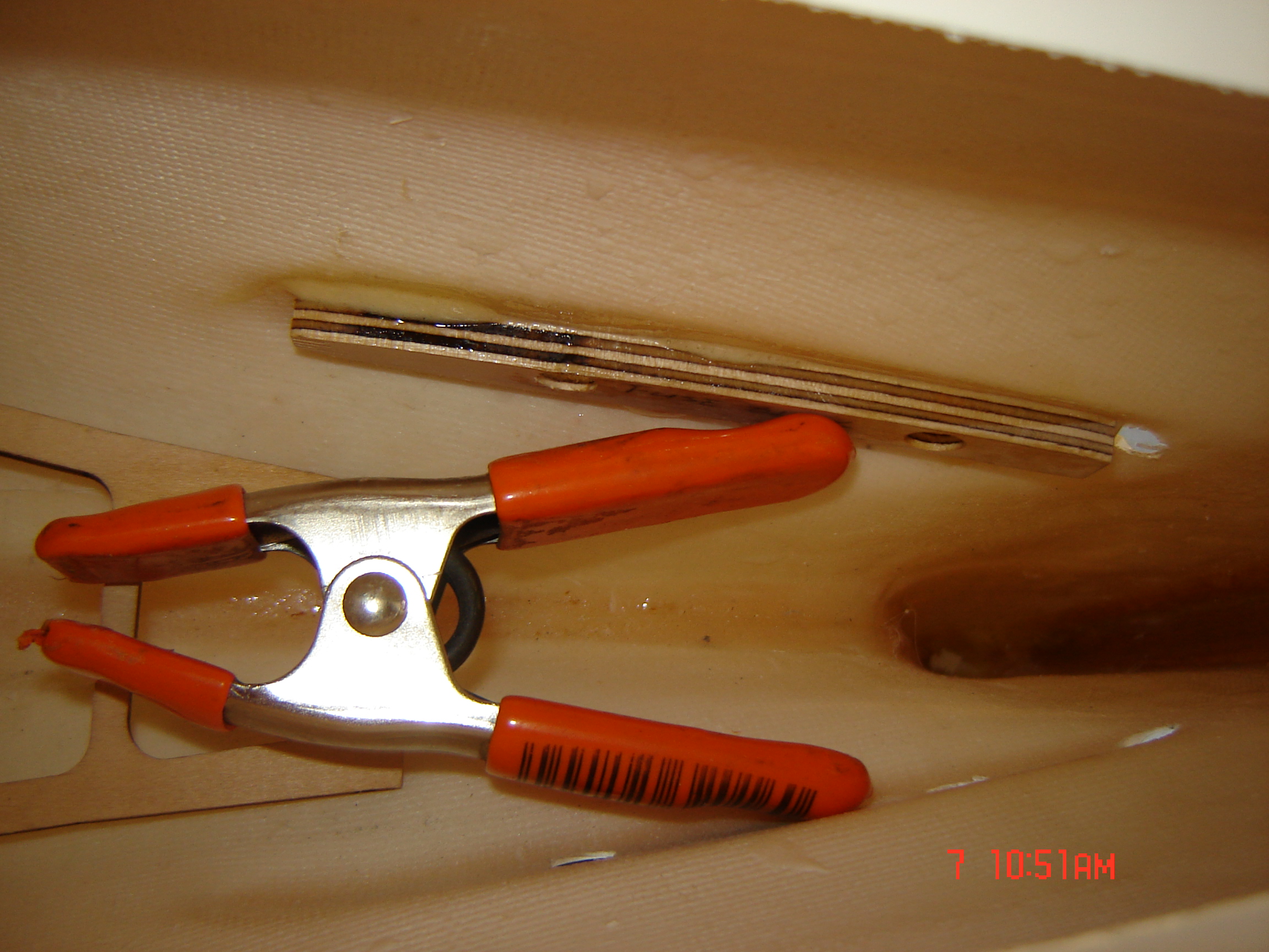

dougwilber 04-10-2014 10:16 PM

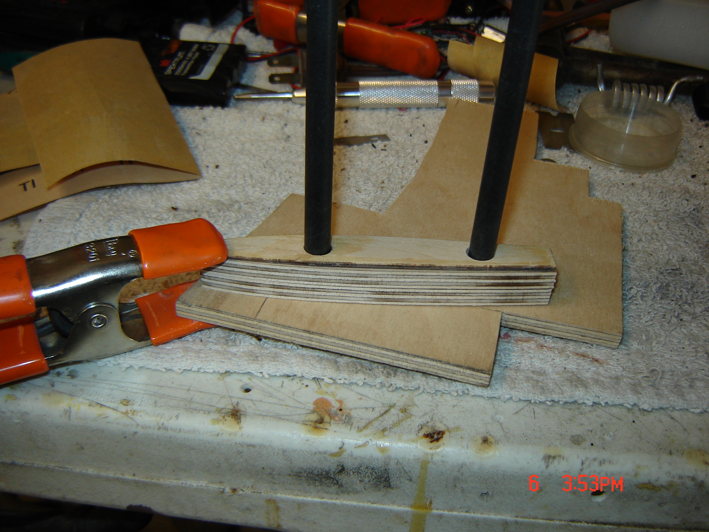

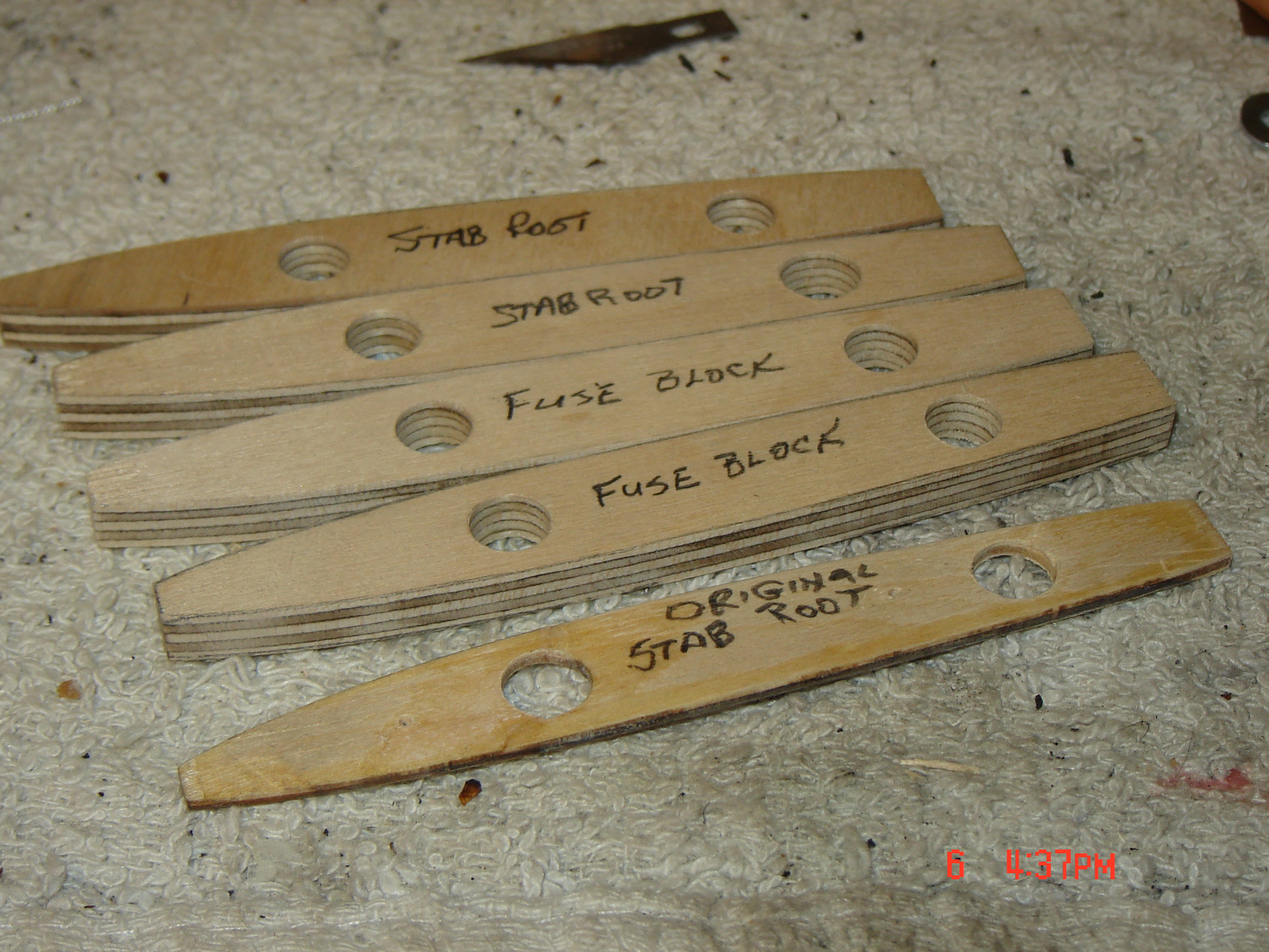

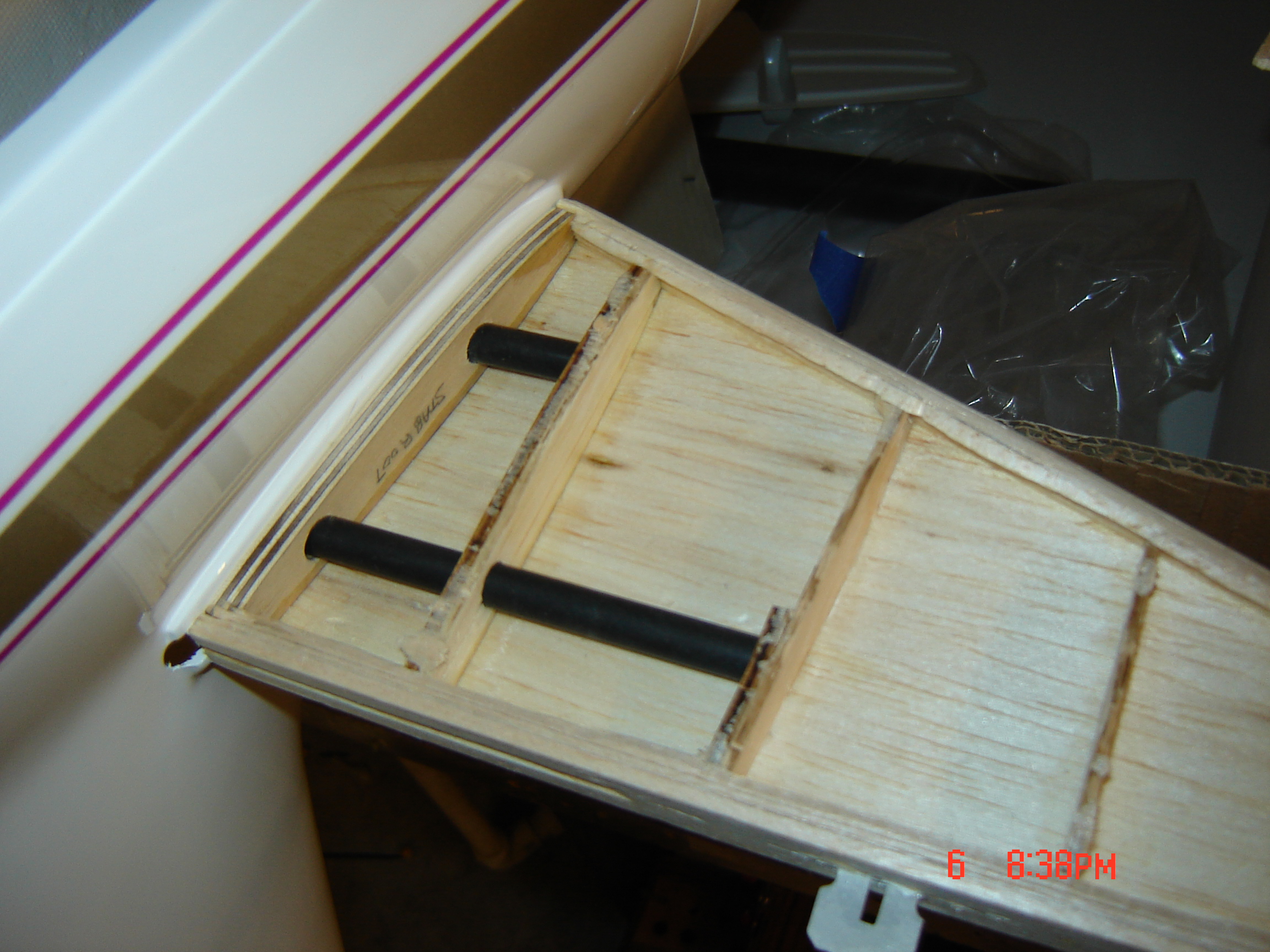

17 Attachment(s)
Well its been a few days and I have made some progress on the Rare Bear. When I left I was in the process of reenforcing the horizontal stab. After making new root ribs and another set for the inside of the fuse. I installed two slimline servos for the elevator, I also discarded the original fiberglass arrow shaft spars and replaced them with carbon fiber spars that will offer more strength. after many trial fittings to the fuse and everything fit I drilled holes in the root ribs and fuse supports to install 440 screws and t-nuts (blind nuts) to securly attach the stabs to the fuse. Every thing looked good and fit well. I made the cutouts for the servos and reInstalled the sheeting using CA and gorilla glue. The existing hingeshttp://www.rcuniverse.com/forum/atta...mentid=1985910http://www.rcuniverse.com/forum/atta...mentid=1985922http://www.rcuniverse.com/forum/atta...mentid=1985923http://www.rcuniverse.com/forum/atta...mentid=1985924http://www.rcuniverse.com/forum/atta...mentid=1985925http://www.rcuniverse.com/forum/atta...mentid=1985926http://www.rcuniverse.com/forum/atta...mentid=1985921http://www.rcuniverse.com/forum/atta...mentid=1985911http://www.rcuniverse.com/forum/atta...mentid=1985912http://www.rcuniverse.com/forum/atta...mentid=1985913http://www.rcuniverse.com/forum/atta...mentid=1985914http://www.rcuniverse.com/forum/atta...mentid=1985915http://www.rcuniverse.com/forum/atta...mentid=1985916http://www.rcuniverse.com/forum/atta...mentid=1985917http://www.rcuniverse.com/forum/atta...mentid=1985918http://www.rcuniverse.com/forum/atta...mentid=1985919http://www.rcuniverse.com/forum/atta...mentid=1985920 were replaced with Robart hinges.Some sanding and more trial fitting I have started to re-cover the stabs. See photos. If anyone has questions feel free to ask.
