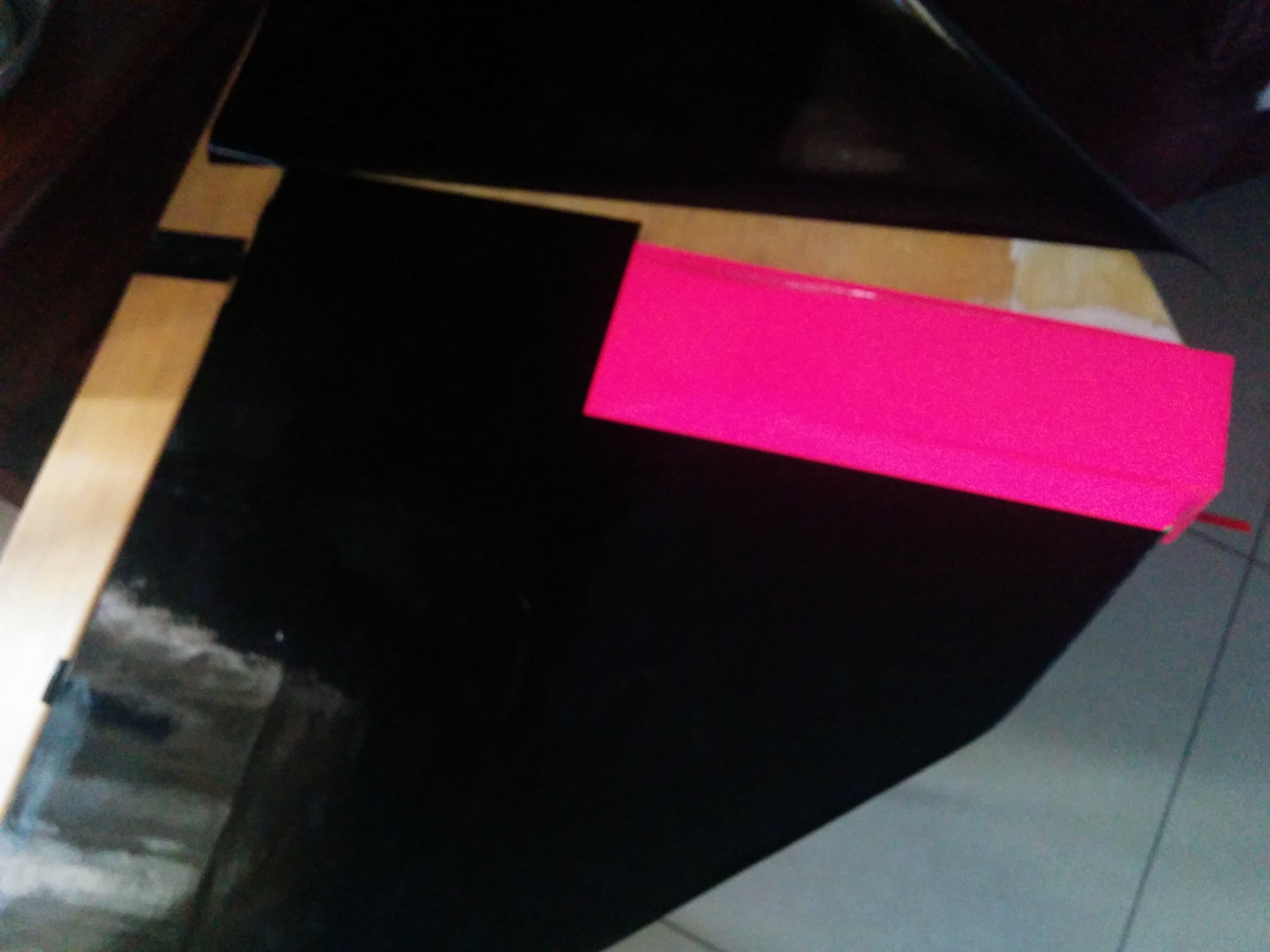

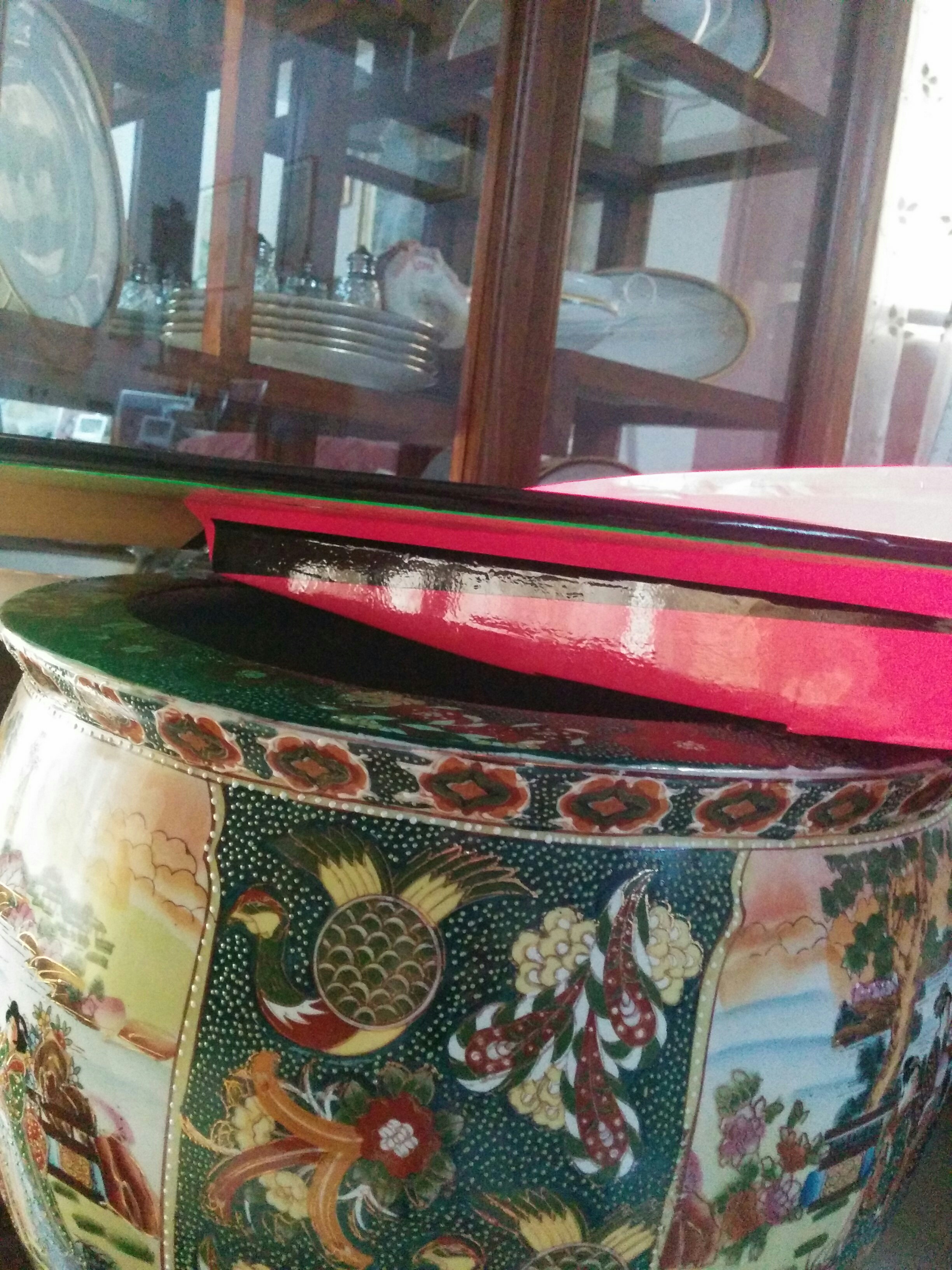

Signofinfinity 08-16-2015 11:42 PM
Was wondering... I haven't yet looked at the RB yet, but, how about drop soaking the rear stabs in diluted white glue, and let it drip out? The 'new improved' stabs should get the needed lacking glue, plus hardens the soft balsa without deforming, apart reaching all the nooks and cranies....
That plus MKS glider servo in the tail... Should work like a champ....
Any thoughts? Drop/ Drip soaking the entire stab?
Cougar429 08-17-2015 03:30 AM
Not sure if white glue would be adequate as I believe it requires clamping of two wood pieces for the best bond. Doubt they are really made for structural gap filling or penetration on their own.
Mind you, I definitely do not have experience with all the different "Wood Glue" products out there. One such is Gorilla Wood Glue, which is a PVA similar to their more popular product I use for hinge installation, (just like CA they require moisture from the air to activate). Also, unlike the white glue of old, once cured that same moisture or wet environment is not supposed to reverse the process, although I have seen some get soft if heavily exposed to water.
I strongly suspect a basic "White Glue" or a contact cement are used, at least in R/B and other ARF products I've had across the table. Not a rigid bond and VERY little penetration of the wood at all. Both are counter to our requirements. Your other problem would come from any existing glue, even if separated, as it would prevent new adhesive from access at the bond line, directly where you need it.
I have heard of a few different ideas, but personally would not try them unless I had some method of contouring the stabs. Mixing standard Gorilla Glue with water will over-activate and make it expand like the spray insulation you get at the hardware or building supply, (also another option that has been tried). It fills the entire internal volume AND bonds the parts together. Unfortunately that expansion will continue unchecked and inflate the stabs like balloons unless there is something to prevent separation.
I would at that point pretty much decide that cutting at least the lower surface away to check and correct any errors would be far less trouble and increase my confidence. When I did mine I opted for FLOX, (Flocked Cotton) mixed with epoxy to fill the gaps as it makes a structural bond.
As mentioned previously, I found Ultra Cote is a perfect match and all I have used for years for its superior contouring and covering characteristics so it was relatively easy to do even the entire wings. Elevators and stabs use exactly the same technique.
Air Sally 08-17-2015 07:12 AM
Signo I have to agree with cougar on this.you could get away with just taking the bottom of the stabs covering off,and cut into the skin at a angle to remove the lower skin inspect and reglue the ribs to the skin.I added some wood at the root and extended the length of the spar one more bay outboard with a plywood rib doubler and replaced the weak stock C/F spar with a real unidirectional C/F spar I bought from CST."the composite store.com".the servo in the tail is a must do also.I also removed 1/4" of the TE of the elev.to reduce the area of the elev.I stripped sanded the TE then recovered them.
Signofinfinity 08-17-2015 07:25 AM
Thanks Cougar and AirSally. Yeh, I will just take the plunge and open her up. Just need to be awfully careful, balsa is practically not available locally. That's the bummer, and ultra Côte white... EBay must help out here!
Signofinfinity 08-17-2015 07:31 AM
2 Attachment(s)
http://www.rcuniverse.com/forum/atta...mentid=2114871
Good thing I am practising covering after some 20odd years away from the hobby !!!http://www.rcuniverse.com/forum/atta...mentid=2114872
