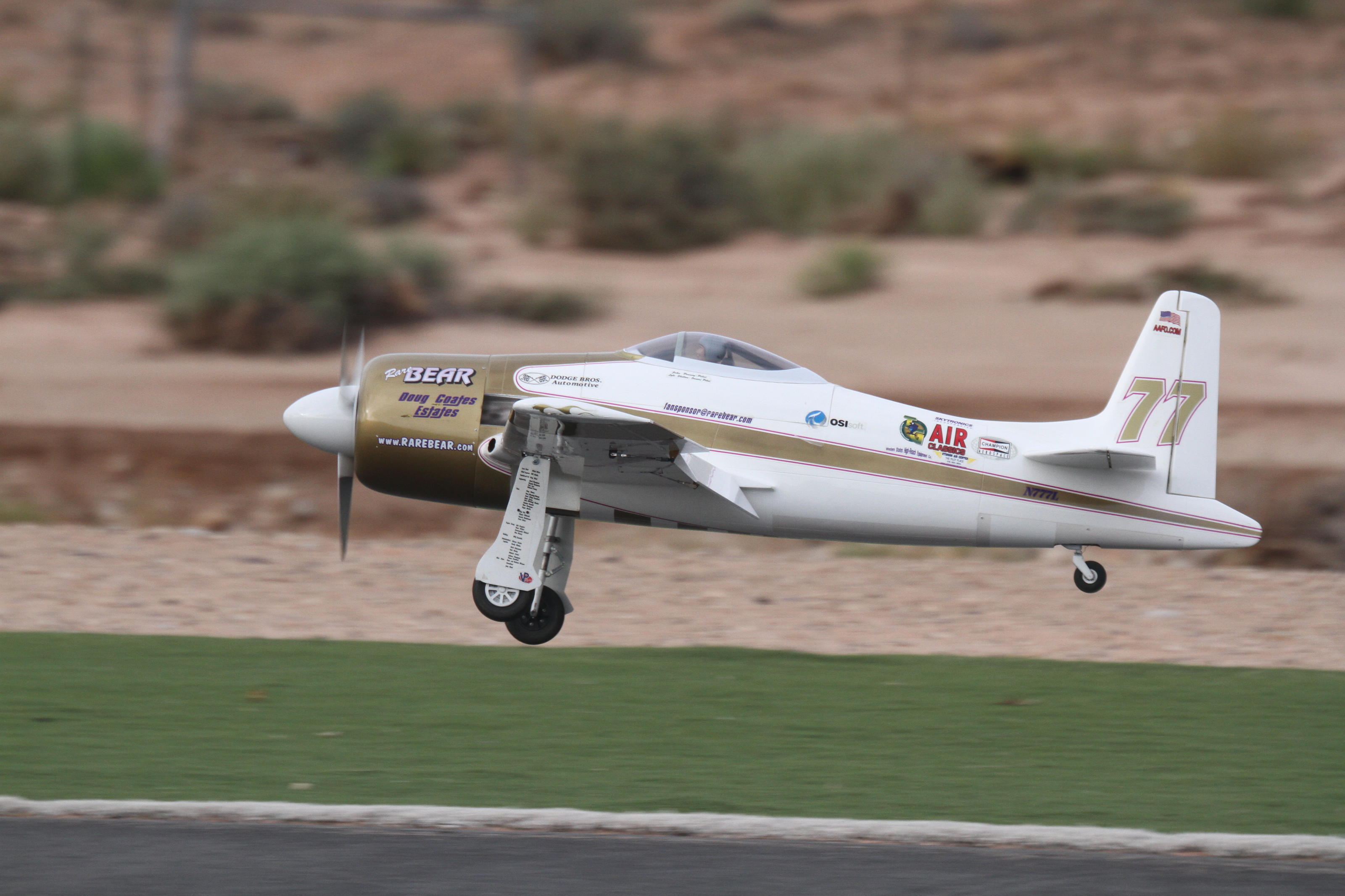

got 3 or 4 flights on mine at a electric meet in St George Utah ,flew great and got some nice pic of it flying . there in the elec event thread over in RCgroups

4 Attachment(s)
http://www.rcuniverse.com/forum/atta...mentid=2187530http://www.rcuniverse.com/forum/atta...mentid=2187531http://www.rcuniverse.com/forum/atta...mentid=2187532http://www.rcuniverse.com/forum/atta...mentid=2187533trying to post some pics
Cougar429 10-25-2016 04:28 PM
Nice. Makes me wish for asphalt.
