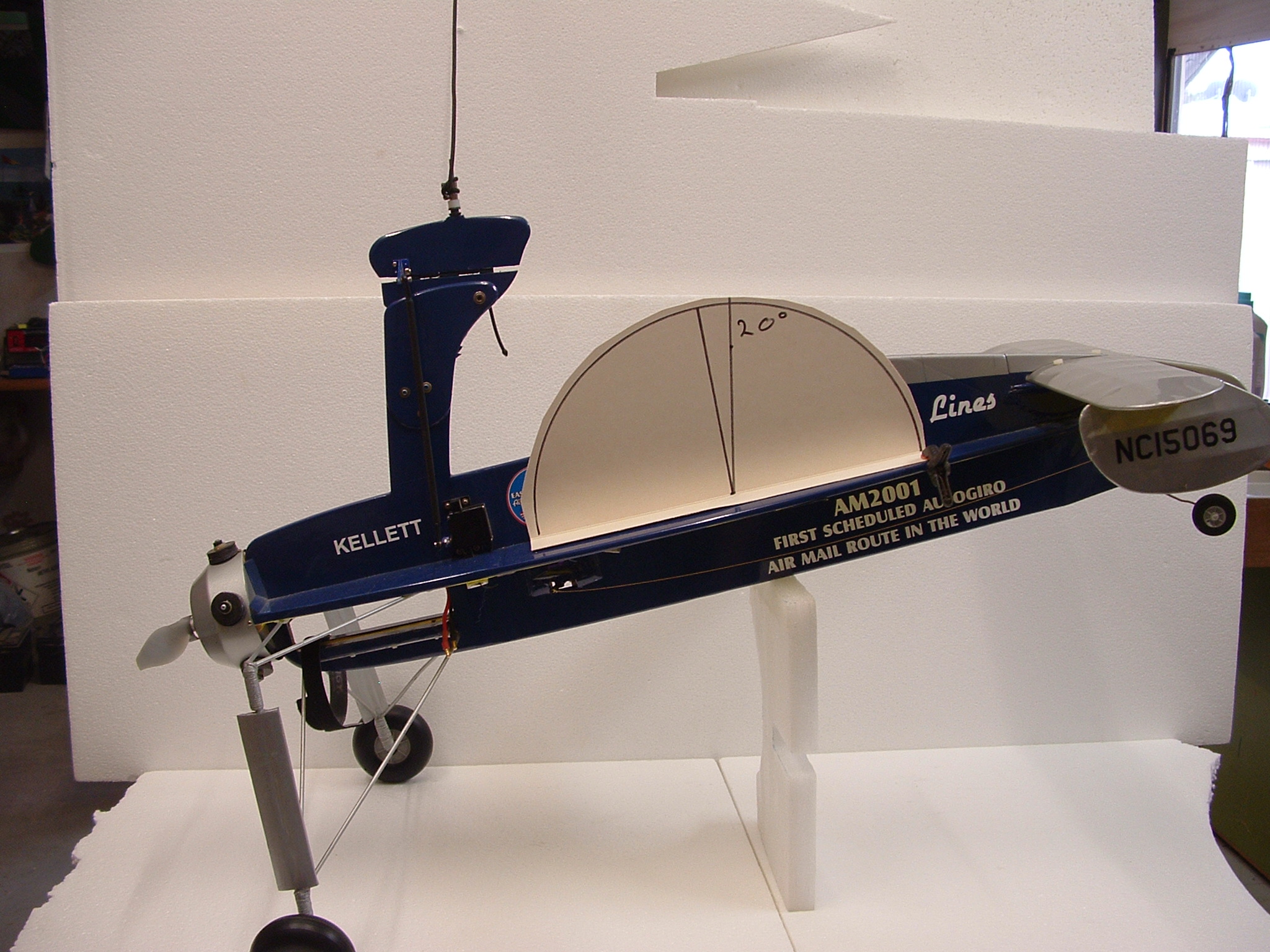

New to gyrocopters I have a DAG 60 not real sure about the CG. Plans talk about between 14 and 18 degrees what does that mean??? Thanks Ron :rolleyes::rolleyes::cool:
imsofaman 02-13-2016 07:40 PM
1 Attachment(s)
There is no CG per say. We go by hang angle.....Hang the aircraft by the rotor axle....it should have a nose down attitude. If you follow center line of the aircraft, that line is your horizon. Once you hang the aircraft by the rotor axle.....your horizon line changes as the nose tips down. compare the center line to a leveled line behind it....that is your hang angle.
