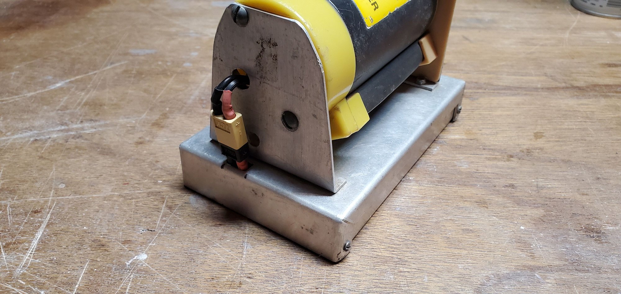

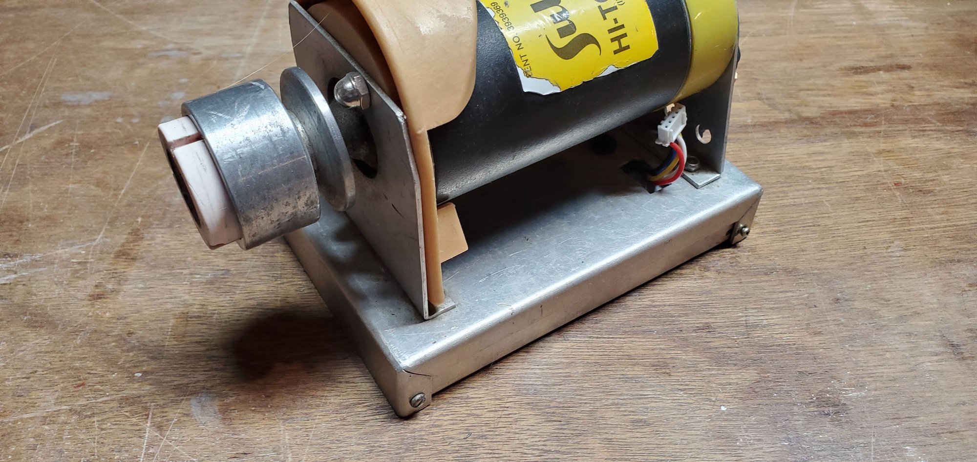

here's what I did with mine -
The metal box I made, along with the supports, many many years ago - back when you could buy 6 cell Sub-C NiCd packs for electric RC cars cheap. It was designed to hold two of those packs wired in series for 14.4 volts.
Now, it's got 2, 2S Lipo batteries, I think they were 2700 mah, wired in series, with a 4-s balance plug put on them. I charge through the balance plug with my Cellpro Multi-4 charger, it's designed to charge through the balance plug.
Don't have to charge it all that often, really. Starts .40 sized pylon race motors with ease, that's what it gets used for.

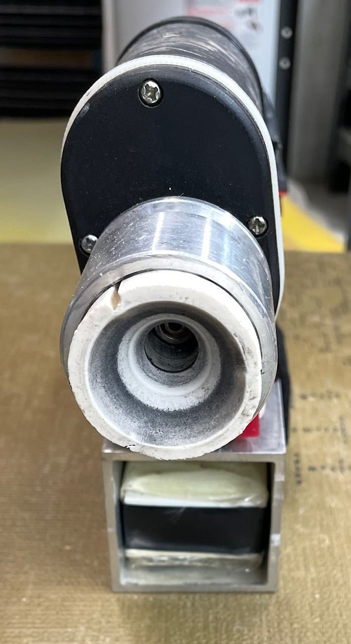

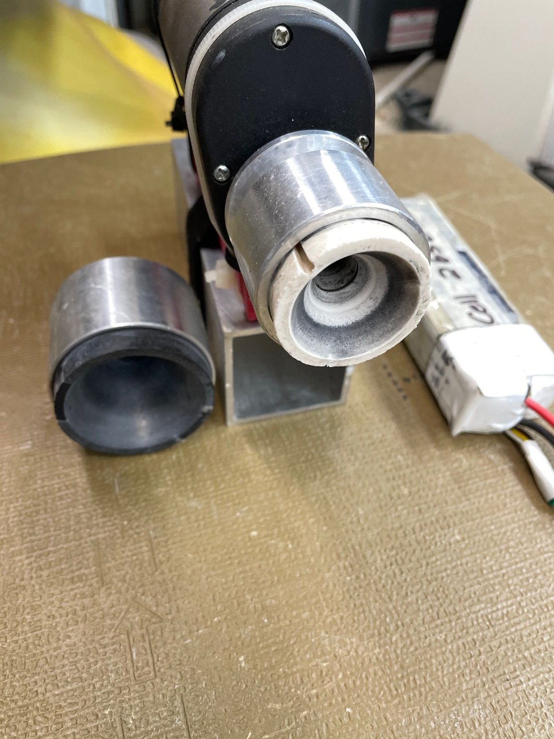

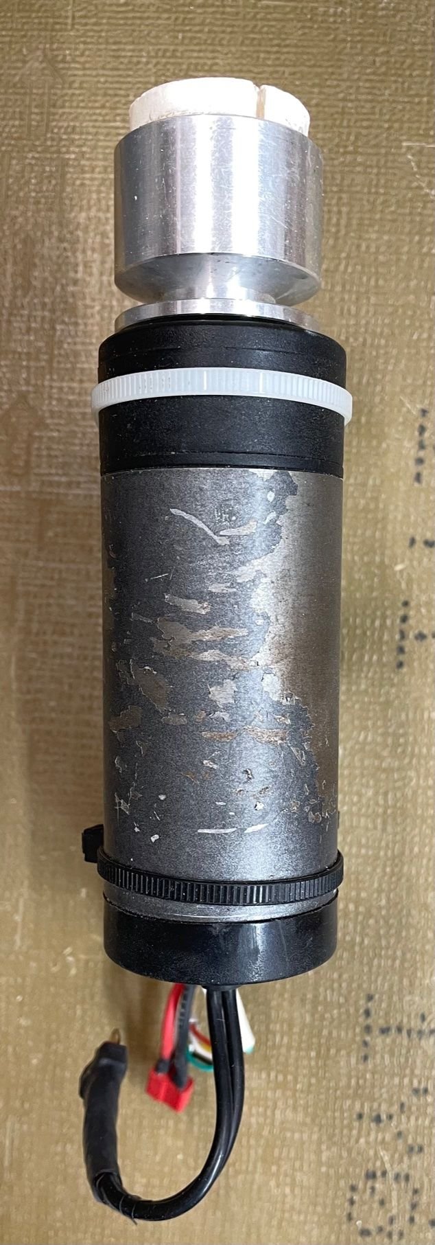

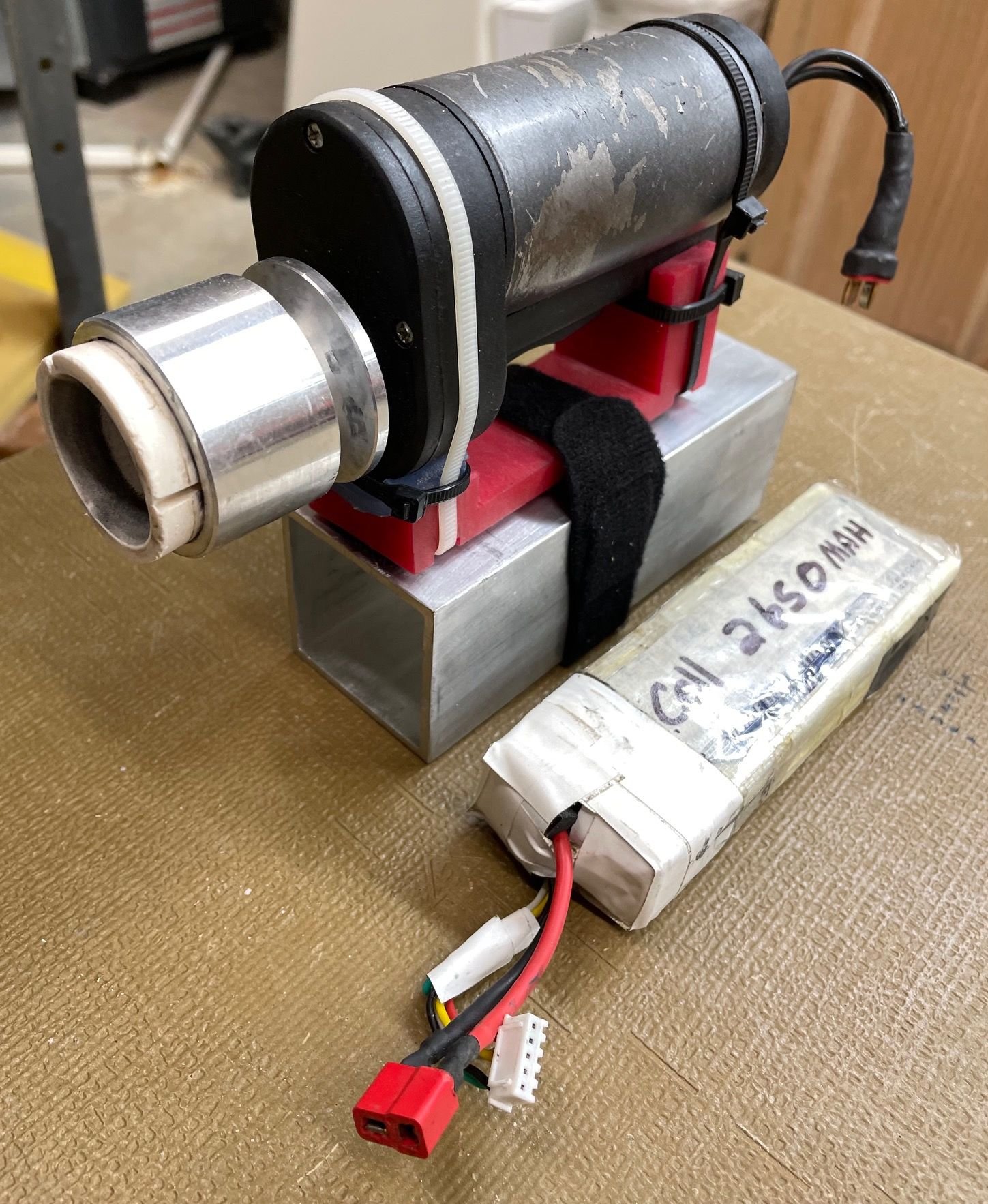

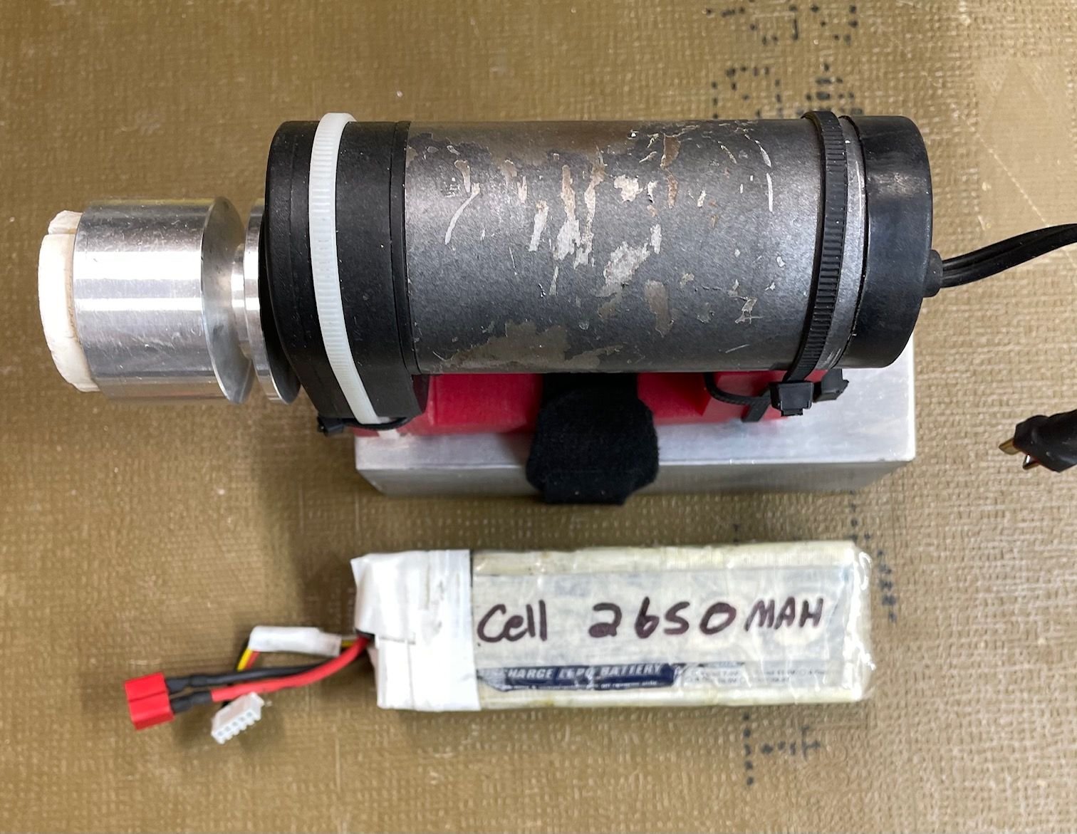

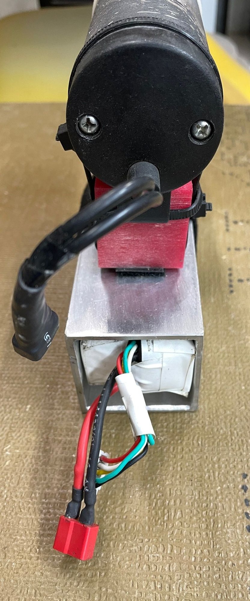

Tim, you probably have already built you starter however I thought I would share mine anyway in case it can help you. I use a gear reduction starter and a 4 cell 2600 battery mounted on a piece of square tubing. A smaller 4 cell will also work or even a 3 cell would work. The adapter plate (red plastic) I machined to fit the starter and Velcro all in place for easy removal and maintenance. I also have a larger adapter for large spinners however I have never had to use it. This setup will start a 50cc gas and a Saito FA 220 engine. For small engines a 3 cell battery would work best. With the 4 cell installed it will spin the prop off on smaller engines.
I used this to mainly start my YS engines. Its nothing fancy but it works great and its about 15-20 years old now.
Jeff
