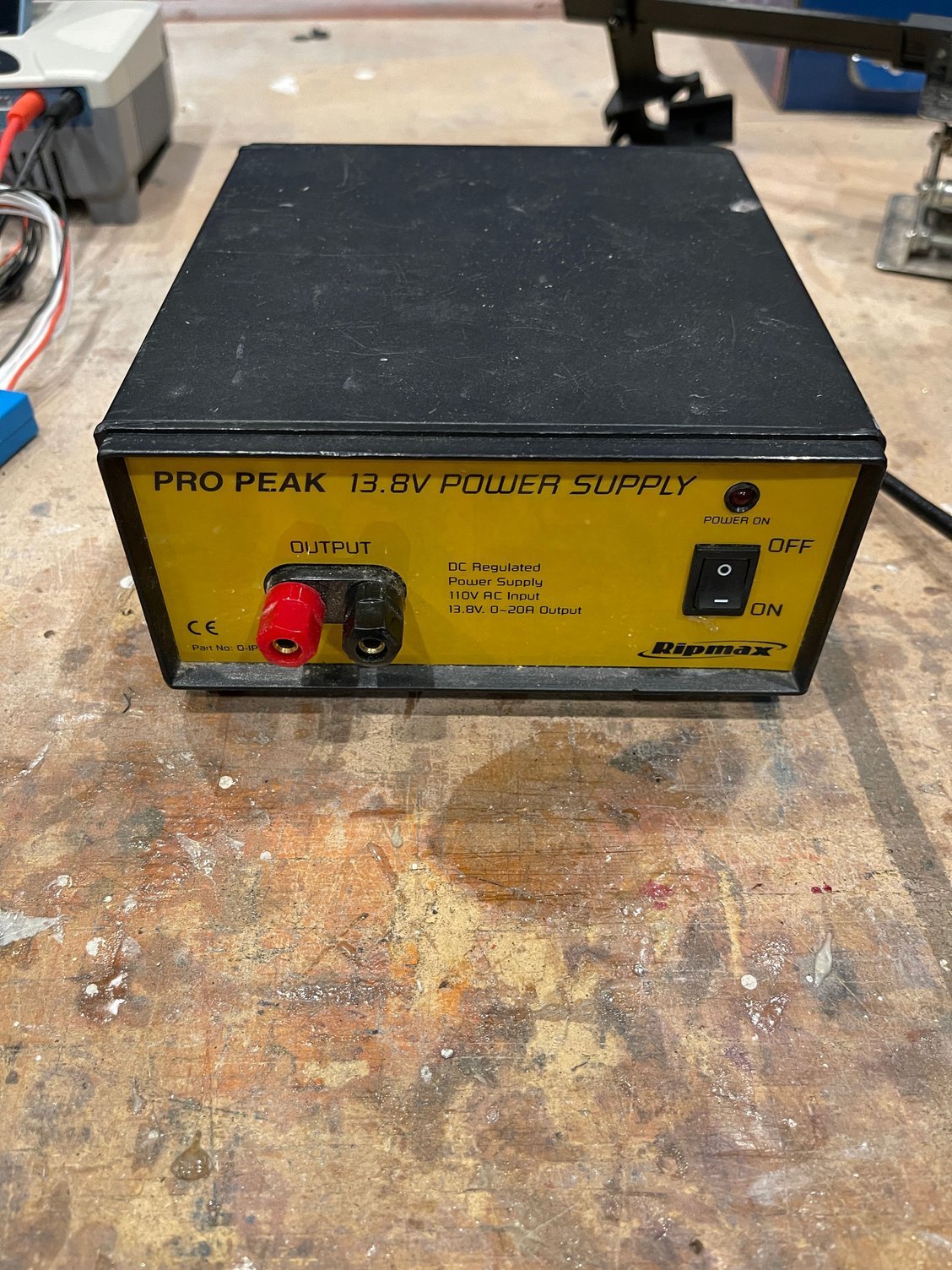

Question here
lets say I have 5s LIPO batteries, 5000 MAH
and I have 8 of them.
If I charge only one pack at 5C, the charger can charge it at 45 minutes from 30% to 100%
lets say, my power supply is 12 volts and it states 20 amps
what if???
i put 4 packs to charge at same time, 5s batteries, each one is 5000 mah
will my power supply be able to charge all 4 packs at 5C with the rating of 20 Amps?
and, how long will it take?
What if, I have 8 packs I want to charge at same time
but this time, the power supply is 24 volts at 60 Amps?

None of your 3 examples will work.
A 12v supply couldn't raise the voltage high enough to charge a 5 cell battery.
A 12v 20a supply wouldn't have the voltage or current capacity to charge 4 5cell batteries at one time.
A 24v 60a supply wouldn't have the current capacity to charge 8 batteries at one time. And 24v would be marginal.

The charger must have a DC - DC converter to step up the voltage for the higher voltage packs. From there it is just a matter of how much total wattage your charger can handle and how much wattage your power supply can supply. I haven't done the mate to comment further.

By charging at a 5c rating your overloading the power supply. You could try charging at a 1c rate. You might find that at 1c it will change faster.

I hope you read all of this.
Assuming the the bench-top power supply is providing 13.8v @ 20A, it is rated at 276W (watt) maximum.
Using "Watts" allows you to compare apples to apples between the power supply and the load (the "load" is the Changer and the batteries).
Any modern changer (Junsi, Powerlabs - etc) use a Constant Current (CC) charge mode for the first part of the change and then switches to Constant Voltage (CV) for the last part.
This allows the charger to provide the programmed current until one or more of the cells in the pack reaches the maximum voltage (typically 4.2v) and then it switches to CV mode until all the cells reach the same maximum voltage (4.2v) as measured and controlled by the balancer circuits and the voltage measured at the main discharge lead.
During CV mode, you will see the current dropping as the cells in the pack start to reach the programmed max voltage and the pack's total voltage (21v for 5S1P) is approached.
Assuming you are charging one (not five) 5S1P 5000mAh pack at "5C", the charger would be trying to put out 25A starting at around 19V (CC mode) and ramping up over time until it changes to CV mode (when 1 cell reached 4.2v). Then it starts dropping the charge current.
With 5C on a 5000mA pack, that's 475 Watts at the start and then ramping up to around 525W when it shifts to CV mode.
That is not possible with only a 276W power supply as the input to the Powerlabs 8 charger.
The best rate you could charge one 5S1P 5000mAh LiPo is about 2C with that power supply (about 12A charge rate (2C) at 21v)
So, you are not really charging a 5S 5000mAh LiPo at "5C". You think you are, but you are not.
Even you said it yourself: "If I charge only one pack at 5C, the charger can charge it at 45 minutes from 30% to 100%".
Assuming you start at 30%, the 5000mAh pack was discharged to 1,500mA remaining (70% of 5000mA). To go from 1,500mA to 5000mA, you have to add 3,500mA.
Charging one 5S1P 5000mA LiPo at a true rate of 5C (25A (aka: 25,000mA)) would take about 8.4 minutes (3,500 / 25,000 x 60 = 8.4 min).
Assuming your actual true charge rate is closer to 2C (10A) - the maximum the power supply can provide - then it would take you around 21 minutes to put back 3,500mA into the pack (3,500 / 10,000 x 60 = 21 min)
But, it is taking 45 minutes to recharge the 5S1P 5000mAh LiPo from 30% (1,500mA remaining) to 100% (5,000mA). That implies it is really charging at around 1C (3,500 / 5,000 x 60 = 42 min)

SO i now have this power supply and this charger:
Sounds to me like I can only charge one pack at a time, in order to get it to charge quickly.

The iCharger 4010 Duo is rated at 2000W - slightly higher capacity than my iCharger 308 Duo (1300W).
There is no way for me to tell (from the picture) what that power supply is rated at.
But, if that power supply is using a 120v AC 3-prong plug, it most likely is rated at less than 1800W - how much less, I can't say. Regardless, you won't get the full capacity of the 4010 Duo.
To get a 2000W AC / DC power supply, it will need to be able to plug into a 220V outlet (like your clothes dryer or stove's plug)
The PowerLab 8 is as good as the iChanger 4010 Duo and better than iChanger 308 Duo and should be up to the task for anything you want as long as it has a power supply to match.
But, as I said, trying to charge any hobby-grade LiPo pack at 5C is a bad idea.
Assuming you were thinking of trying to charge one pack at a time at 5C, it would still take about 9 minutes per battery (assuming one or two of the batteries didn't burst into flames).
Or.... you could it a safer and well supported way.
If that power supply connected to the iCharger 4010 Duo is up to the task (1800W or better), you can charge four 5S1P 5000mAh LiPo at the same time.
Hook 2 packs up in parallel (using Y-cable balancer leads and Y-cable main leads) on each channel at the same time.
With the 2 packs connected to the Y-cables balancer balancer and main leads, it is effectively 5S2P and you would charge them like a 5S1P 10,000mAh pack.
Charge each channel at 2C to 3C based on the 5000mAh capacity (effectively 1C to 1.5C for a 10,000mAh pack) and it would take about 40 minutes per channel.
Using this configuration, the effective throughput is still around 10 minutes per pack and you'd have four 5S1P LiPo fully charged in about 40 minutes with a much lower risk of catastrophic failures.
