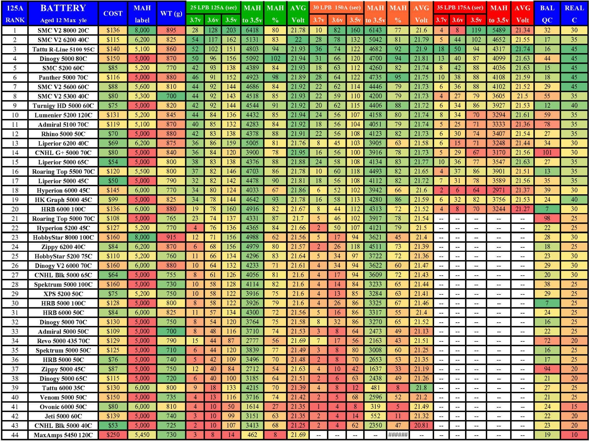

It has been my observation/experience in this hobby to include customer/user feedback when products claim to be the best thing since Orville and Wilbur sustained what we all enjoy.
Consulting those who currently utilize any hobby, aka "TOY" item, will tend to prepare one with a proper level of expectation, after meaning out feedback. If one does not do so they either smile or frown...deserving everything they experience and watch their bank account grow or shrink. In this "challenged" manufacturer/marketer Covid period the normal claims to fame are worse as inventories fail to shrink at an anticipated or historical pace.
I appreciate all the unbiased feedback and accompanying analysis reporting from this and the three primary web sites I rely on... This has been most helpful since the second week of this web site's birth...many years ago.
Battery Data
