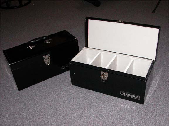

The safety device used by George Maiorana to change KOK 1500 4S3P and 4P packs is shown in the Ap Note. $15 spent on such a charge center is the cheapest insurance in the world. The white lining is sheet rock. I tested sheet rock by directing a propane torch flame against one side while I touched the backside with no harm. George has been handling several packs of KOK 4S4P cells with the LIPO 402 charger and his charge box for several months with no problem. Testing to date at FMA Dorect of the Kokam Safety Guard indicate that it could prevent such a charger failure from resulting in a battery fire. Very soon now, we will post a full report on Safety Guard as part of the subject Ap Note showing the various ways it can be used. A shipment of Safety Guards is being readied at this time.

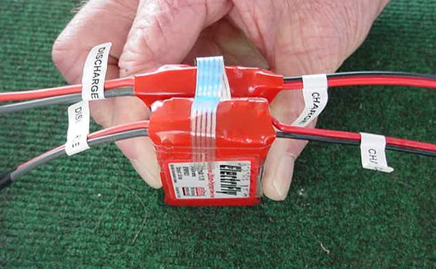

One of our club members had an unfortunate experience with a brand new
ElectriFly 1250 LiPo pack purchased through a local hobby shop. He charged
it through the charge connector and all was well. Then he put it in his
plane, a small 4 motored B-17 from a Gillow kit . . . smoke city! 4 motors
came on full force in reverse, 20 Amp speed controller toast.
The discharged connectors were wired in reverse at the pack terminals. Deans
Ultra that came on pack OK, red to --, black to | so he didn't suspect
anything.
Note the difference in the wires on a good pack (foreground) vs. the reversed wired pack.
Probably an isolated instance but check those new packs with your voltmeter
as soon as you get them.
