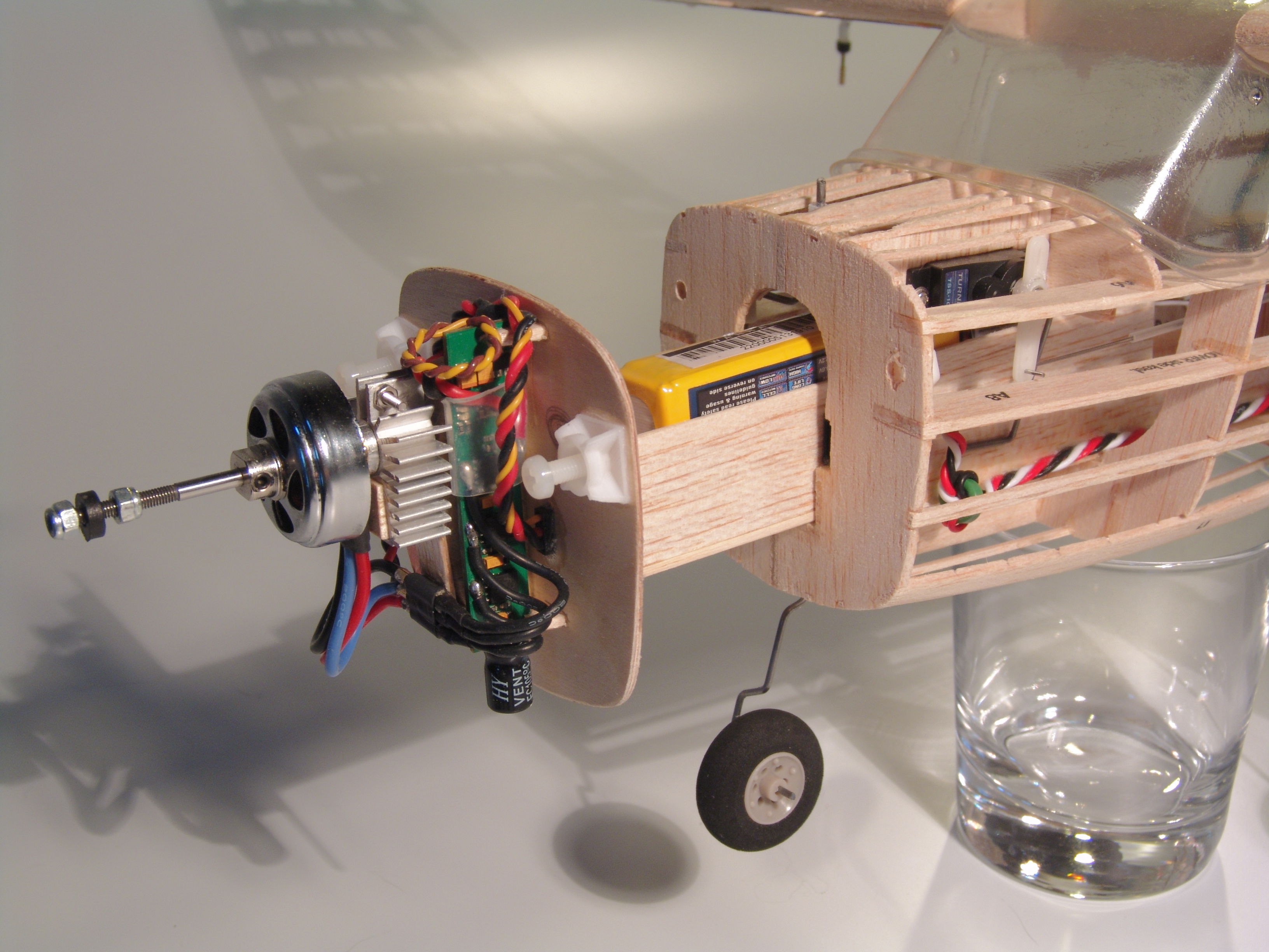

Battery Placement, CG and Engine Mount
A problem that didn't occur to me untill rather late is that covered airplanes, unlike open quads, need to have a provision to get a battery in and out. Oh, and as the battery is one of the heaviest things in the plane, that might actually change the CG... But as I didn't know where that will be with all the other stuff mounted, I had to have some wiggle room in placing the battery. Solution: build a sliding tray that allows changing the battery placement.
The tray is held by nylon screws which are reachable through the air intake openings in the cowling.

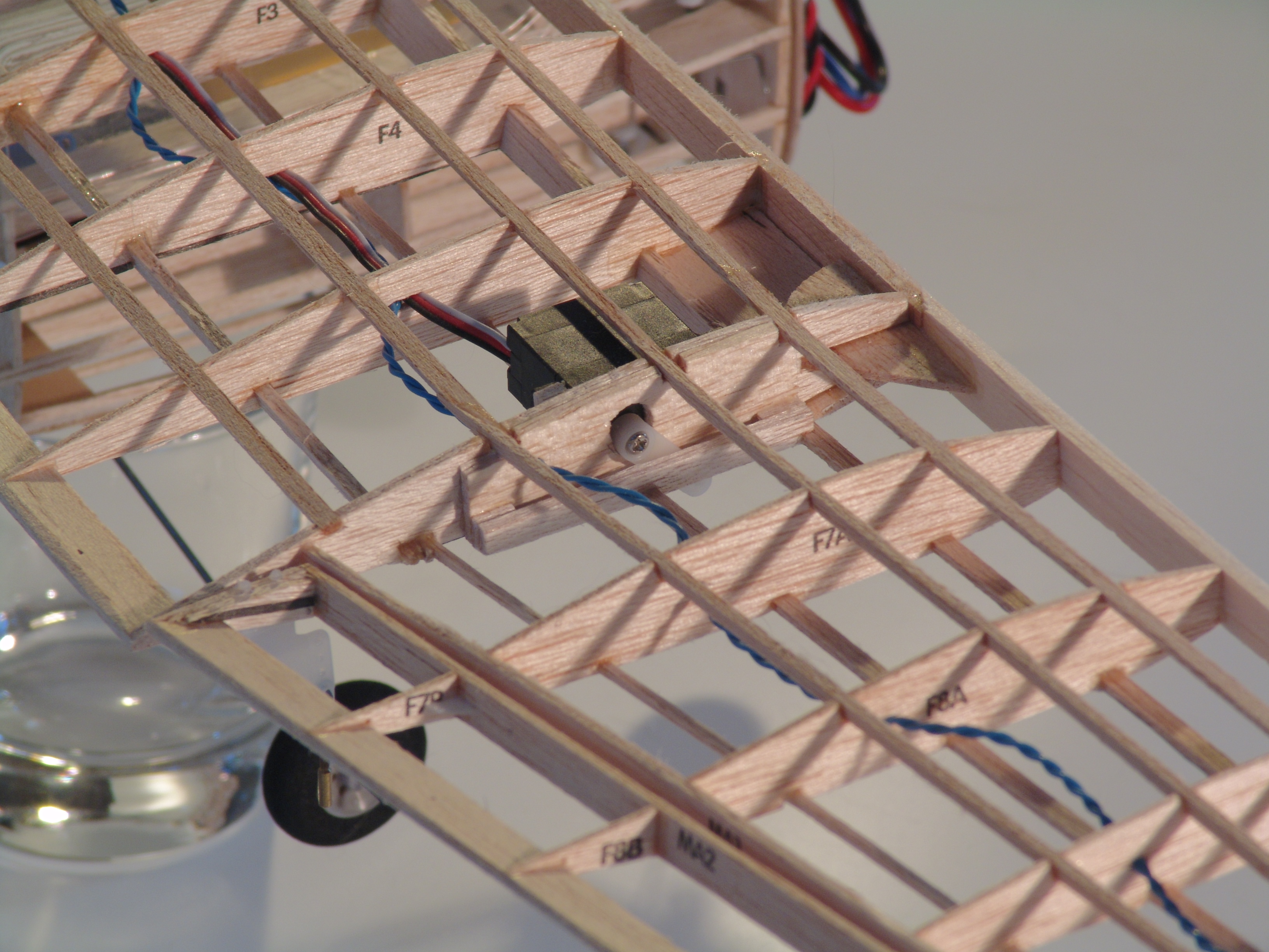

Ailerons
I decided to use two servos as I wasn't able to find/source that little flex cable in a tube. Also, having two servos should allow me to mix in a bias, making the ailerons flaperons.
The thing I struggeled most with was how to mount the servos so that I could still cover the rest of the wing... after all, the servo horn has to penetrate the skin somehow.

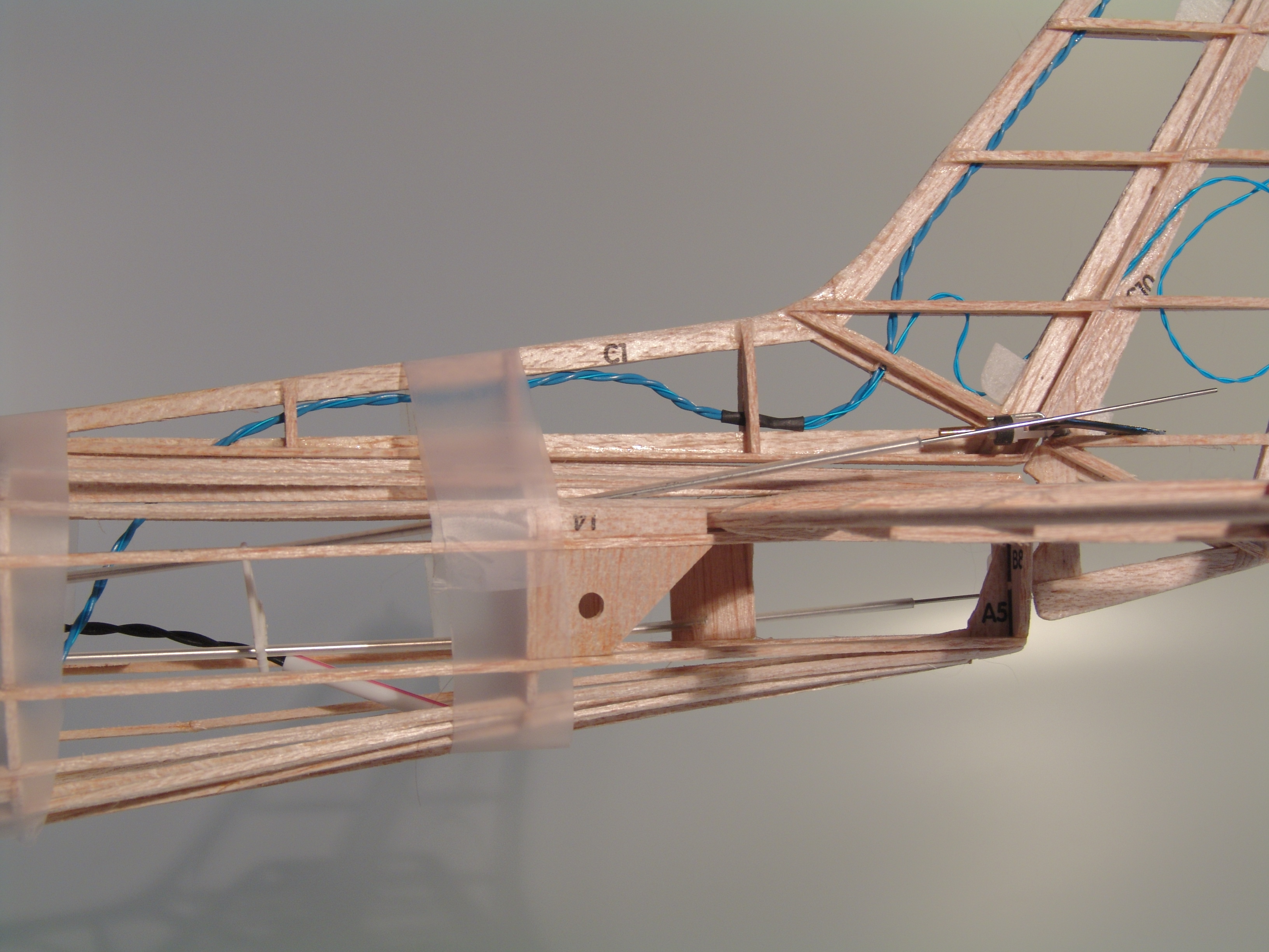

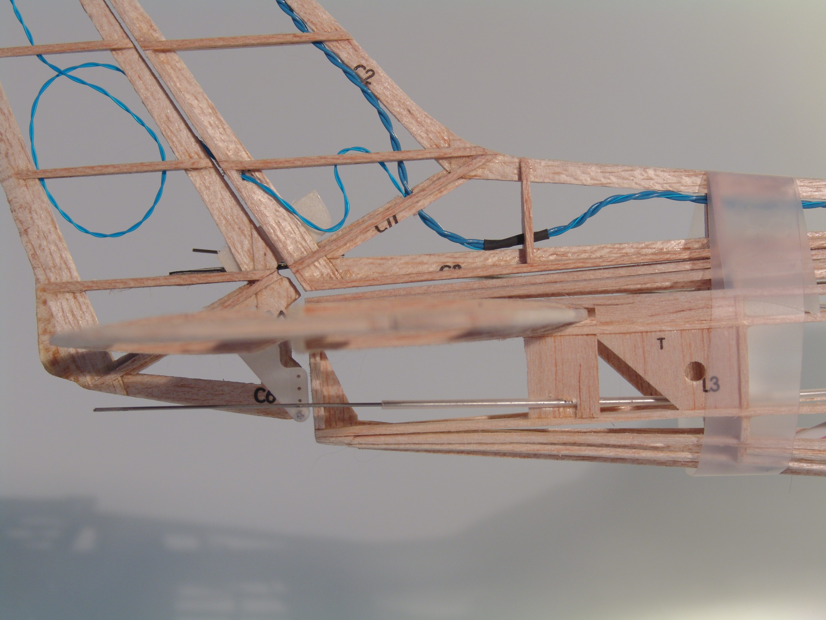

Rudder and Elevator
I wanted to keep as much mass as much forward as I could for CG reasons, which is why I ended up putting the elevator and rudder servos up front. This meant that I needed to run some wires to the back to attach to the surfaces... which was easy for the elevator, but rather tricky for the rudder as the kinematics of that darn slanted hinge ruined all my great ideas...

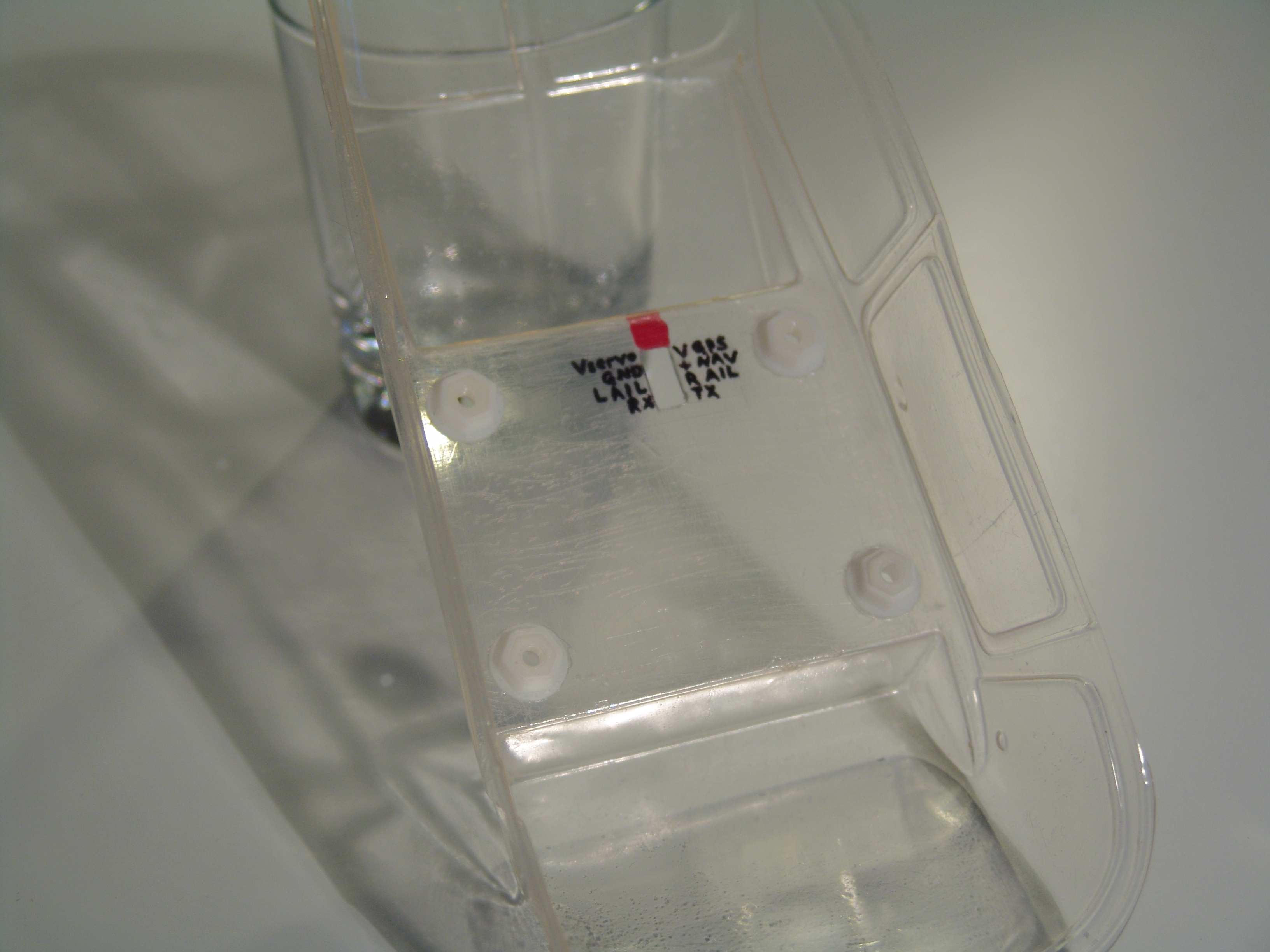

Removable Wing
I didn't realize that a build up C172 actually is too large to be easily transportable (or storable), so the wing needed to come of. As I had a whole lot of stuff in there (2 servos, GPS, nav lights), I centralized all the wires to a single 8 conductor connector that can be fed through the canopy. Four nylon screws can then be used to bold down the wing to the canopy and I 3D-printed some standoffs with a rim so that I could glue the covering material to it (I need to get to those screws somehow...)

My first thought is that you're going to come out too heavy. That's a small model, and you've already added a way over engineered battery compartment, lights, a GPS, and an Arduino. Consider making your first few flights without any of the extra stuff, then add pieces one at a time to see how they affect the performance.
A simple hatch would have given you battery access.
Covering is likely to throw off your current CG.
You'll have to take off the control horns to do the covering.
It's really helpful to have an access hatch to get to your wing mounted ailerons. The normal way to do it is to mount the ailerons to the hatch which then fits into a recess in the wing and is held in place with screws.

The CG is actually one of my biggest concerns. I have no way of telling where it will end up being, so I was hoping to use my tray so that I can reposition the battery freely in it whan all else is done.
That is true, I was hopeing to start the underside of the wings first, then do the cutout, put the horns on, and then cover the top.
So for this, does one just build a square frame to glue the cover on and which could then also be used to screw that hattch door in?

On most electric planes, you build a battery tray that you attach the battery to with velcro. You then have a velcro battery strap wrapping around the tray and battery to make sure it stays. The hatch is then just a cover to preserve the aerodynamics and appearance of the plane. On yours, the wing may need to be your hatch. Two horizontal pins can replace the screws you have at the front of the wings, making a battery change a 2 screw operation. Of course, taking out 4 screws isn't that hard either. Don't worry about the vertical CG. Thrust coupling is about where the drag is in relation to the thrust, not the vertical CG. And it's tuned with the vertical thrust angle, which you'll have to set after first test flight.
On the aileron hatches, you build a square piece to mount the servo onto, then make a frame in the wing that it will fit into. This article shows you how to do it. MAN has lots of good build articles, so spending some time browsing the site is a good idea.
http://www.modelairplanenews.com/blo...-wing-hatches/
