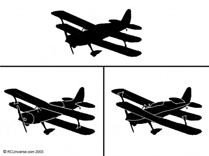

yes it is true that it could be difficult to determine the right side up or upside down thing. I wouldnt recommend a second plane as a bipe. master a low wing TAILDRAGGER before going to bipes. a tail dragger is a hole new world compared to your trike trainer. right rudder on take off a little and ease up on elevator...its tough. once you master tail dragger, go to bipe. I remember my first tail dragger flight, i fishtailed down the runway from over compensating rudder and trying to keep it straight! now its automatic, i go full throttle takeoff, my thumb is already at the right amount of right ruddeer, its a "feel" sorta thing.....dont go bipe, go with a super sportster or something, they are great first low wings, and they are are fast too, even with a .46!!

ORIGINAL: zetor
That was a good example. That's like one of those mind trick pictures in a psycology book. I'll bet color pattern is important with bipes.
But the silohettes are important to think about even with good color schemes... under certain light conditions that is exactly what you will be seeing, no matter what colors were used.
