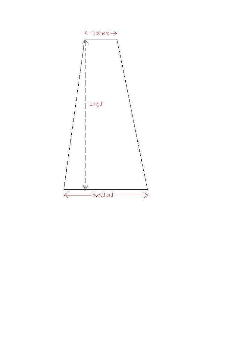

I, for the life of me, cant remember how to figure out the area of a wing... or anything for that matter, if its not a perfect square or rectangle....
the wing's chord by the fuse is 15.25" and at the tip is 7.25". The LE is 31.75" and the TE is 33.5"

Area = Length * Width
However, the surface of an airplane's wing isn't flat. This will require a little more. The easiest way I can think of to figure it would be to use a piece of string. Hold one end of the string on the leading edge. Pull the other end to the trailing edge. Mark each end. Measure the distance between the marks. Use this as the width. Measure the length. WingArea = 4 * (width * length) - assuming a symetrical airfoil.
If it's a tapered wing with a symetrical airfoil:
Use string method at the tip and the root. This is a trapezoid. Area = [(TipWidth + RootWidth) / 2] * length
WingArea = 2 * (TipWidth + RootWidth) * length
A flat-bottom or semi-symetrical airfoil will require a top wing measurement and a bottom wing measurement.
WingArea = 2 * (TopArea + BottomArea)

RichD wrote:
As a matter of fact its even less:
Average chord = (15.25"+7.25")/2 = 11.25"
Average span = (31.75"+33.5")/2 = 32.625"
Wing area = 11.25" x 32.625" = 367 sq.in.

Posts: 112
From: Ellis,
KS
You wouldn't count the fuse section as part of the wing area. Although it technically does provide a small amount of lift, it isn't considered part of the wing.
So the formula is:
WingArea = ([(RootChord + TipChord) / 2] * Length) * 2
Which simplifies to:
WingArea = Length * (RootChord + TipChord)
Note:
Length = distance perpendicular to fuse to tip. NOT (trailing edge length + leading edge length) / 2
So the formula is:
Note:
