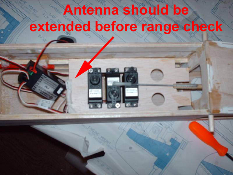

Yes that is what a range test is. But looking at your pictures from your build thread you show the receiver antenna coiled up, if that's the case then 10' will be just about as far away that you can get. When you do a range test you should have the receiver antenna FULLY EXTENDED. With the receiver antenna fully extended then you should be able to get ~100' away from the plane and still control it with the transmitter antenna collapsed.

Point I was going to make to him bruce. I thought it was the LT-40 that the problem was with but I was wrong, it is perfect. The problem as it turns out was the Senioritta. I looked at the setup there and found out that the servos were linked up wrong and THAT was the airplane that the elevator and rudder were on the right stick (I knew there was a plane that was set up that way). I have since corrected the linkup and it is now correct. I have still got some jerking in the servos as mentioned earlier and I am still working on it. Will get back to you if I can not figure it out. Thank you.
I understand that the antenna has to be uncoiled but I only plugged the servos into the receiver of the Tower Trainer to install the servos.
I assure you that is not the reason for the servo frenzy. The antenna is attached at the fin.
