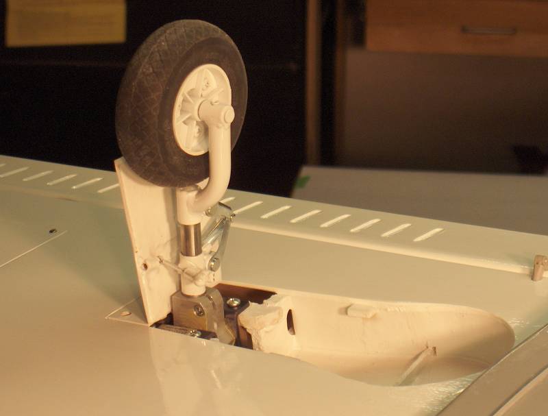

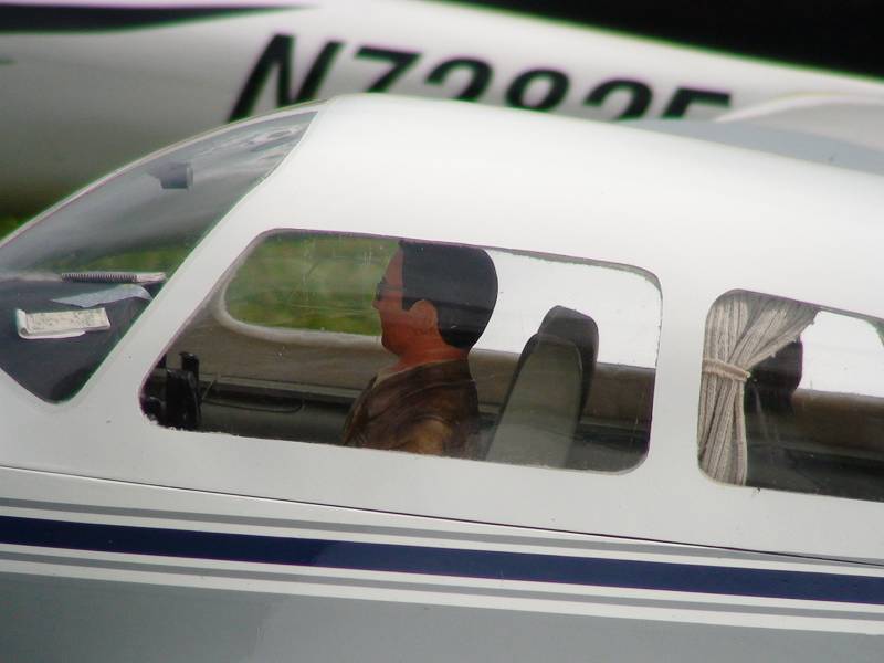

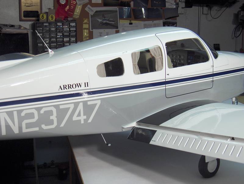

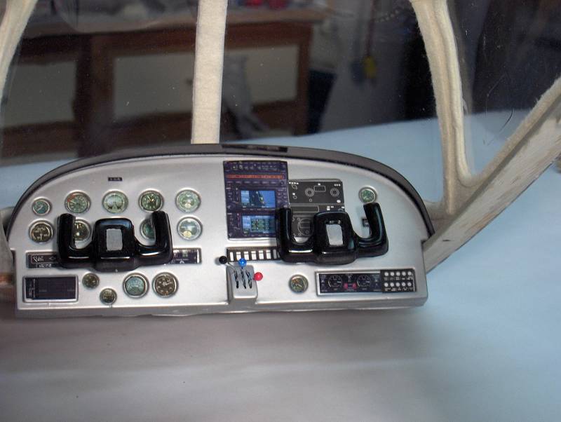

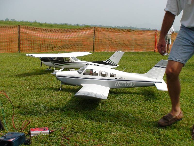

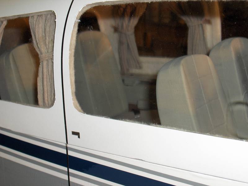

My TF Arrow weighs in at 15 lbs. with an OS .91 4-stroke/ flex pipe (OVER POWERED for my taste). I fly it scale at approx. 5/8 throttle in cruise.
It flies like a champ and super easy to fly with no surprises. With a moderate AOA I can maintain Alt. and a remarkably slow speed.
You will have no probs with the .61.
Some pics. There's more in my Gallery.

Sweet job on yours... I like that you built the surfaces with corrugations (all 236 of them[X(]) and got the cowl flush with the fuse.
Yours is LIGHT compared to mine... Your .61 will not work hard to keep it flying.
Mine is 'heavy' with lights w/ batt, retracts, cockpit and small extras and flies very very well.
Be sure your engine is broken-in and well adjusted (needles) and CG'd properly before you maiden it. You'll have fun with that plane's performance.
