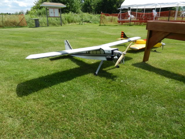

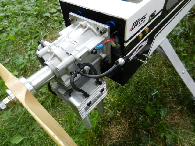

Charlie P. 09-25-2013 06:38 PM
2 Attachment(s)
I can very much recommend the Maxford Mentor-G as a first gasser. Also as a first anything IF YOU HAVE A INSTRUCTOR. An 18" or 19" prop ahead of 2.5Hp is really a bad way to end your manual dexterity. Once you know the ropes, however, a gasser is easier that glow or electric IMHO. Mine has a magneto Zenoah G-26 and just needs a simple single 2000mAh NiMH receiver battery pack for an hour of flight time. Land once to refuel. Twice if you fly fast.
http://www.rcuniverse.com/forum/atta...mentid=1924892
http://www.rcuniverse.com/forum/atta...mentid=1924894
I have had mine on floats and just swapped out a carbon fiber gear strut and 4-1/2" balloon tires and it is an absolute hoot. I also added smoke. Even as a fairly good pilot I find a big, dopey ARF like this is a joy to just fly around. Does pretty well with Aresti maneuvers, too. (The kind of aerobatics that airplanes with humans in them fly). Uses the same mix I run through my chainsaw.
83" wingspan is easy to see and I have flown it in 20 mph winds without much stress.
