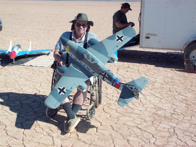

JohnBuckner 01-28-2014 05:36 AM
1 Attachment(s)
Thank you very much BigTim, AMA 74894 and opjose for the info about the piano wire for the HK electrics so based on that and what I experienced with my DF 262 I think will go ahead and order up a batch of them to experiment with on various projects. Heck that thing weights seven pounds and the gear is holding up even on the rough lake bottom:)
John
http://www.rcuniverse.com/forum/atta...mentid=1962781

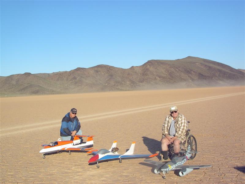

JohnBuckner 02-03-2014 11:08 AM
1 Attachment(s)
I have no idea of who makes its the gear was in it when I horse traded for it. The fellow was in way over his head with this airplane. Any way three of us have been working on our turbine wavers at this lake and I just brought the foamy along for fun. The 262 flies fine, nice rolling airplane but does not loop well.
The lake is a remote one that we are using for the waver Quals and so far one of our fellows has acheved the waiver and now can fly at our home field.
John:rolleyes:
http://www.rcuniverse.com/forum/atta...mentid=1964995
