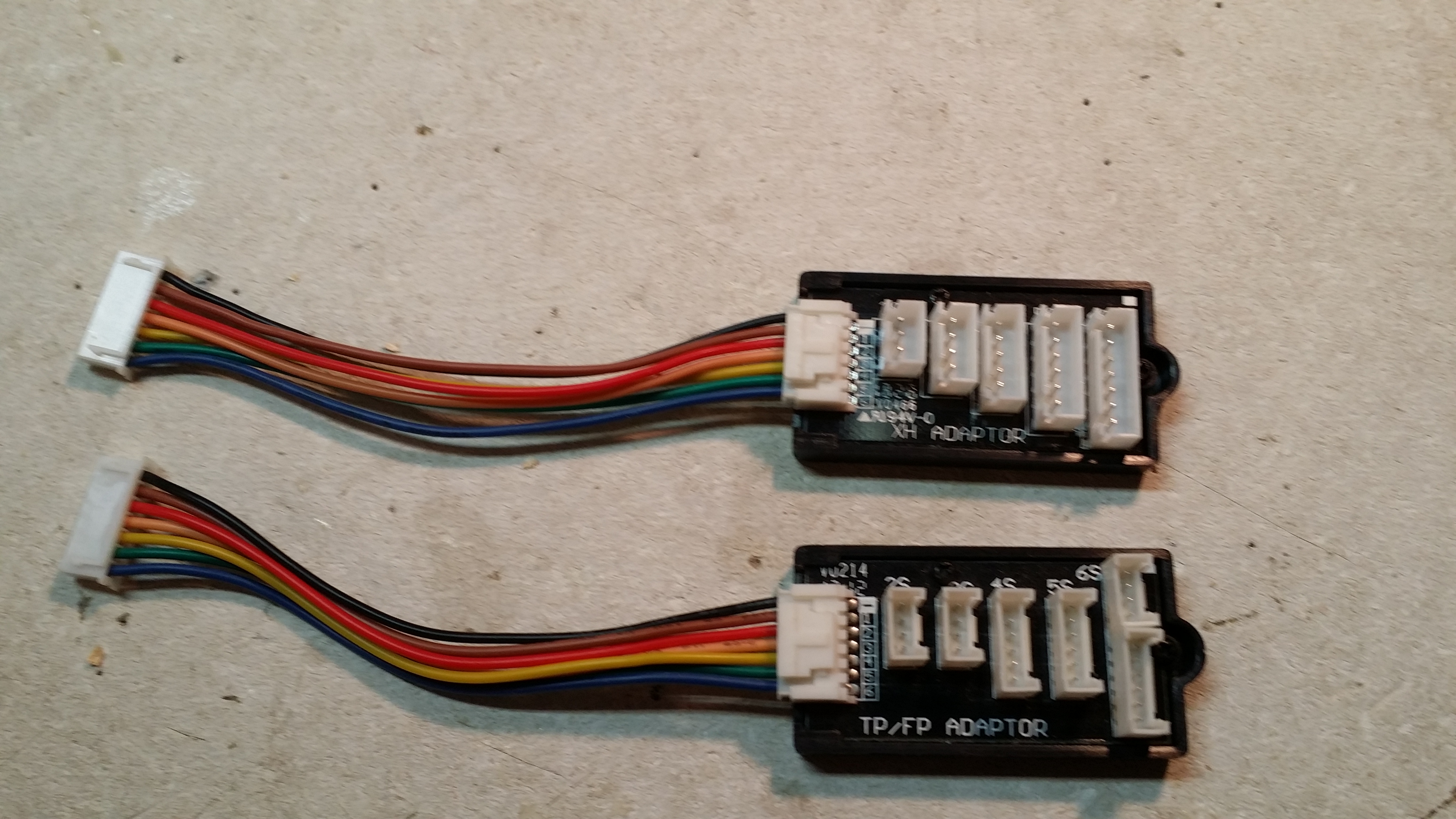

Here are a couple of pics I made of the two types balance adapters for the X-4 (on the bottom of the first picture. Those on top are the adapters for those Venom Pro Plus's.

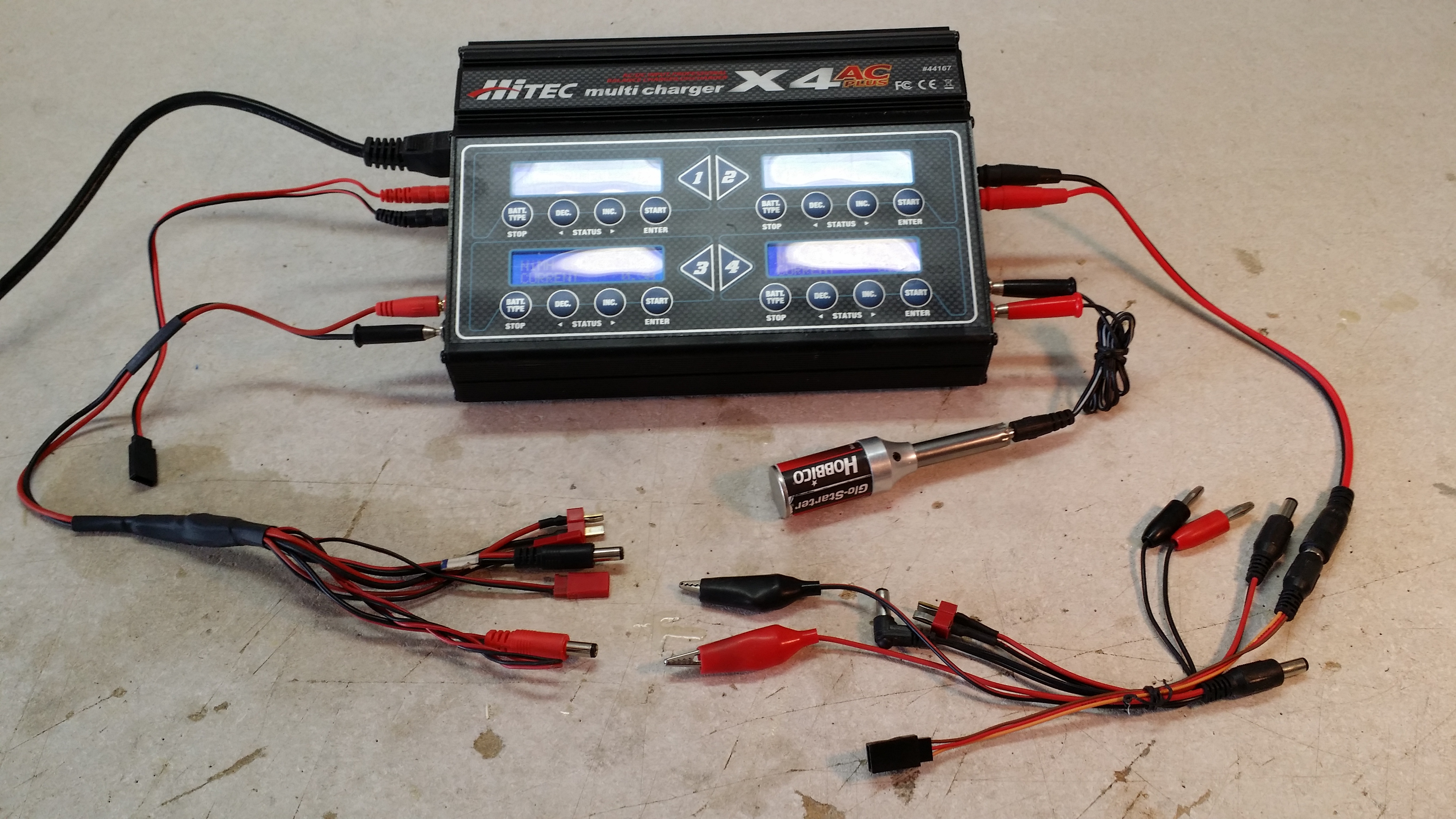

JohnBuckner 09-28-2014 04:58 AM
Yes as Joe indicated you have the batteries plugged improperly. In these last two pictures those appear to be Nicd flight and tx packs. These type of batteries have no balance ports and a single lead to charge them you use the pigtail you have in those pictures. The banana plugs will plug into one side of the charger (these are the main charging leads and not the balance plugs).
You will need to solder on a female J plug to those leads. When you charge these types of batteries this is where the single battery lead is plugged and the balance ports are not used.

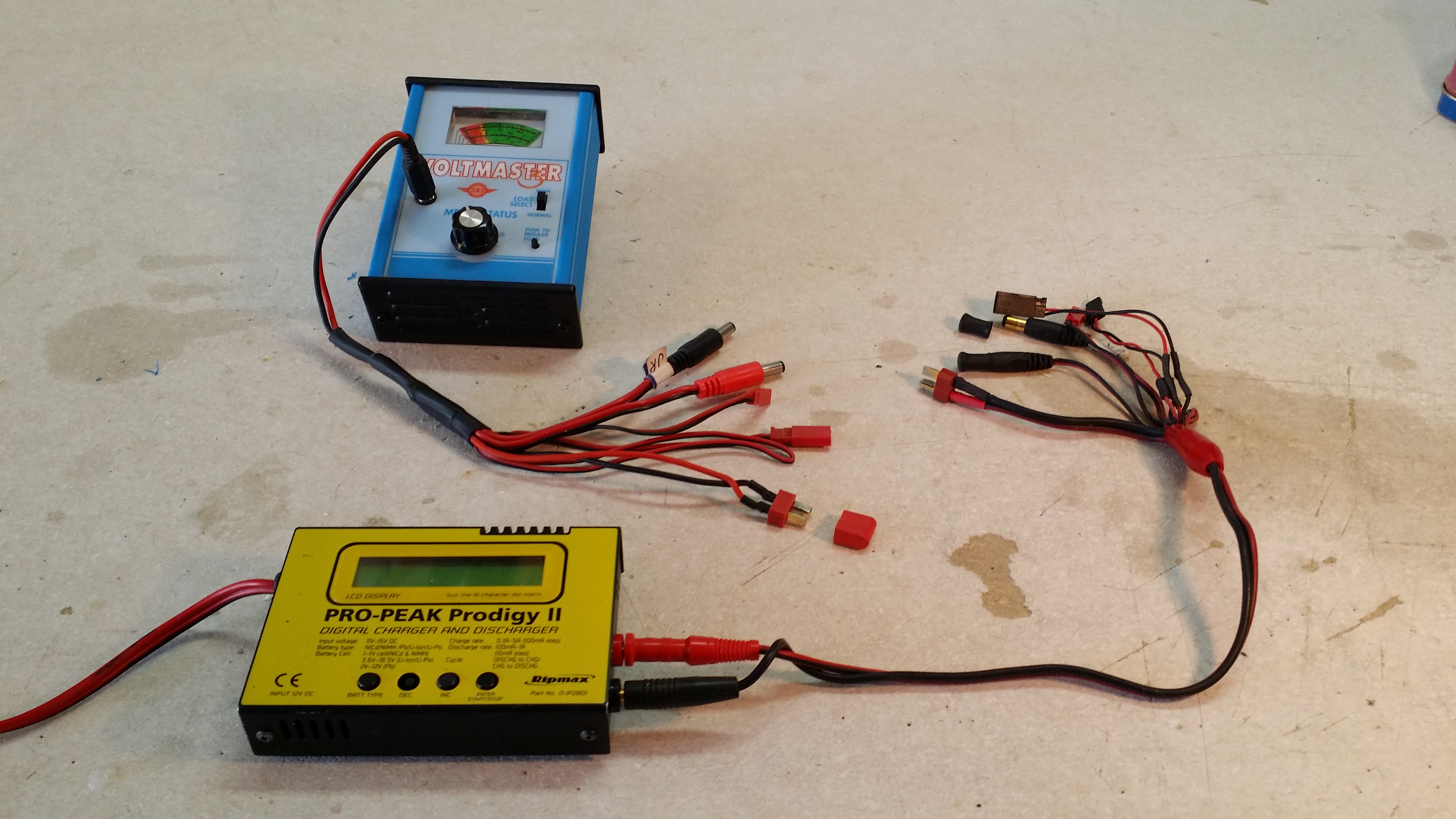

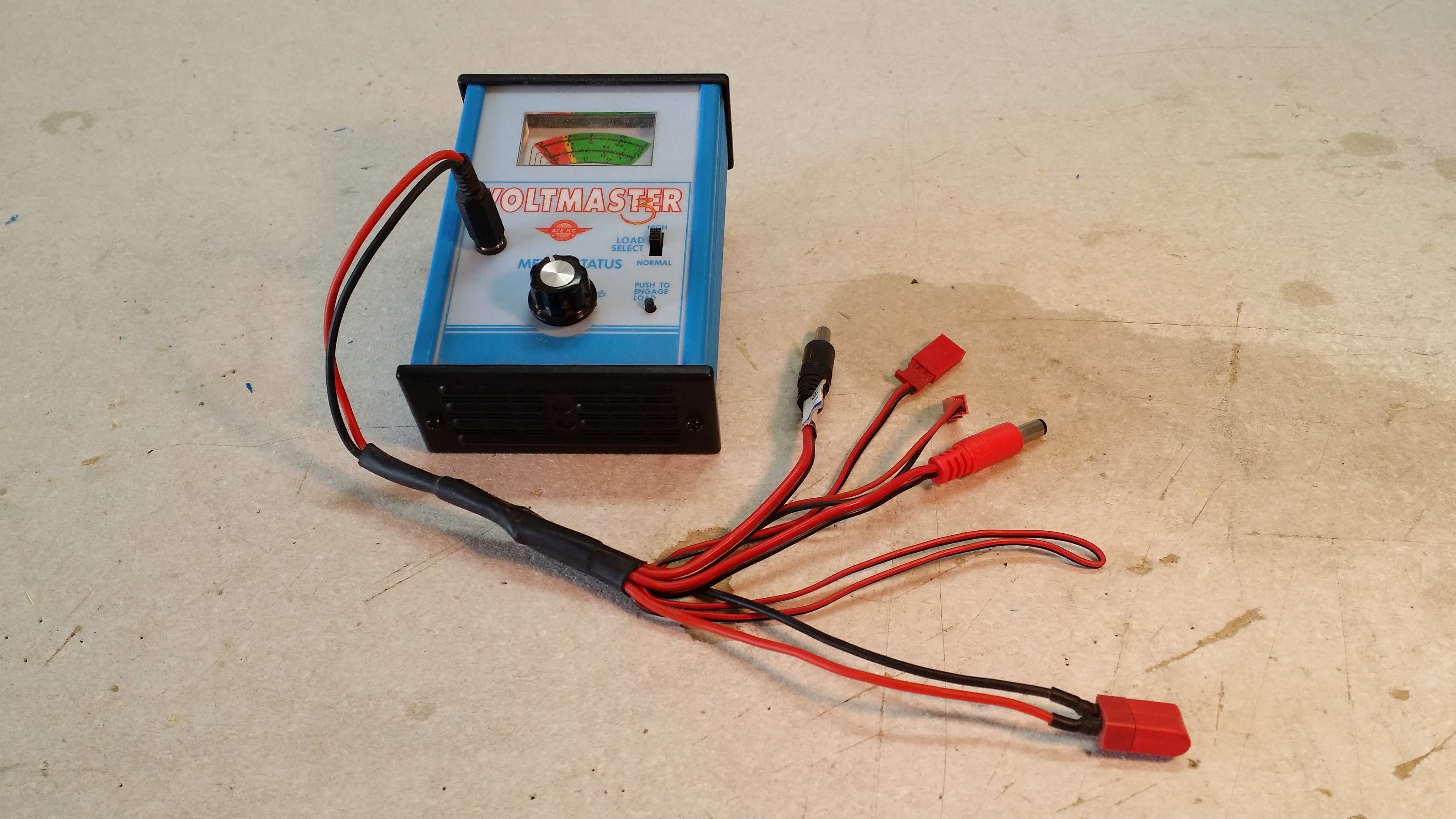

I use leads I call Octopus' leads. They are cheap and have the banana plugs for the charger and around six different types of plugs on the other end and you just use the one you need. Can't right now but I will post a photo of those when I get back from the field this morning.
John

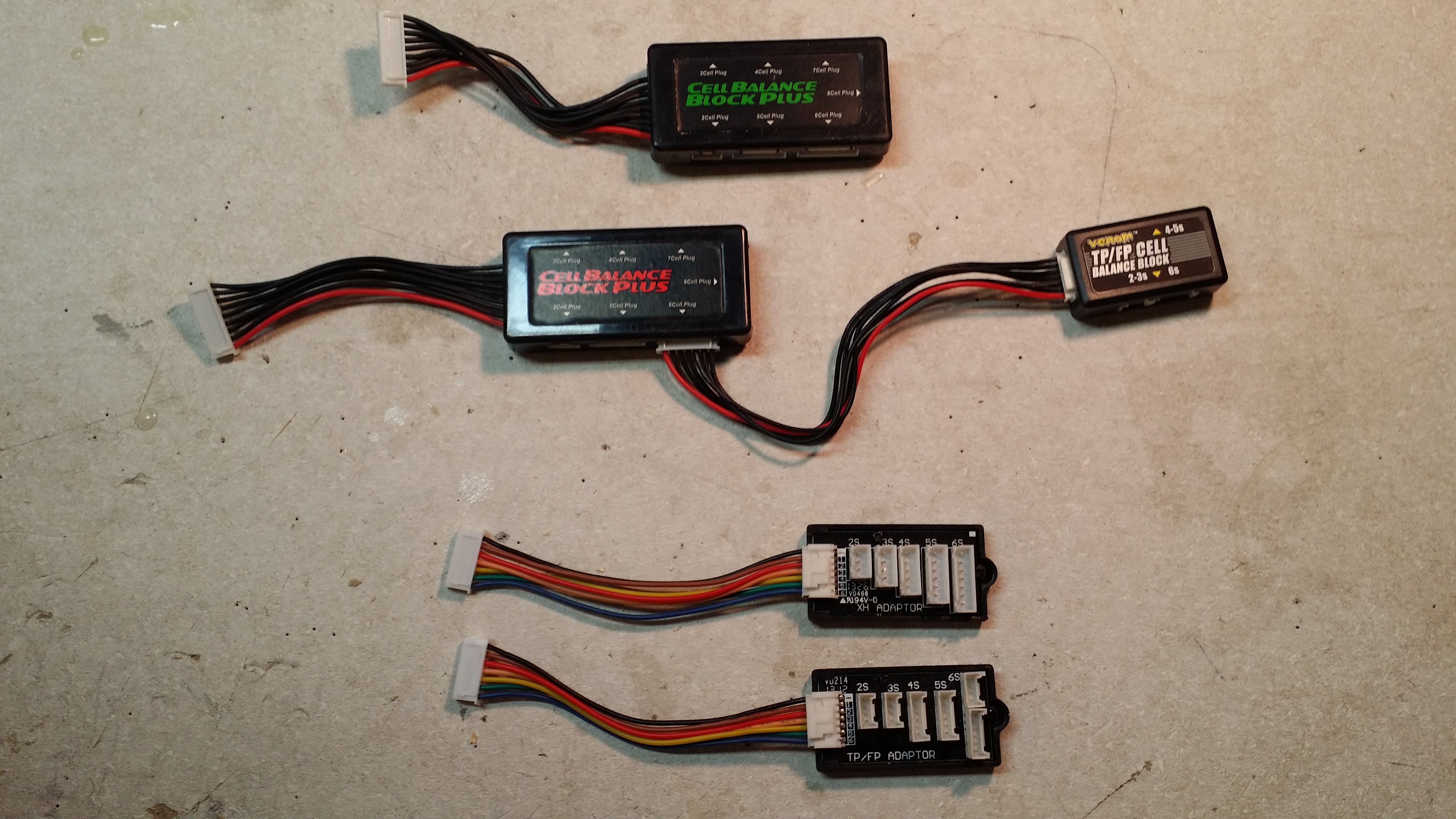

These are the photo's I promised this morning of the variety of Octopus adapters that you eventually need. And while not every brand of Life may not have a balance port adapter the commonly avalible ones I have certainly do and I absolutely would not charge without it. There were some early lipos without balance port adapters and you were lucky if you got 20 cycles out of them before they were useless and dangerous.

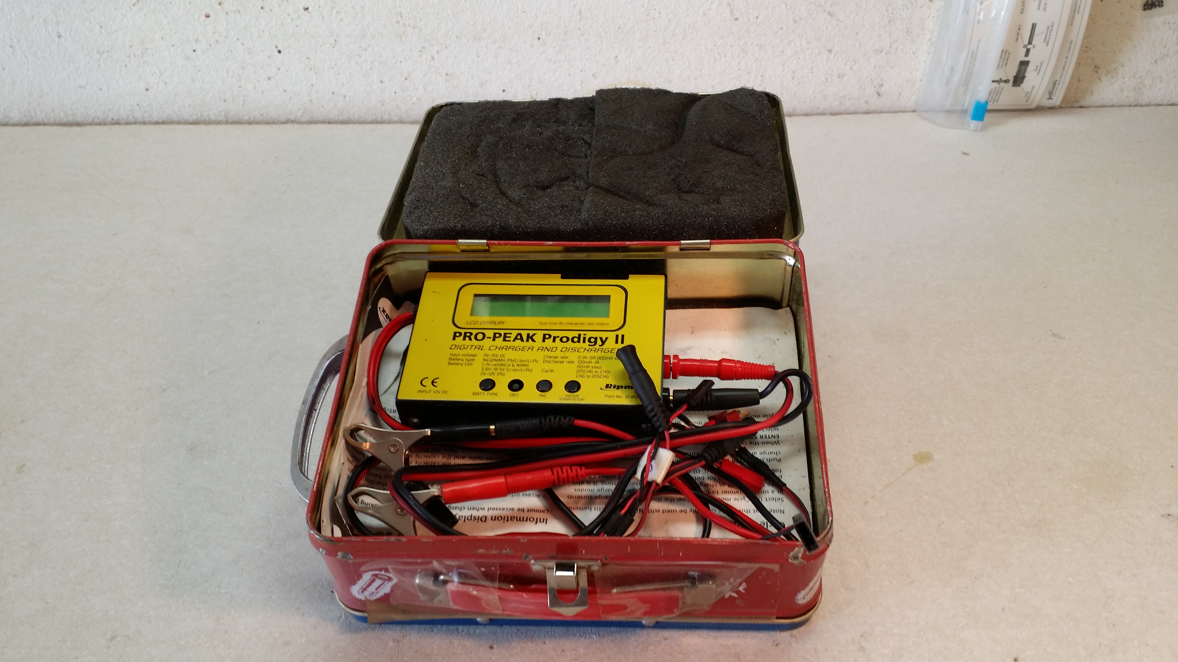

Threw in a couple of pics of my Lone Ranger Pail that serves to house the simple, cheap, four button fifty watt charger for any need that may arise at the field.
