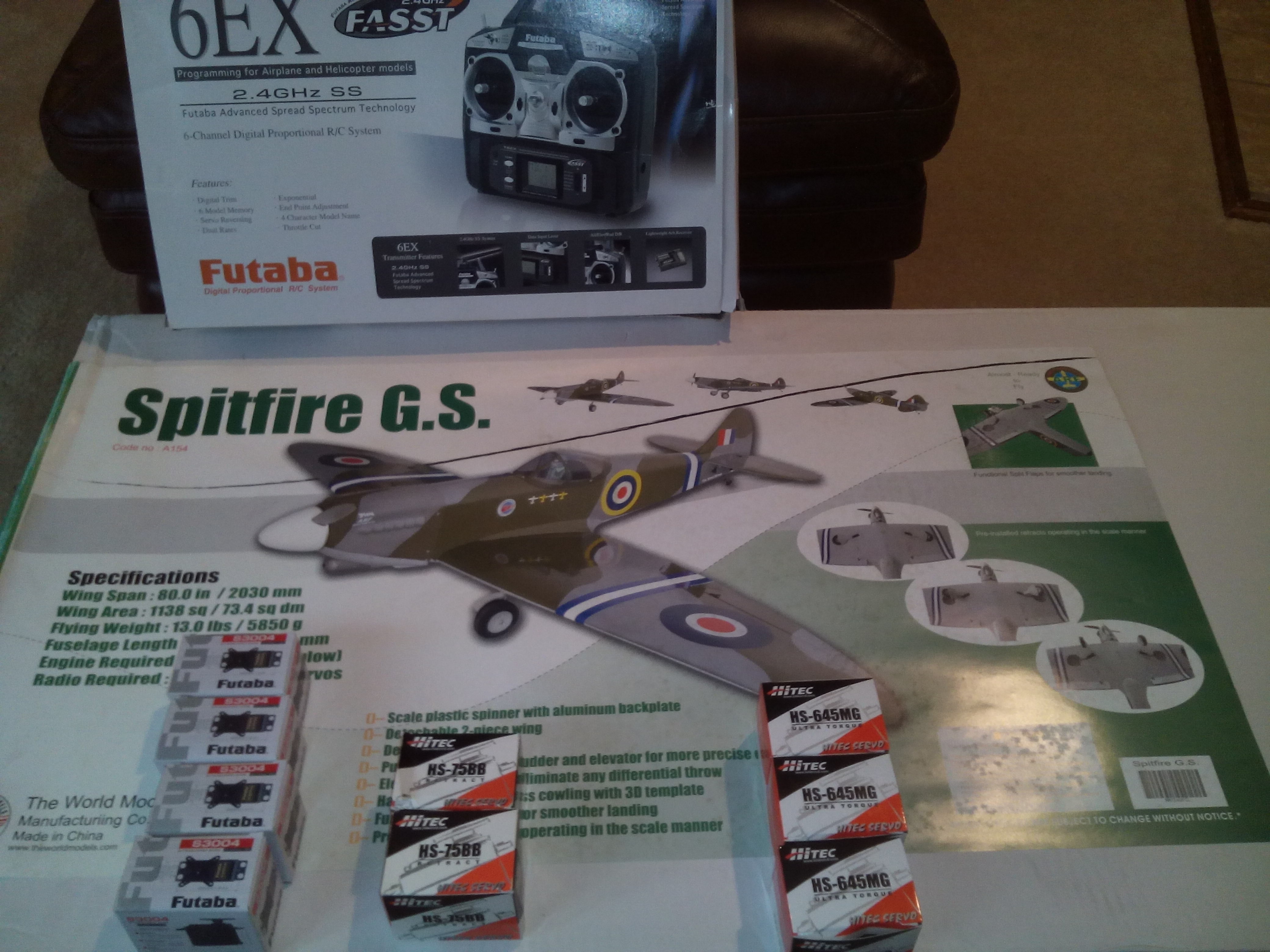

This is my first build after trainer.... Are these components ie servos and tx/rx going to be ok for this wa bird... I am going to get the dla 35ra engine..Thanks
Hydro Junkie 06-02-2015 02:04 AM
Radio should be fine IF you don't try to use more channels than the radio can handle
Retract servos should be okay
The Hitec 645MGs have plenty of power for that plane, depending on where you are using them
The S3004s have me concerned, depending how and where you are going to use them

OK re servos. Any regular standard servo will do for all flying surfaces and the throttle. Futaba 3004s will do just fine maybe run em on 6 volts.
Flaps Beginners you are a beginner to using flaps, tend to deploy them at speed. Blow back is common. You are likely to have two servos on flaps one in each wing. Uneven blow back will induce a roll. This is very bad news. So the only servos I would definitely need to be hi torque are your flap servos and preferably digital. 100 oz inch would be good.
I have test flown a Michael Bryant ?? long time ago Spitfire anyway it was Zenoa 38 powered. It had Futaba 148s an everything except retracts and flap blow back was an issue.
What are you doing for retracts?
Good web site that I use for servo info http://www.servodatabase.com/

To answer your questions on set up: I would use the Hitech 645 on the elev and ailerons. Most of your flying is on elev and ailerons so use good servos. Use a 645mg if you can for the rudder but not required. It could fly with the standard servos, but as you pull out of a steep dive or loop you want the elevator to hold and not go mushy or you may impact the ground. So a little extra torque with the 645mg is good cheap insurance.
Use the the standard servos for throttle and the flaps would also be ok. As to flaps, Spits have a split flap so as you deploy them it wil normally nose down. ( my zero's ballon up with flaps). We correct with mixing in some up elevator anytime flaps are used, personally my spits have done best with only about 20 degrees for initial 1/2 flap position and then 45 degrees for full flaps. Flaps don't take that much servo or air pressure as you are nose down in approach but there is a certain way to set them up so the mechanical advantage is best and you are not stressing the servo as much. Check with your local Warbird pilots. They will teach you.

Your kit looks like a world models spitfire. I've had one, and they fly great..very forgiving. I would still fly it with an experienced pilot, but you won't have any issues with this one tip stalling. Just a note...the covering in these sucks! Put clear tape on all the leading edges, and don't get anything on the "painted" camo..lit will come right off! You'll probably need a ton of nose weight...don't be alarmed by that.....

Finally.. Thank you, Thank you, Thank you. Someone who actually answered my original post. WOW!!! And you didn't wish me a horrible crash landing or ridiculous wager...
