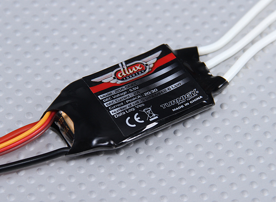

HobbyKing supplies a useful range of speed controllers, the TURNIGY DLUX ESC range (photos of some models shown below):
http://www.hobbyking.com/hobbyking/s...SortOrder=desc
They are available in standard form (2S to 4S Li-Po) in 20A and 30A ratings.
They are available in higher Li-Po spec (2S to 6S Li-Po) in 40A, 55A, 70A, and 100A ratings.
All these 6 DLUX ESC models have S-BEC, and have data logging features (when used with the program box -there seems no facility to download the data to a PC).
In addition: These DLUX ESC'sare available in HV (high voltage) form ( -6S to 12S Li-Po) in 80A, 120A, and 160A ratings -and these 3 HV models have no BEC (opto) and no data logging feature.

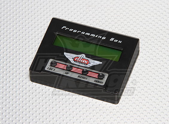

They can all be programmed (and stored data accessed) using a program box which looks quite distinctive (see photo below)
- http://www.hobbyking.com/hobbyking/s...g_Feature.html
I wonder: Do we know which (chinese) company actually makes this range of DLUX ESC's ...?
My own guess, at present, is that itmay be the well-known ZTW chinese ESC factory ... ? - http://en.ztwoem.com
-This is (partly) because the distinctive-looking (unique) program box is identical to the one supplied byGens Ace (i.e. AcePow), for all Gens Ace aircraft and car ESC's.
It is also very similar to the program box supplied by OK Hobbyfor their "Infinite" range of aircraft and car ESC's

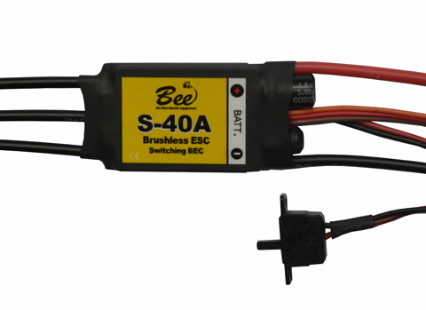

INGS Bee's Electronics: http://www.ings-cn.com/ESC/esc.htm

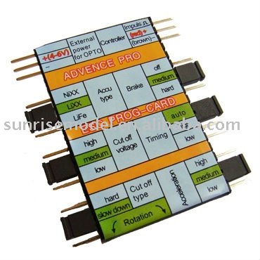

ESC brands that are known to be manufactured by Sunrise Model:
Sunrise Model "LBEC" and "SBEC" series of ESC
Sunrise Model "Cool" ESC's
Sunrise Model "ICE" ESC's
Hobbyking YEP ESC's (= Sunrise Model "ICE") -use same program card as ICE - http://www.hobbyking.com/hobbyking/s...dProduct=20698 (these ESC's used to be called:"Dlux Helidrive" ESC's)
Innov8tive Cobra range of ESC's - http://www.innov8tivedesigns.com/index.php?cPath=22_126

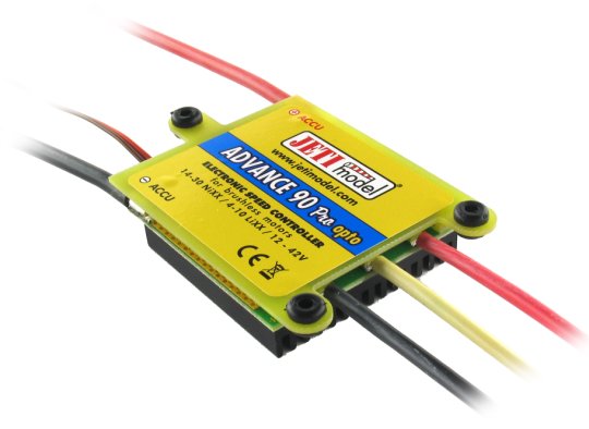

Jeti ADVANCE PRO range of ESC's - http://www.jetimodel.com/index.php?p...=0&category=19 (Jeti program card is identical to Sunrise card - http://www.jetimodel.com/index.php?p...=0&category=46 -proving they are made by Sunrise Model)
Jeti ADVANCE PLUS range of ESC's -also use the Sunrise Model program card, therefore made by Sunrise Model
Maytech Harrier-eXTrem (MTA) Series ESCs - http://www.maytech.cn -use Sunrise program card, and are therefore made by Sunrise Model

SAKER Advance ESC from Keda Model - http://kedamodel.com/product/escs.html -use the Sunrise program card
Electrifly Silver Series Brushless ESC's, 60A and 80A -Electrify program card looks like Sunrise Model card - http://www.electrifly.com/miscproducts/gpmm1895.html Also back side of Electrifly 80A ESC looks identical to back side of Jeti Advance 90 ESC's.-Since Jeti Advance ESC's are made by Sunrise Model, and since Electrifly 80A ESC looks identical to Jeti Advance 90A, seems likely that the Electrifly 60A and 80A ESC's are manufactured by the Sunrise Model
In addition, some online retailers sell these ESC's with their original label "Sunrise Model"

It is not difficult. In most cases, it is simply because the branded program card or program box,used forprogramming different ESC parameters, is identical between the various brands made in the same original factory.This is by far the biggest give-awaythat these different brands are identical, thatthey must come from the same factory,and that they areinter-changeable with each other.
The program cards used for ZTW vs. HobbyWing vs Sunrise Model ESC's (for instance) are different and distinctive, and when one branded ESC uses a particular generic program card, then we can be 100% certain about the original factory in which this ESC must have been made.
4. In a few cases,we can rely on the appearance of the ESC and on its specifications (weight, size, electrical specs, number / sizecapacitors etc ). Especially for 100AESC's and larger, the appearance of a ZTW-derivedESC is quite different from e.g.a XingQiong (XQ)-derived ESC, and then we can easily identify the original factory in which it must have been made.

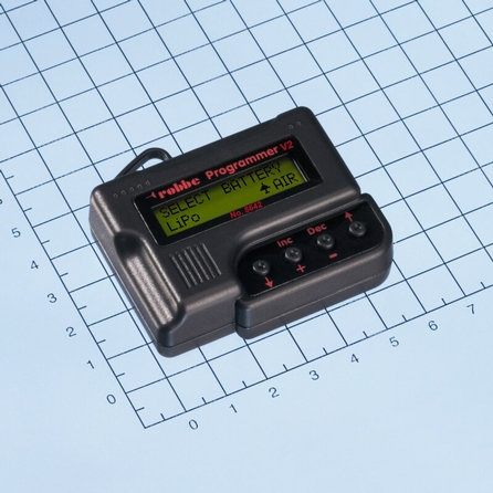

ESC brands that are known to be manufactured by SJ-PROPO (China and South Korea):
SJ PROPO Hawk Programmable range of ESC's - http://www.duanesplanes.com.au/home.php?cat=47
These are same ESC's as: LogicRC Fusion Hawk ESC's - http://www.logicrc.com/?s=c:0,c:50,c:50-30,c:50-30-20
Both use same distinctive program box - http://www.logicrc.com/?ItemId=P-FS-...30-20,b:Fusion
and http://www.duanesplanes.com.au/produ...&cat=47&page=1
The identical program box is used by O.S. for their own-branded ESC's - http://www3.towerhobbies.com/cgi-bin/wti0001p?I=LXBYTX
and also by Futaba for ESC's - http://www.esky-heli.com/futaba-mcp-...a-mc9100a.html
and also by Robbe for ESC's - http://www.robbe.de/programmer-v2.html
and also by MegaPower for ESC's - http://www.alien-rc.com/oscommerce/c...roducts_id=325
and also by Exceed for ESC's - http://www.modelsport.co.uk/fusion-e...products/35200
and also by Tahmazo for ESC's - http://www.tahmazo.com/products/catalogue/25/154
Since all these differently branded ESC's use the same programming box, it follows that these ESC's must have a common origin and that they will all be made in the same (SJ-PROPO) factory.Therefore all these ESC brands will have the same specs and features, and be inter-changeable. From this, it is clear that the SJ-PROPO factory must manufacture (at least) ( -and as far ESC's are concerned):
SJ PROPO Hawk ESC's
O.S. ESC's
Futaba ESC's
Fusion Hawk ESC's (same as LogicRC Fusion ESC's )
Robbe ESC's
MegaPower ESC's
Exceed ESC's
Tahmazo ESC's

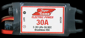

Electrifly Silver Series Brushless ESC's, 8A to 45A
Whichcompany might make these Electrifly ESC's, isan interesting question: I have discovered it is: INGS Bee's Electronics- http://www.ings-cn.com/ESC/esc.htm
Main points:
1. The Electrifly ESC's lookdifferent from any other ESC's -they have (what appears to be) 2 different length capacitors on the battery input side -most ESCs have 2 identical capacitors on this side http://www.electrifly.com/escs/silverseries.html
2.Electrifly ESC'sare identical in configurationwith Super Tigre ESC's(see pics)- http://www.supertigre.com/electric-p...-controls.html The Super Tigre ESC's are available in 20A and 30A rating,whereas Electrifly Silver Series ESC's are available in 8, 12, 25, 35, 45Arating. Nevertheless, Super Tigre ESC's are clearly identical in format, and obviously come from the same factory as these Electrifly ESC's.
3. A targeted search showed that these ESC'sare made by INGS Bee's Electronics, in China- http://www.ings-cn.com/ESC/esc.htm The configuration of the Bee ESC'sis clearly identical to the Electrifly and Super TigreESC's (see pic).The INGS Bee ESC's are available in 15, 30, 40 and 50A ratings(and soon 60A, so they say).
4. The specs of the Bee 30A ESCare identical to the Super Tigre 30A ESC; and even the parameters are listed in an identical order.
The specs of the Bee 40A ESCare identical in almost all respects to the Electrifly 35A ESC.
There really cannot be any doubt that INGS Bee, Electrifly and Super Tigre ESC's are identical, and come from the same source.
5. These ESC's are not really programmable-they are more"Plug and Play"http://www.rcuniverse.com/magazine/a...article_id=615
The only thing which can be altered is brake on / off, usingthe Tx.They have a useful "safe start" feature.
6. There seems to be no other supplier besides Hobbico (of which Great Planes, Tower Hobbies, Electrifly are a part; they distribute Super Tigre) which sell these somewhat unique ESC's.
7. The larger Electrifly 60A and 80A ESC's come from a different manufacturer (see next post).
1. The larger Electrifly 60A and 80A ESC's come from a different manufacturer, and are completely different in configuration to the smaller ESC's 8 to 45A.
2. The 60A and 80A ESC's can be programmed using a card (the smaller ESC's cannot be programmed). My guess is that these larger Electrifly ESC'sare probably made by Sunrise Model http://www.sunrisemodel.com/ -because the program card looks very much like a Sunrise Model card. We cannot see the program card from the front on the Electrify webpage, however the rear view and the pins of the card look like a Sunrise Model card - http://www.electrifly.com/miscproducts/gpmm1895.html.
3. Also the back side of theElectrifly 80A ESC looksidenticalto the back side of a Jeti Advance 90 Pro ESC, and also to the back side of a Jeti Advance 90 Plus ESC (see pics below, left pic is Electrifly 80A, pic onright of this is back side of Jeti Advance 90).
4. The Jeti Advance series of ESC's are known to be manufactured by Sunrise Model -the program cards for Sunrise Model and for the Jeti Advance ESC's are identical (see pics), so these ESC's must come from the same source.
5. Since it is clear that all Jeti Advance ESC's are made by Sunrise Model, and since the back side of the Electrifly 80A ESC looks identical to the Jeti Advance 90A, and since the Electrifly program card looks like a Sunrise Model card, then it seemsvery likely that the Electrifly 60A and 80A ESC's are manufactured by the Sunrise Modelfactory inChina.
