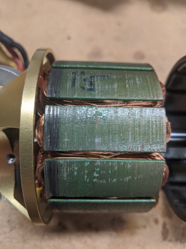

I purchased this 65cc Rimfire motor and Castle 160A esc from a guy to put into a Phoenix 60cc Spifire.
My first try with electrics on this scale.
I hooked it all up and everything seemed to be working fine.
Finished the plane and took it out in the yard to do a test run.
I used a 26x12 prop and a12s battery.
Ran for a couple of minutes and the motor seemed very hot.
Hot enough it you could not touch it.
I maidened the plane and just flew it at about half throttle, because I was worried about the heat.
Flew it a second time again at half throttle, but did go to full throttle for a few seconds. I did note there was no sound change when I did this.
Got a 24x12, 24x10, and 24x8 prop to test out.
I ran the motor a full throttle for 1min and took the following readings.
26x12
This test started melting the 12 awg wire between the meter and the batteries. The 10 awg was hot . Will not use this prop anymore.
24x12
90 amps, 3900 watts, 6000rpm, 127 degrees, and used 30% battery.
24x10
76 amps, 3600 watts, 6100 rpm, 132 degrees, and used 24% battery
24x8
73 amps, 3240 watts, 6400rpm, 130 degrees and used 25% battery
Flew again testing the 24x8 prop. This flew the plane but slow. Noticeable pitch change when going to full throttle. The temp on the motor when I landed was 180.

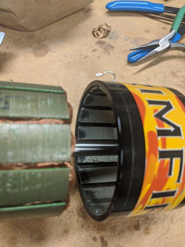

After landing a club member turned the prop over and commented that it was very tight and should turn over easier.
I had another motor and checked the two and sure enough the one in the plane was much harder to turn over.
I removed the one from the plan and took it apart.
The stator and magnets are obviously rubbing at the rear portion of the motor.
Did I cause this by overheating the motor with too much prop?
Or was this the reason it was getting hot in the first place?
Thanks for your input!

Looks like the motor can do 15S per the manual.
I put my other Rimfire 65cc motor in the plane and ran the same tests with the 24" props 12, 10, and 8 pitch.
At full throttle they all took about 10 less amps, 400 less watts, and all ran at about the same rpm as the old motor.
The temps were also noticeably cooler.
I did discover that the front bearings of my old motor have a fair amount of wobble. I will switch them out and see.

Like you indicated..... Bearing....
