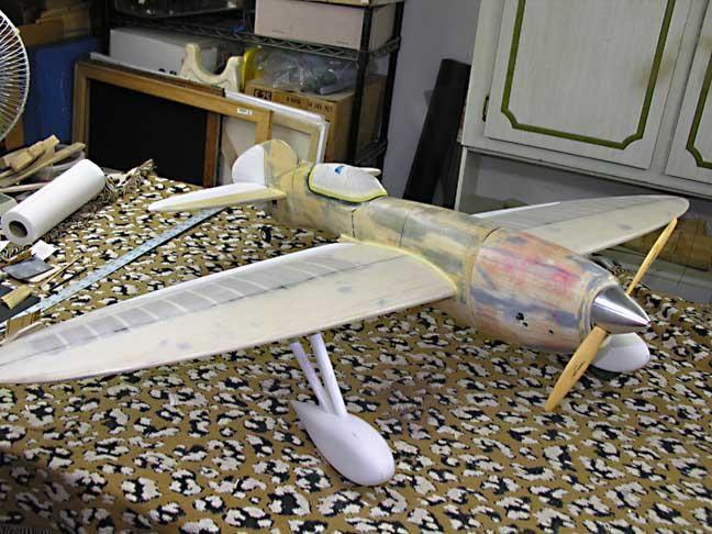

I'm giving up IC. A friend gave me a NIB Plettenberg 25-16. Lucky me! Or am I?
My model weighs 60oz. dry could go to 63oz. framed, painted and empty of all electrical gear.
So, with this motor and this model weight, what battery pack will work for a 6 minute flight?
C

Wow! what a quick reply!! Thank you.

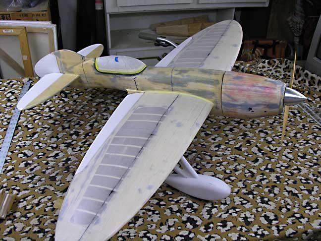

Safe ground clearance off grass is 14" off pavement could be 16". I'm looking for only a 5 minute flight because the model is for control line.
Obviously I'd like to keep the weight of the electrical equipment as light as possible. Eventually I can change to a throttled R/C set-up and do touch n goes. I was given a 5 cell battery pack also. It's a Prolite TP2800-25C. I have no idea if this battery pack can be used with this motor for a constant 5 minute flight. All I know is IC and model airplane graphics, after that, I'm useless, ask my wife.
Believe me, help is desperately needed. BTW, the model is 55" in span and has 570 sq in of wing area. Here it is with an IC engine in it.

Well first of all this motor has two things going against it.... One it's $224 New..... it would be a shame to nose it in and damage it since it's 4x more power than you need. A model of that size with the added benefit of not needing radio gear can use smaller motor/battery combo.
something like 300 watts would be more than enough to make that go @60mph? That fast enough? Get yourself a brushless speed controller to run a smaller pack. Most speed controls can be set to shut off the motor when the battery hits LVC (low voltage cut-off) so the lipo doesn't over discharge. Then we just run the battery capacity or propeller size based on flight time... or throttle setting. Set throttle on transmitter and set it down... airplane will run at that speed until LVC...
rcgroups.com should have an electric controlline section. I welcome you to take a look
