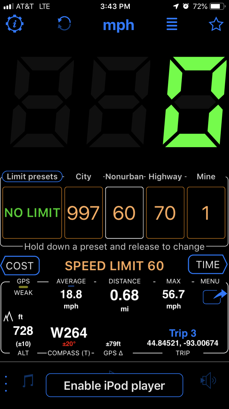

I have run about a dozen tanks of fuel through the new 3.3. So far Iím pretty impressed with it. It spins the Road Rage tides with ease. I wore out the rear set in 7 tanks. Even though itís still pretty rich, the idle is stupid low and stable, it revs nicely, and I can easily tell itís got a lot of power. It runs real consistently at 220-240F on 10% Nitro 14% oil fuel. Looking forward to adding some nitro and running it a bit leaner. Iíll get GPS readings each quart for a little extra stuff to have in my
notes about this engine.
Current setup: stock manifold slightly polished/modified & Resonator 2 chamber pipe with drilled stinger.
22/58 gearing, 10k diff oil. Running off-road gearing for breaking the engine in. Will go to 24/54 or 24/52 for speed runs. All Iím trying to do is do better than what Traxxas says the Jato can do bone stock (65.1mph on 33% nitro fuel). I am confident it will.

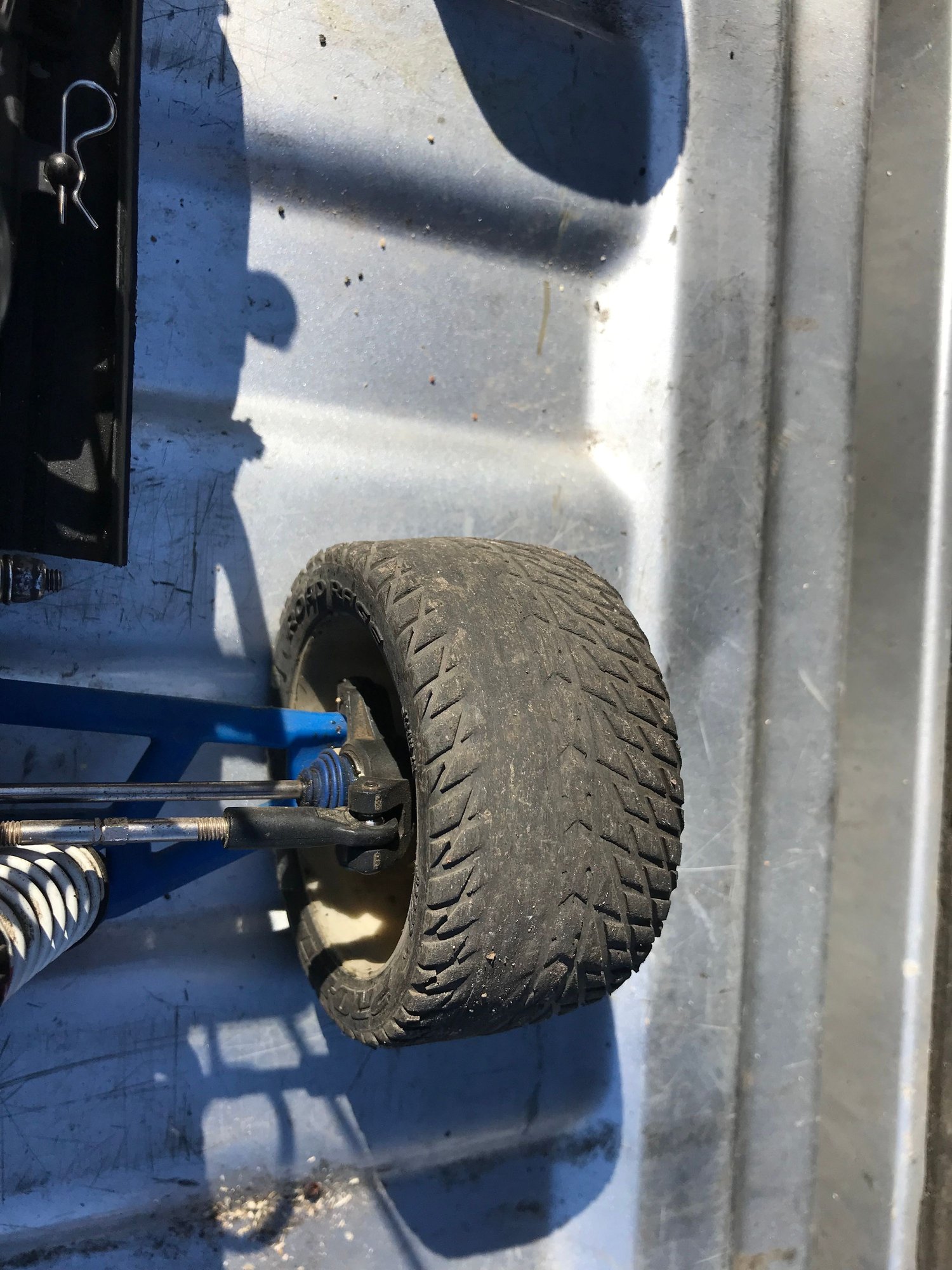

Since Iíve pretty much turned my road rages into drag slicks over the course of one quart of fuel, I opted to get a set of Jaco foam tires for my Jato. I painted the wheels and did a precision balance on them. This should give smooth high speed traction and help the squirrely Jato more planted. I need to make some suspension adjustments and I think adding sway bars will help quite a bit.
My first quart of break-in fuel is only 10% Nitro and 14% oil and after one quart of fuel so far, Iím really happy with how the engine turned out and is running. It spools up incredibly quickly and it idles down so low and stable, youíd think it was a Novarossi. Hereís a video I took the other day and a couple pics.

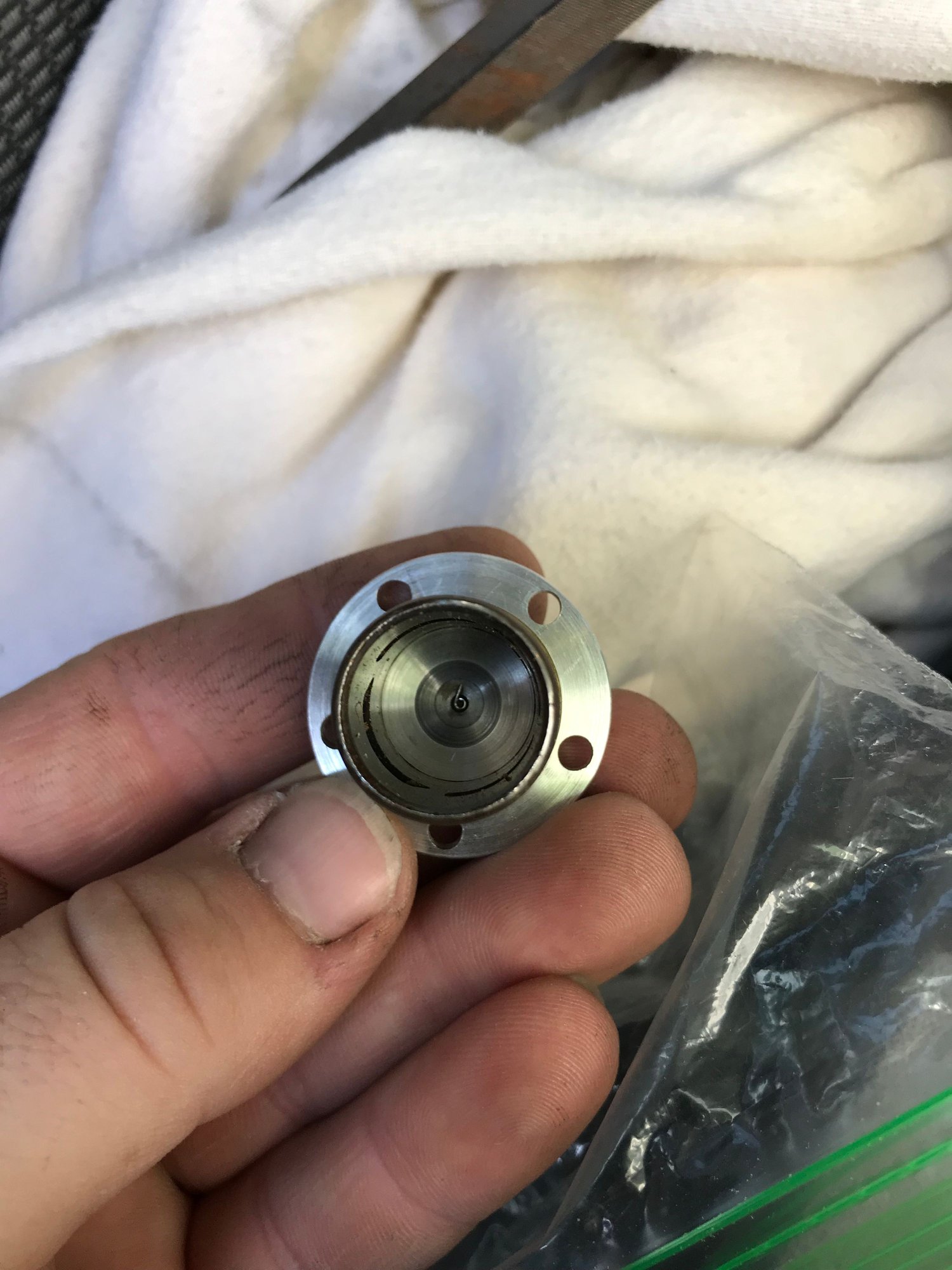

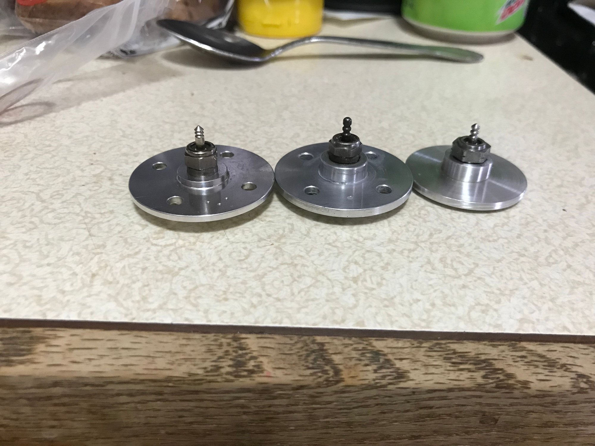

Hereís the head button a friend from Australia made for me fitted for Nelson glow plugs. Nelson plugs are cheap
and make the same power that Turbo plugs do. From left to right, standard plug 3.5cc Nova head, turbo plug 4.6cc Nova, and Nelson plug 3.3cc Traxxas head. The heatsink for the 3.3 needs to be cut and modified to fit the Nelson head button and then I can get it installed and tested. Should be interesting.

More progress. I goofed off at work and fitted the Nelson head button to a custom cut Traxxas heatsink. I needed to cut a 3.3 head/heatsink to fit a head button. Traxxas heads are one-piece. Next I had to cut the bottom of the heatsink to have a flat surface for the button to mate to. Then I needed to fit the button to the liner. I also needed to machine the glow plug hole in the heatsink to fit a 3/8” nut driver. The Nelson plugs have a 3/8” hex head. My friend who made the button machined the button 0.2mm larger in diameter than he was supposed to. So with a little work, that was machined down to fit and all is ready to bolt-on. This plug should allow for better power and smoother delivery up to 40% Nitro.

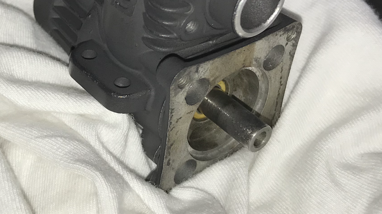

I forgot to add this photo. Apparently itís the only photo I took showing what I did. The backplate has a bronze bushing installed for the starter shaft to ride in. Bronze is a long lasting material that needs very little
lubrication to hold a seal. I decided to see if ball bearings would make any difference in how the engine performed, so I ordered some bearings from Avid. Due to the thickness of the backplate web and the bearings only coming in a 2.5mm width, I had to install 3 bearings together so the same space would be occupied within the backplate. If I did this again, Iíd get the flanged bearings for the inside of the backplate (Avid has them on backorder when I placed my order) and use the regular bearings for the middle and outside.
The engine runs runs really nicely and there are no leaks from the bearings, so Iíll have to see how this works long term. I have several more backplates, so I may do some more experiments.
