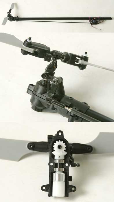

Posts: 304
Default Falcon 50 SE II REPORT -- Page 18-23 -- Tail Rotor
I hope everyone had a great weekend of flying???? I know I did.
So on with the project.
Page 18 ends with me putting the landing gear on, and begins with the assembly of the tail rotor. I found that the tail rotor was super easy to do!! NO errors anywhere in the instruction book on these pages.
Step 28 had me JB weld a locking ring to the back of the Tail Pitch Plate Assembly; I thought this was a nice touch to make sure this piece does not come apart.
Again, the instruction book is for both the Hawk and the Falcon, thus many of the steps on these pages I simply skipped over because they were for the hawk.
When it came to putting the Tail Rotor Grips together, once again I pulled out my gram scale. EACH Tail Rotor Grip weighed in at exactly 3.5 grams each. I also weighed the Tail Rotor Blades, the ball bearing, then nuts and the screws!! EVERYTHING was the same except for one tail rotor. IT WAS only .1 gram off from the other. I took some fine sand paper and scrapped off some of the excess plastic from around the rotor blade, and then I weighed them again. This time they were perfectly the same.
In step 31, when it came time to put the grips, thrust bearing, and blades (step 32) on, before I attached the Steel Tail Rotor Hub to the Tail Rotor Drive Shaft, I put the completed assembly on a blade balancer (airplane type), and it was perfectly balanced right down the center.
Step 34B was a little tricky, getting the Torque Tube Drive Shaft put into the exact spot, but I took my time and it went together perfectly. Don't neglect to use a little soft soap to help push it through like the instructions suggest.
Finally, I'm most impressed with the Bell-crank Assembly. EVEN this moving part has 2 ball bearing on it. AGAIN, my Nexus has plastic rubbing against plastic.

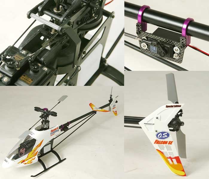

Default Falcon 50 SE II REPORT -- Page 24-31 -- Putting it all together!!
Well I'm almost done!! On the following pages I found no errors, and it was very simple and basic to follow.
BASICALLY, all I did was put it all together.
Myself personally, I don't really care for the sticker pattern on the canopy, but I did it like the instructions suggested. IT'S NOT THAT bad, but then again, it's a good reason to get a fiberglass canopy and have it custom painted!!!
IF you will notice in the picture, I went with the tail rotor servo on the tail. I also has an extra carbon push rod, so I put that on instead of the one in the instruction book.
Tomorrow, I have the day off, and I'm going to do some really cool pictures of it once I get the RX installed and it's ready to fly.
Flying pixs probably will not come till this weekend when I can give you a report on how it flys.
I ALMOST CAN'T WAIT!!!!!!
Any Questions???

Looks like it's coming along. Question:
I have the KSJ Universal Boom mount setup for the tail rotor servo. It sits the servo up higher to the boom than the one you have. Did you have any problems with the CF pushrod clearing the boom supports like I did?
Old 07-24-2002, 07:23 PM

IF it would have been 1 MM higher, I would have had a problem. But as it sits, the CF pushrod does not touch anything and moves freely.
The Boom Mount is the one I bought from Helicopter World, part No. CN 2239C
