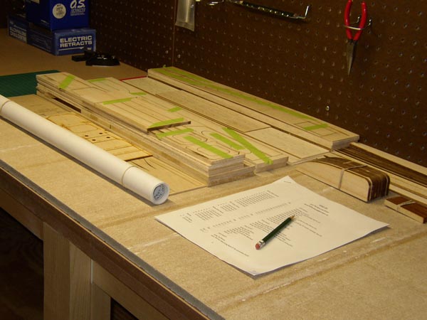

Hey guys!
Several months ago I was fortunate enough to become the owner of one of the first UFO .25 short kits hot off the presses from David(doxilia). I've been a bit antsy to get started on it and now is the time. Not sure how fast this build will move along since I plan to make my UFO .60 build the priority, so here we go!
This will be my first laser cut kit. The laser cutting looks very good and the wood weight/quality also looks to be very good. David also included a parts list as well as a list of materials needed to complete the model which will come in handy.
Power for this model will be an O.S. MAX .25 FX on a Macs 3.5 Quiet Pipe. Plus, ya gotta have retracts, right? E-flite .15-.25 size gear will handle that chore. Haven't settled on radio gear yet other than it will be Futaba. The finish will be film, most likely Ultracote.

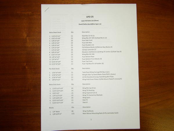

I started this afternoon by taking inventory of the kit contents and checked it against the included parts list and as I expected, it was all there.

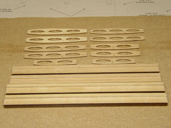

Generally I like to start a new build with the tail feathers, so I began by removing the stab ribs from their sheets. David had advised me early on that the stab ribs were meant to have building tabs attached but they were overlooked. Not a big problem! What I will do is to build the stab in the same way as the UFO .60 stab is built.
I took the provided leading and trailing edges and ripped 1/4" off of them on the band saw. Then a piece of 1/16" sheet balsa was sandwiched between these pieces using Titebond. They were backed up against a straight edge to keep them nice and straight. Once dry I'll sand the 1/16" sheet so it projects about 3/32" from the main part of the leading and trailing edges.
The stab ribs all have a nice center line burned down their length which will make it very easy to notch them to match the leading and trailing edges.

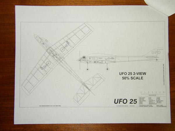

Teo,
A tad over 51" span and 56 oz (3.5 lbs) give or take. I'll post detailed specs later. There's also a thread with some info on the development and how the model came about - I'll post that too.
It should do very nicely on any good 25 on a pipe.
By the way, those aren't the actual build plans - just a 2-view assembly of them.
David.

RE: My Bridi/Oxilia Prototype UFO .25 Build
David,
Thanks for the information. You are right, they are not plans, I just did not know what to call the drawings. Hmmmm, just about the right size for a 3S or 4S electric...

Here's the original thread on the development:
http://www.rcuniverse.com/forum/m_9312876/tm.htm
Unfortunately RCU managed to break it so some images are missing and the posts are no longer editable to replace the pictures.
Here are the detailed specs. 50-1/3" span so just under 51" not over - thought it was closer to 52".

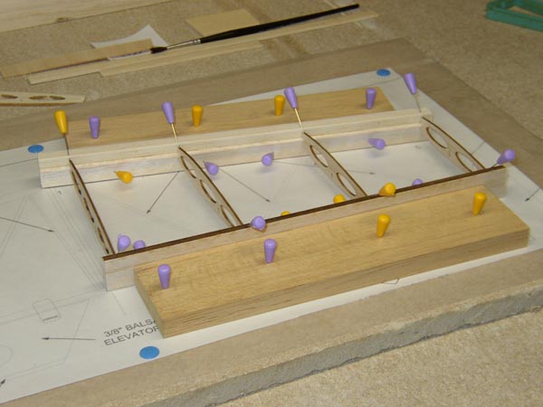

Made a little progress on the stab today.
I used a length of 3/32" music wire as a gauge to sand down the 1/16" balsa that was sandwiched between the leading and trailing edge pieces. The leading and trailing edges were then roughly cut to 1/4" or so longer than needed. Once cut they were pinned to a couple pieces of hard 1/2" balsa to hold them square to the plans.
The ribs were notched to fit the leading and trailing edges using a #11 blade. The handy burned center line on the ribs helped to make this an easy job. I was able to just eyeball the notches.
With all the lightening holes in the 1/16" ribs they are very fragile and I had to be very careful to not break one. I think this stab will end up being very light!

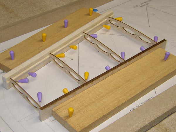

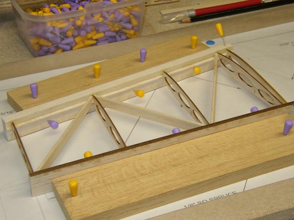

Had some time today so I added a few more pieces to the left stab.
First I made an angle gauge from a piece of light ply using the template provided on the plans. Next the root rib was glued and set in place using the gauge to to set the proper anhedral angle.
Next the 3/32" stab braces were made and glued in place. Since I went in a slightly different direction with the leading and trailing edges than what the plans call for, the braces needed to be notched like the ribs were. Since the ribs are already glued in place, one end of each brace had to have a corner removed to get it into place. When the stab is turned over I'll glue the corner pieces back in place.
I could have avoided having to remove the corners from the braces by putting them together at the same time as the ribs were attached. But I felt there would be less fiddling around if I had at least a semi ridge assembly to work with before adding the braces.
RG [8D]

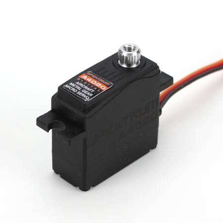

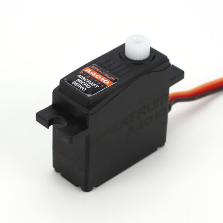

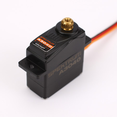

By the way, I know you are a Futaba man but Spektrum has come out with a nice lineup of servos - some of which would work nicely on the UFO 25.
I recently purchased some in the 3000, 4000 and 5000 series (and a couple in the 6000's). The last two are aimed at 15-25 size models and 25-32 size models, respectively. The 4010's look good for ailerons on the UFO 25 while the 5030's look good for elevator/rudder control with a 3010 for throttle. I will be using a very similar setup on another 30 size model.
Here are some pics of the various servos - unfortunately with no quarter for scale reference. Basically, they are micros (3000 - similar to HS65), larger micros (4000 - similar to HS82) and mini's (5000 - similar to HS225 although slightly smaller). The two 5000's look to be very good on paper, I will be trying them soon. They all come in specification pair sets with one having nylon gears and the other metal gears. The four 3000's series are geared for speed (3010, 3020) or torque (3030, 3040).
David.
