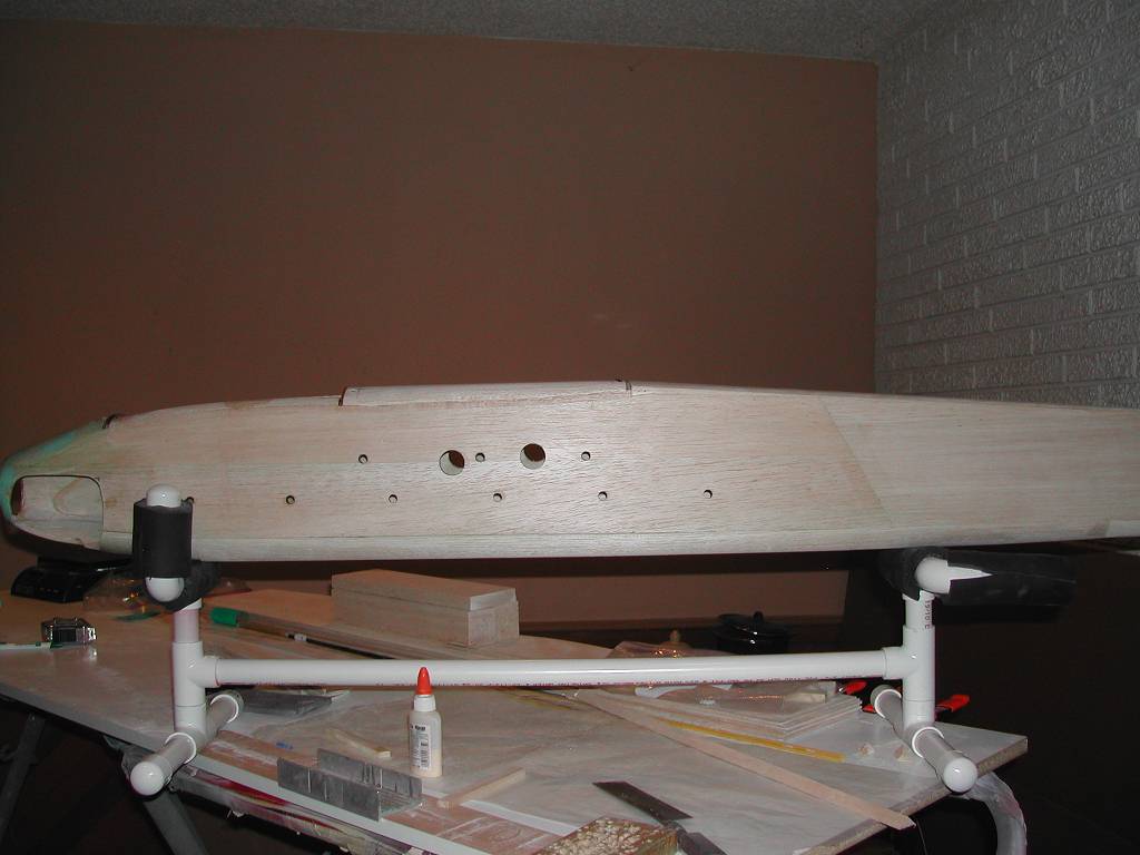

FUSELAGE:
As you can see from the photos, I used Titebond to glue the thin ply doublers to the balsa sides. If you haven't gotten the message yet...DON'T DO THIS unless you have a complete set of encyclopedias to use to keep them pressed in place...then still don't take the risk. [8D] In all seriousness, my doublers weren't all that bad, but it took additional gluing, and it was irritating. Use a drier method.
The fuselage pieces fit together very precisely...it was a pleasure.
The doublers automatically set the angle for downthrust and sidethrust. Be certain you glue the correct doubler on the correct side, (and for that matter, the inside of each fuselage side)...nothing like realizing too late that you have two "left feet". I added the bulkheads to the right side, and left room for triangular bracing for each bulkhead...it's what I do..I think it provides more strength.
There is nothing fancy or difficult in these steps. Personally I added pieces of extra bracing here and there as I saw fit. You may or may not want to do the same. Here are a few additional points you might want to think about:
1) Draw a centerline on each bulkhead to help insure that the fuselage is straight. Jeff provides holes on the fuselage sides to help with the alignment. I didn't personally use them.
2) One thing I DID do was to use the small wing dowels provided to make sure the doublers are accurately aligned, (see photo). I found this worked pretty well for me. There is nothing quite as aggravating as not having the wing dowels precisely fit the alignment holes later on.
3) I used cross braces across the fuselage top and bottom to provide some additional strength/ridgidity.
4) As Bill already stated, the best time to drill all your firewall holes is BEFORE it is installed.
5) Once you get the bulkheads in place on one side, build upside down on the flat top surface of the fuselage. The fuselage is joined at the tail, (and cross braces installed), after the primary bulkheads are all set up and dry to make sure nothing gets out of alignment.
6) When it came time to join the fuselage halves at the rear, it appeared to me the fuselage was a bit short when bent to join. I added an extra piece of balsa at the rear as the picture shows to get the proper length. This also provides a nice surface for the rudder hinges to anchor to. I may have the most "beefed-up" rear joint of any Simla in existance.
Because I didn't cut out the elevators after building the stab, but instead built them up conventionally, you can see where I needed to add a small wedge of balsa at the rear of the stab cradle. I HAD to build my elevators separately because the stab ribs were too short in the prototype, but if you should choose to build your elevators separately, this is the procedure you'll follow to fill this area. It all works out the same in the end.
For you beginning builders...nothing to it...right? Just take your time and make sure everything is straight and aligned. More to come.

#120
REVISED:
Assorted pictures of the fuselage details. Some of these photos are Kevin's. We live 20 minutes apart, and got together a few times to compare notes, and work on "stuff". In the pictures of the fuselages together, Kevin's is on the right in the "upright" photo, and mine is one the right in the "inverted" picture, (it is truly remarkable what sanding does to transform the fuselage). Wait 'till you see the upcoming pictures before the top, side, and nose blocks are sanded!!
In the pictures of the engine compartment, Kevin and I both chose to build ours with the engine compartment open like Ed did. As mentioned earlier, the plan makes provision for either an OPEN or ENCLOSED cowl area. In the corners you will need to add pieces of filler balsa...even so, there are places where the balsa is pretty thin in the corners...especially if you go for a "sleek" look, (which I did). Hold the nose up to a bright light, and watch for this possibility if you want a sleeker look.
Admittedly, I did a great deal of final sanding, taking as much off as I could to give the leanest, sleekest look I could on my prototype, especially on the top and bottom nose blocks. You will notice in the balsa, (unfinished) side view up above that the plane has a decided "Taurus" look to it, and it needed to be more slender. After that early picture was taken and I studied the side view, I "sanded the heck" out of the nose blocks to try as much as possible to achieve this more "Simla" look.
In the final plan revision, small changes were made by Jeff to narrow the nose section, and give that more "slender/sleek" look to make it look more like the Simla, and less like a large Taurus.
About the open engine compartment, I had never done this before, and originally was against the concept of "letting it all hang out", but I really warmed to the idea as time went by. I really like it now, and hardly even think of it, it's quicker and easier to build, the engine and nose gear is easy to get to, and best of all...it's the way Ed did it.
More to come.
Duane
More to come.
Duane
