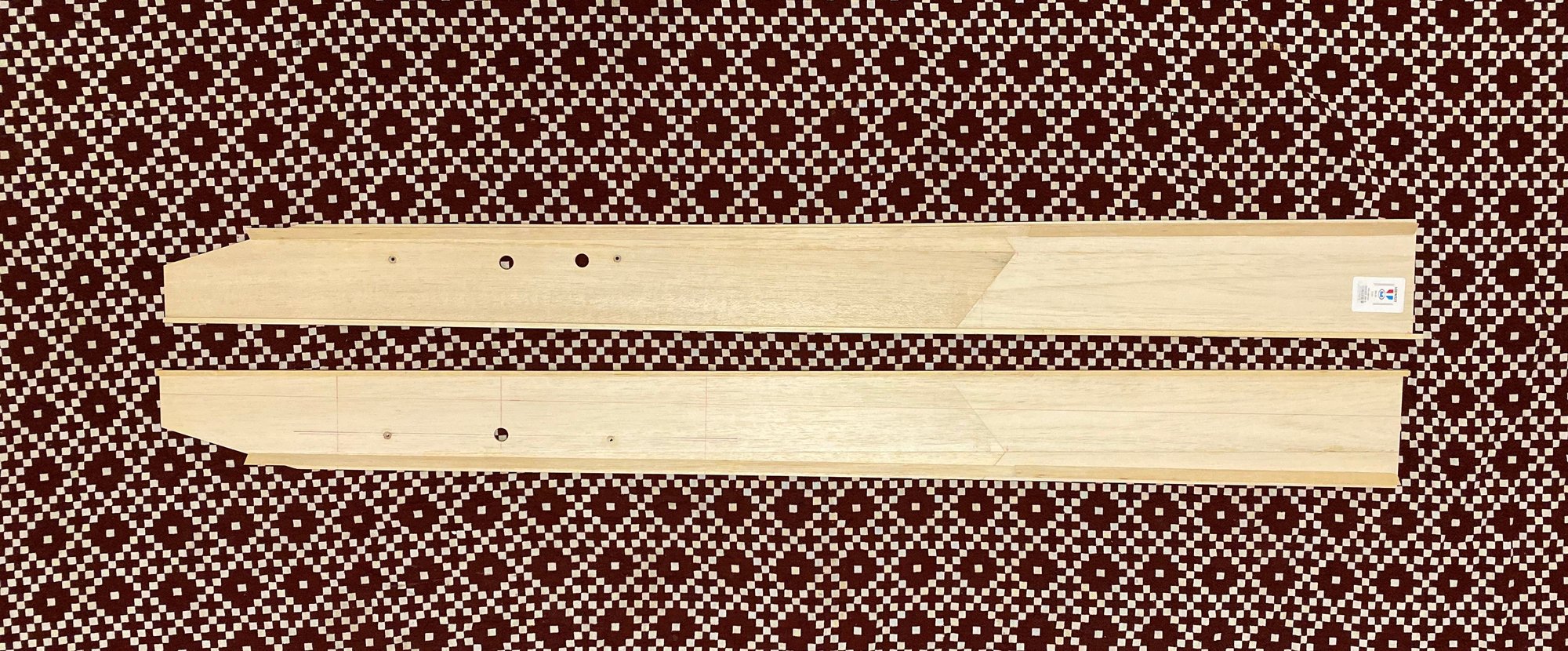

Not sure if it really helps in reducing weight, but I had enough time, so why not to do that?

More improvements ...

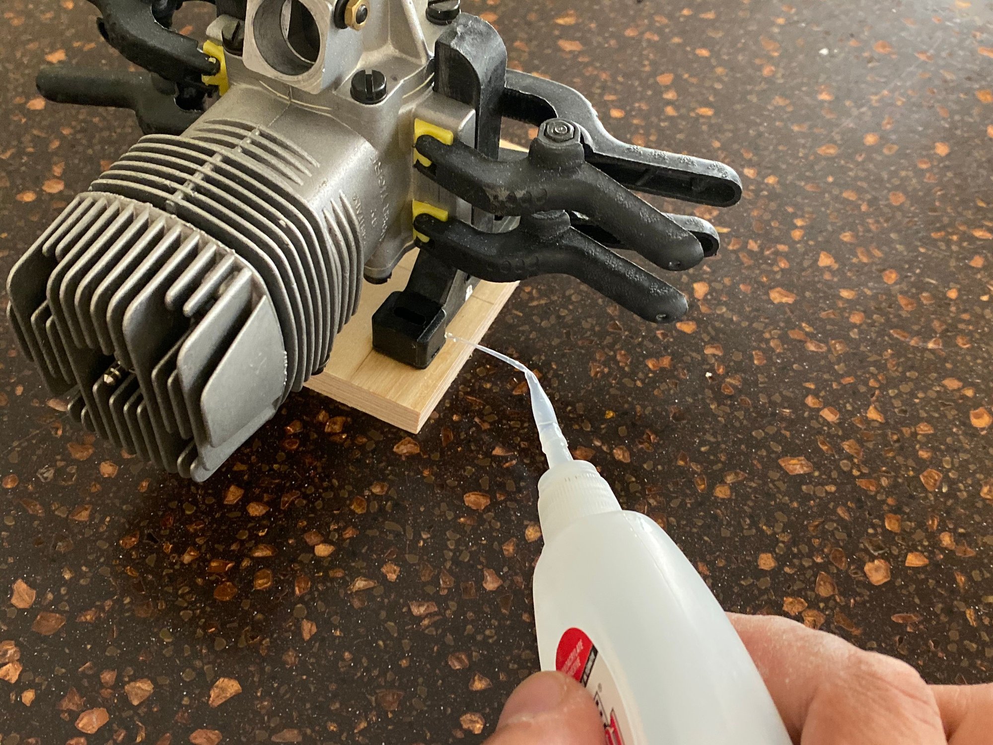

I always use 100 gram glass cloth and some epoxy to reinforce sides and joints, it’s much lighter and easier than plywood doubler.
Making the firewall by laminating three pieces of 5 ply 2.5 mm plywood.
Using some CA to tag motor mount on firewall, then drilling screw holes.
