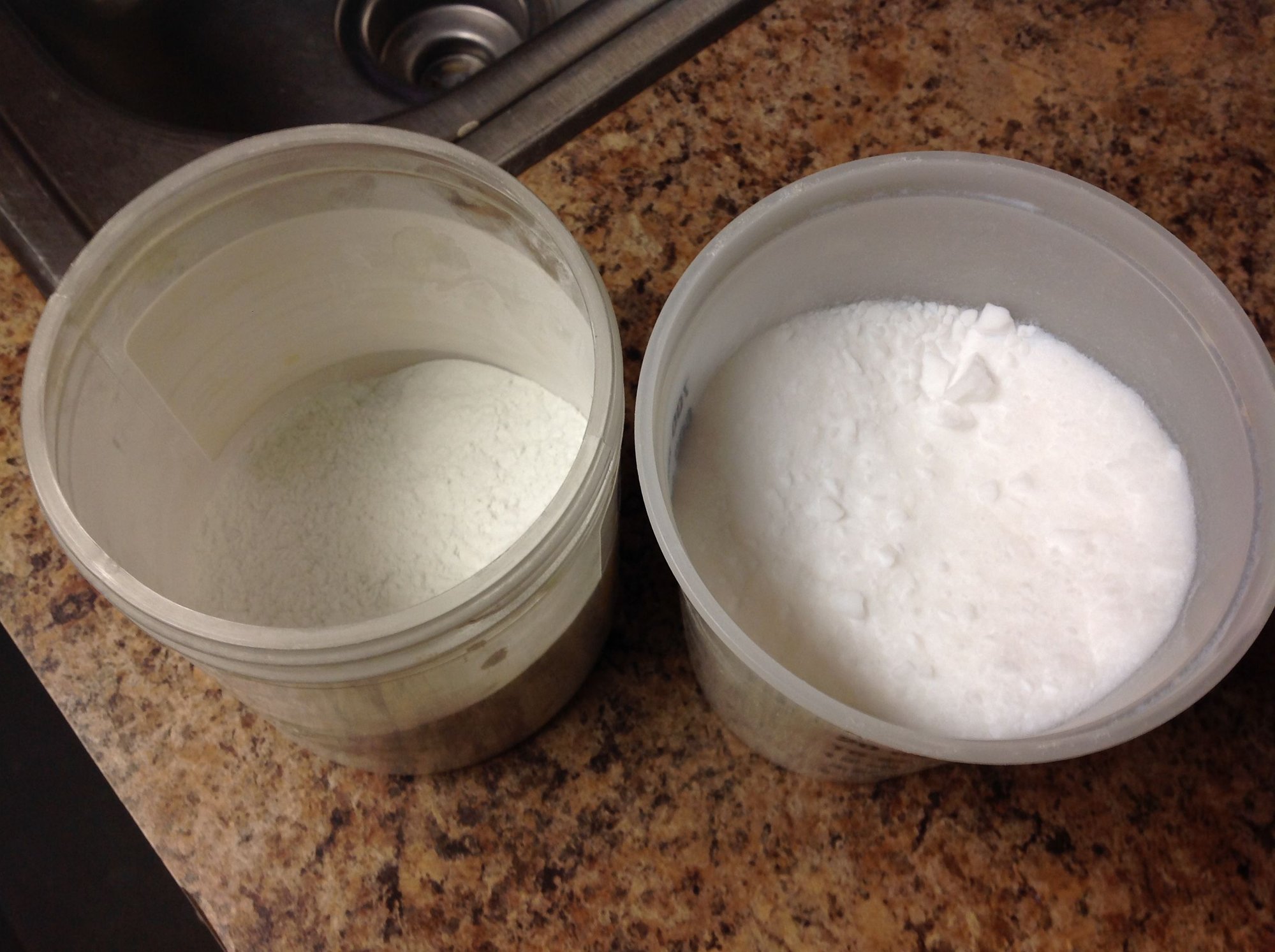

On the subject of mixing fillers to laminating resin to replace " minute epoxy " here are a few pictures. The first are a couple of my primary fillers, milled fiber and cabosil. These two are mixed 50/50 into the resin to the consistency of tooth paste. Great for high strength bonds/filling. For a mix that doesn't require maximum strength but easier sanding is desired mix 50/50 with cabosil and micro balloons.
Milled fiber on the left, cabosil on the right.

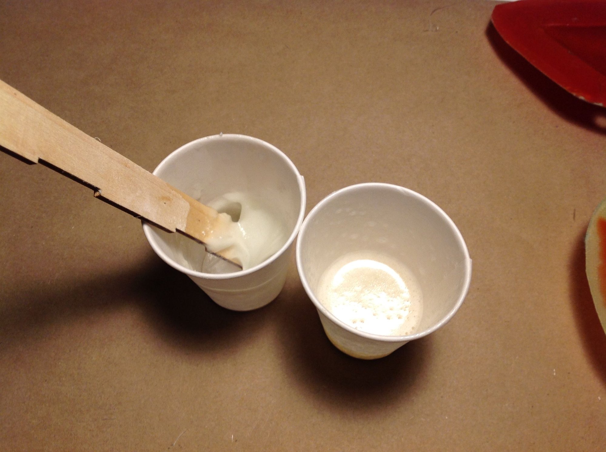

Two mixes, the one on the left has the milled fiber and cabosil added. To the right mixed resin with no fillers. Notice the bubbles, I mix very thoroughly, a good mix is just as important as proper ratios.

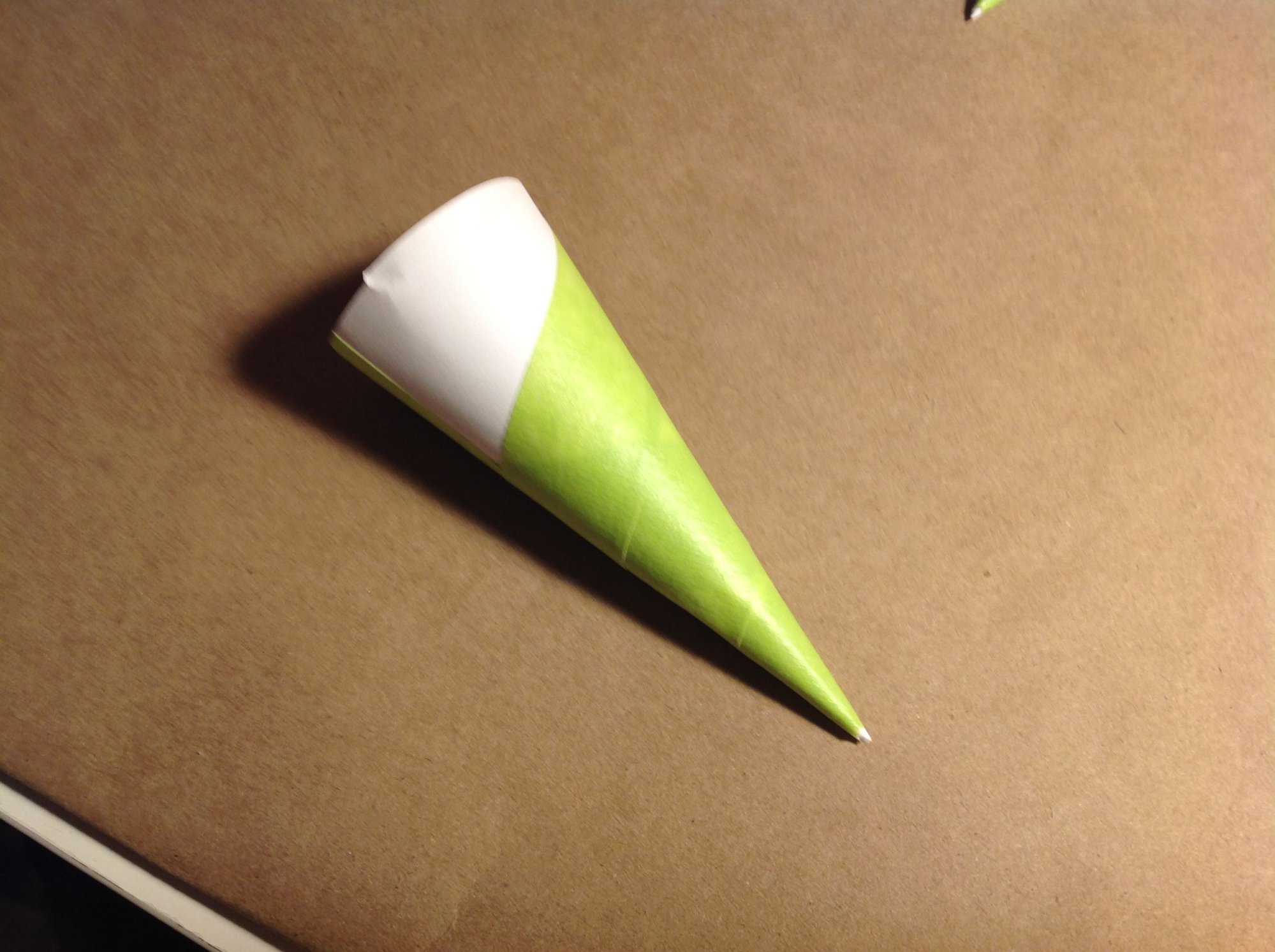

The paste usually goes into a paper cone for dispensing.

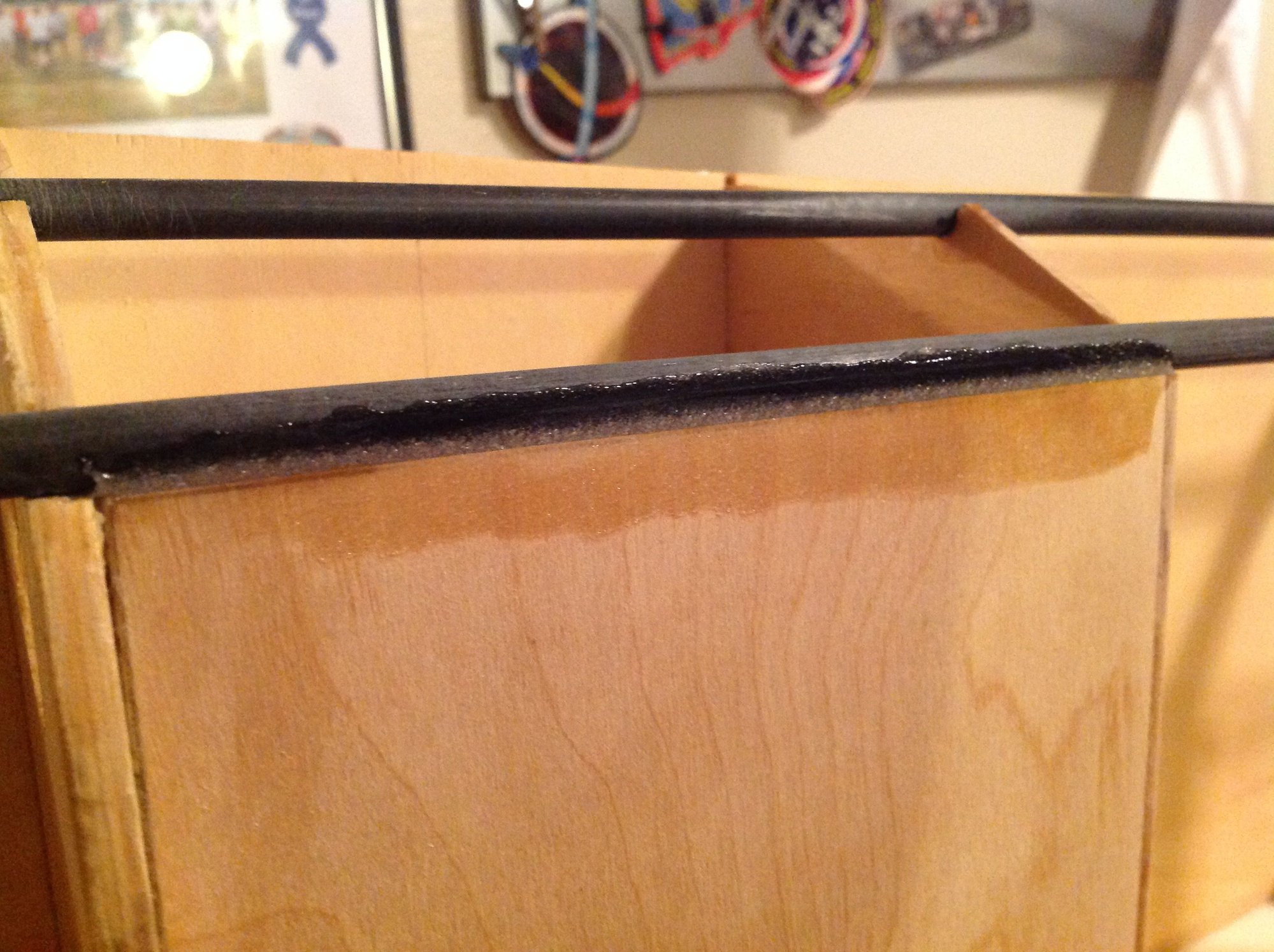

A joint filled with the paste mixture.

Adding both milled fiber and cabosil: The cabosil keeps the mixture from sagging, without it if placed on a vertical surface it would most likely run. Of the three fillers I use, milled fiber is the heaviest, then cabosil and then Micro balloons. The strength profile is in the same order. The filler choice is dependent on the strength required. Most times it is cabosil and milled fiber just like this picture of a landing gear plate being bonded into a fiberglass fuselage. As far as weight is concerned, using the method gives me a slight weight reduction due to being able to use less adhesive then if I were to use straight 1:1 " minute epoxy ".
