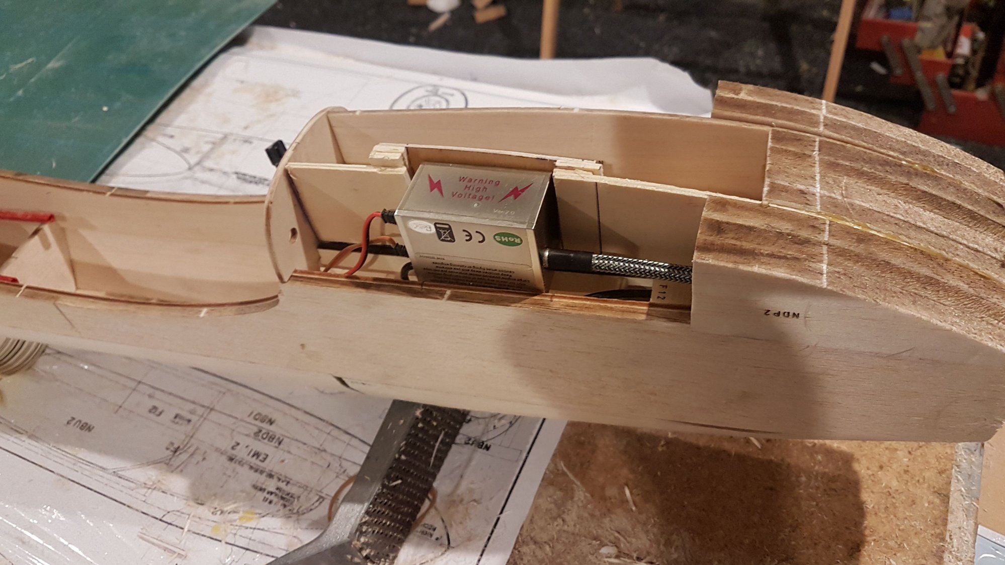

of course i also need to work out where to put the ignition module. It should fit here with a minor reshape of the nose but hopefully won't be too obvious.

I also decided to build in the ignition module. I've never had one fail before so hopefully I don't regret this now!

Whelp.... finally summoned up the courage to fully build in the ignition module. In an attempts to not carve a hole in the block, i traced a black line around the bottom edge. My idea being that when i see black when sanding it's time to stop!
