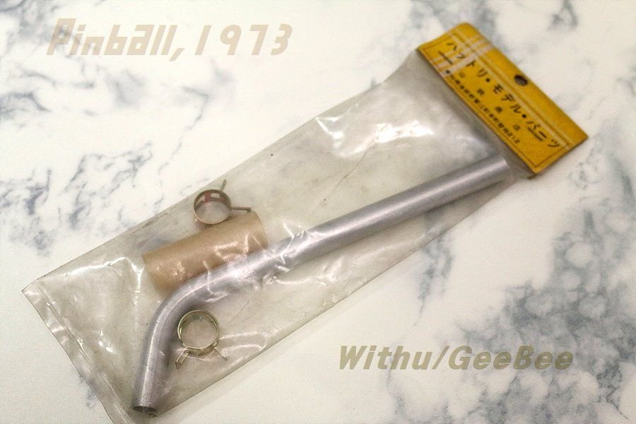

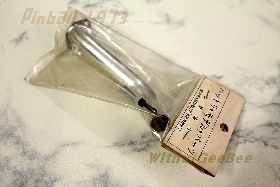

Rear exhaust kit is very rare in 20 class.
Creation 25
Creation 25

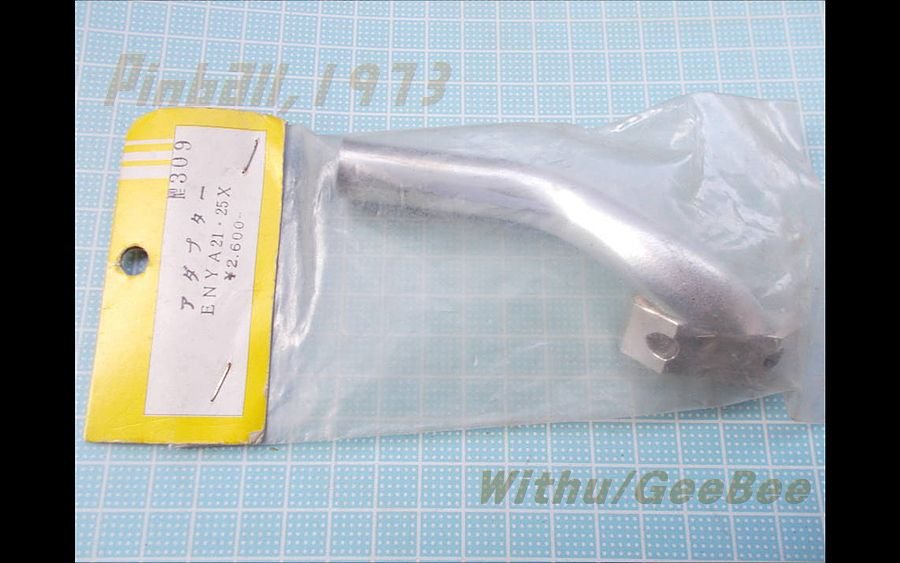

custom made Arrow 20 It is not on the market.
Hatori engine header for Arrow 20
MK SKYMASTER 20

I found this kit long long time ago at old local hobby shop,
fortunately I already had hatori header for MK SKYMASTER 20.

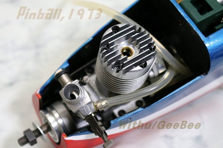

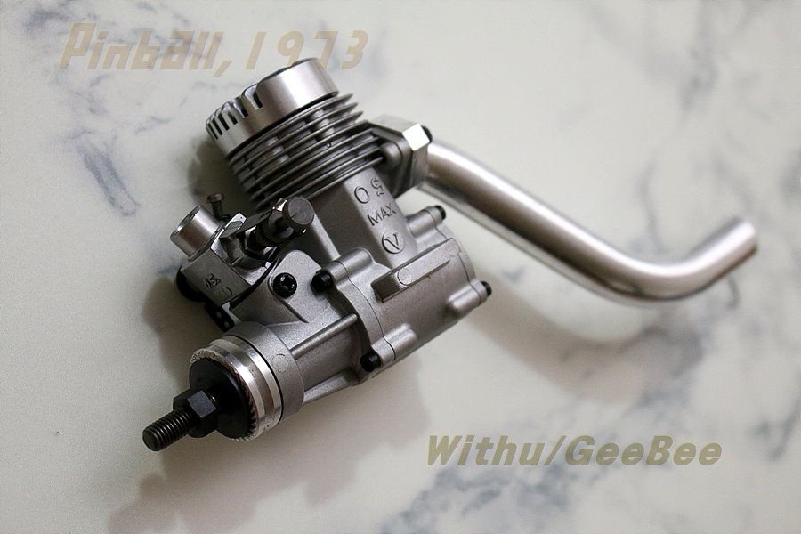

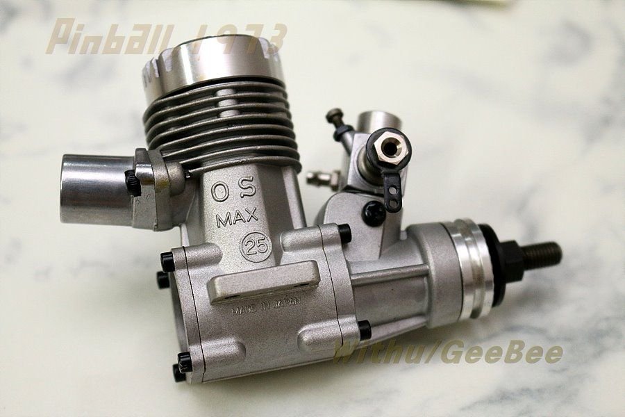

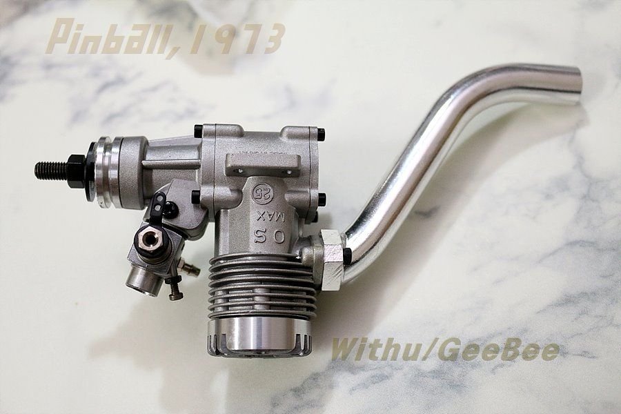

Preparing parts for MK SKYMASTER 20.

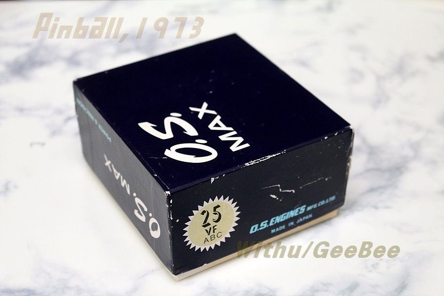

OS 25 vf abc
OS 25 vf abc
OS 25 vf abc

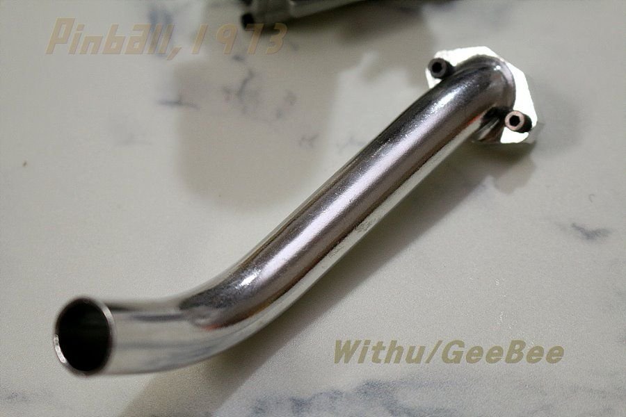

HATORI header for MK SKYMASTER 20
tail pipe for 20 class

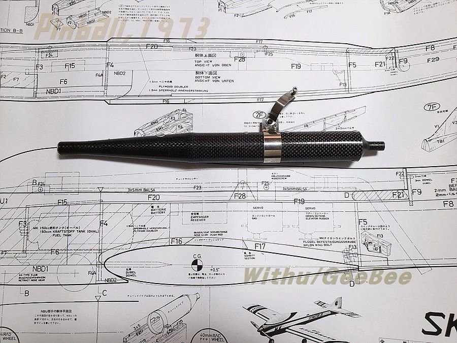

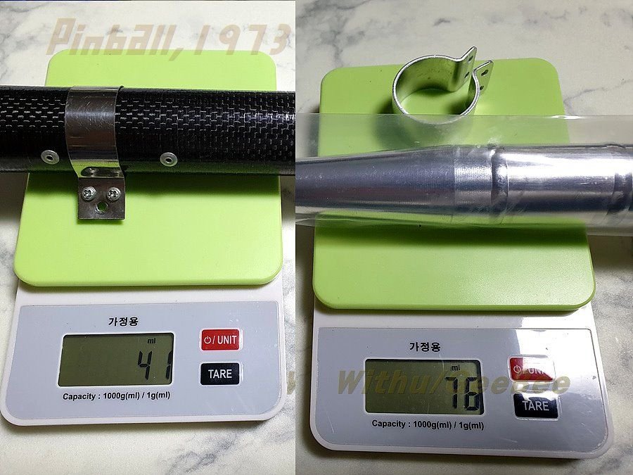

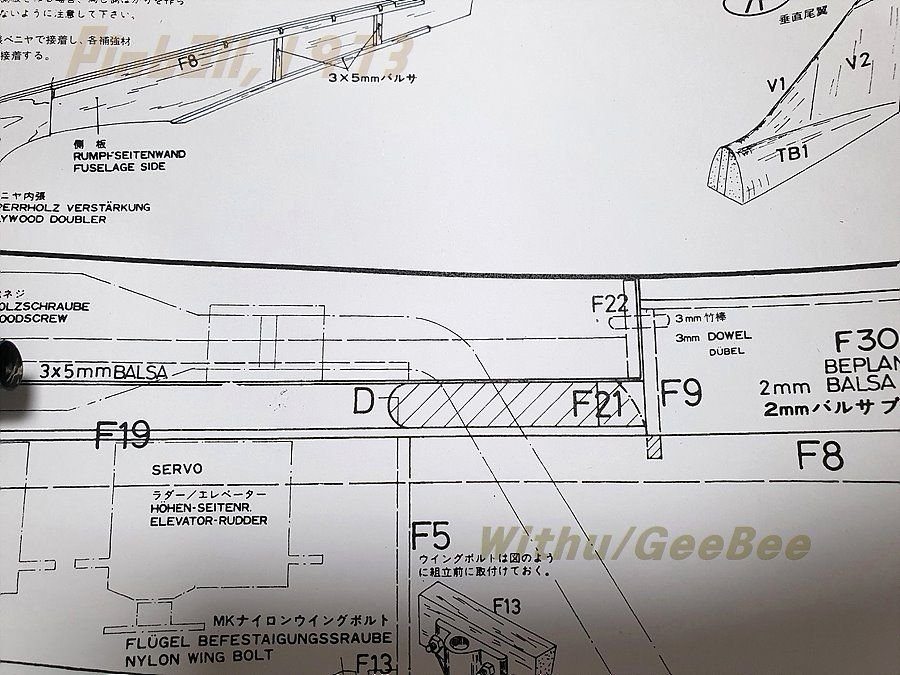

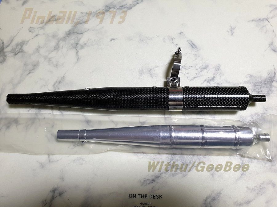

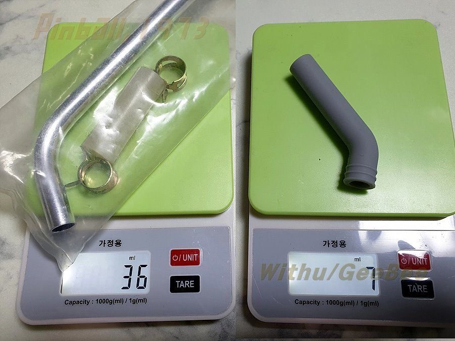

Rear exhaust parts for SKYMASTER 20
ASANO carbon pipe & HATORI tuned pipe
ASANO CARBON PIPE + SILICON TAIL PIPE = 48 g ( 1.7 oz)
HATORI TUNDE PIPE + HATORI TAIL PIPE = 112 g ( 3.95 oz)
I had no choice.
But the carbon pipe was little longer for skymaster 20,
so I decided to drill a hole in the part F21.

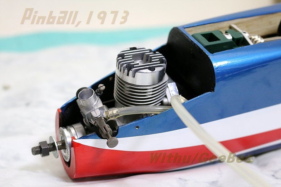

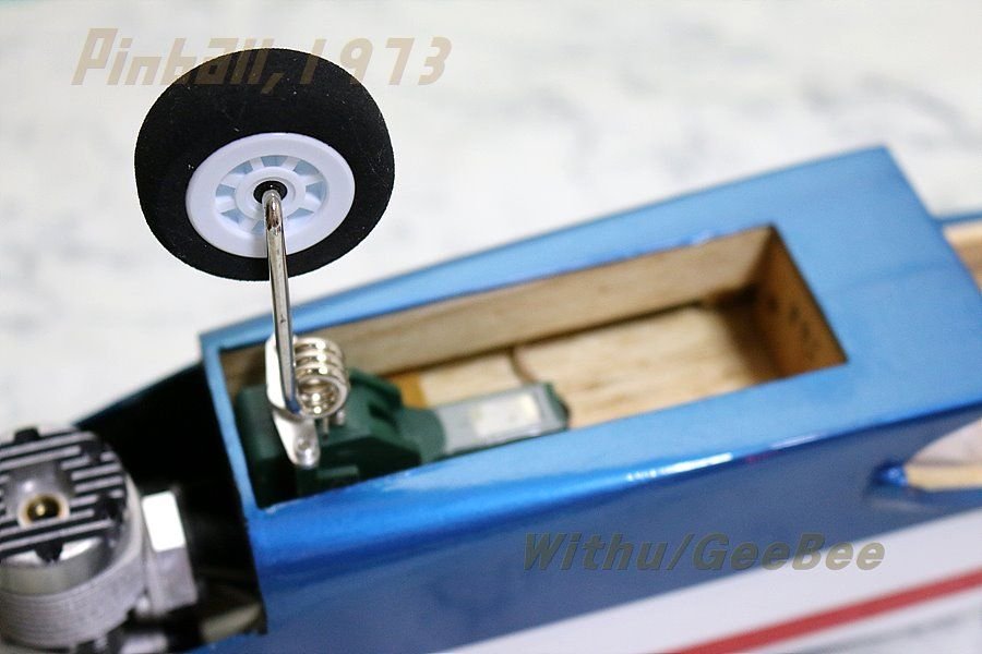

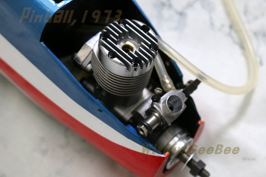

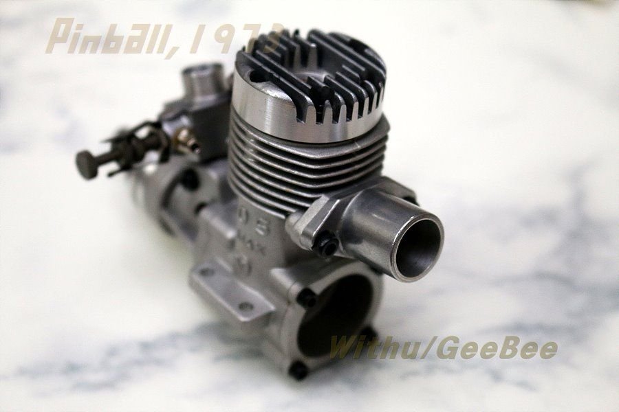

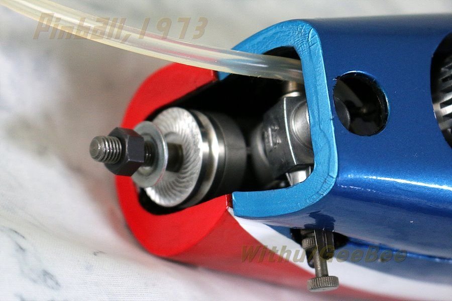

Default engine & nose gear
OS 25 vf abc
really beautiful.
OK PILOT MODELS TAHMAZO ELF NOSE RETRACT GEAR with MK wheel
Operating Voltage: 4.8V ~ 8V
Operating Voltage is very important for reducing weight, because i will use 7.4V battery.
