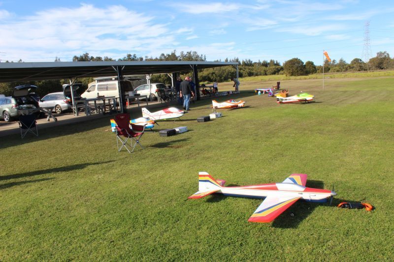

Thought I’d bump this thread up again
Took my Lotus 5 out a few weeks for a fly with the OS61 Hanno and Bolly EQ63 pipe (12.5x11.5 Bolly prop, 10% nitro).
Flew brilliantly! Beautiful engine and combo with this plane. Always looking for spares just in case.

Please stop posting those pictures. You're making we want to clean up my SlingShot and give it a run.

that’s a stunning Slingshot as well!!! Still got it with the Hanno? That VH number is a low one!! Very nice

Yes, I've been in the game for a few years now. Was about 7.25lbs at the time, super light and I wouldn't do a snap roll with it anymore. Still with Hanno, but the pump has 140RX pump swap. It's still running on the replacement piston/liner after the original peeled but it doesn't run very often. I did get one of those Jett piston/liner and two of the ones from Graham Gardener(?).
I probably should have jumped into the pump kit that was being offered a while back, but it's really been tucked away out of sight out of mid...
