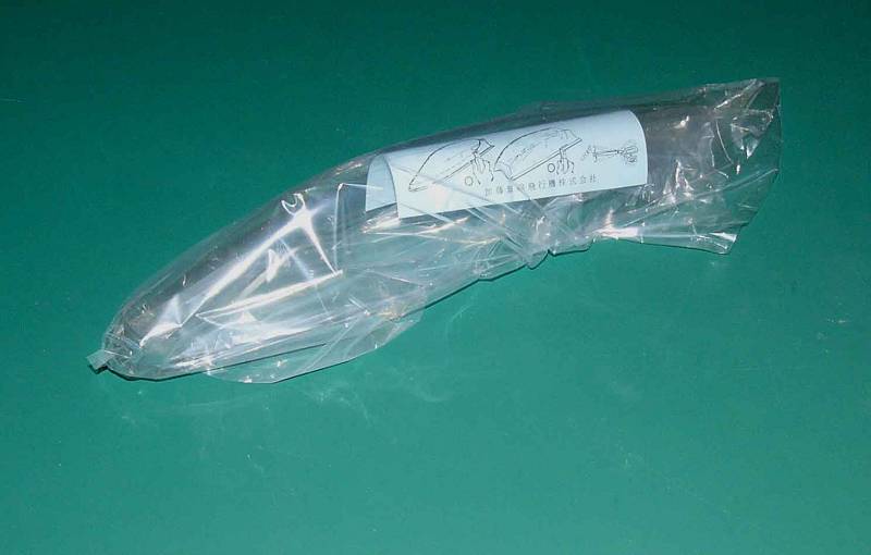

8178 gave me the task of copying Ron Ellis's Blue Angel canopy for his build and he suggested I do a thread on it. Bearing in mind that how I plan to copy it has not yet produced a plug from which I can vacuum form useable canopy's I'll document the process as I proceed.
Ron sent me his MK kit canopy which just might be the last one in existence. And that carries a responsibility to use a process that will minimize the risk to it.
Here's the plan:
1. make a silicone female mold of the MK canopy (two reasons for using silicone are that the cure process creates very little heat which is less likely to warp the original – the second reason is that the mold silicone doesn't adhere well to much other than itself and Vaseline works well as a release for it).
2. make a male vacuum form plug using the silicone mold and urethane resin (plaster could be used but I have urethane casting resin on hand and I'm familiar with using it with silicone molds)
3. prepare the urethane plug and start pulling canopy's.
To be continued.

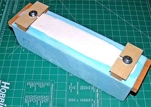

Before attaching the canopy to the plate I first glued the stopper for the rear of the canopy in place. Then the canopy could be set on the plate and – once centered – a pencil line was traced around the outside.
A rather large gap on one side of the canopy precluded using canopy glue (the gap was the result of the factory being a bit careless trimming the canopy). So a mix of slow set epoxy, fumed silica and micro balloons was used, mixed to a moderately thick consistency. In the area of the gap the thickened mixture was stiff enough to fill easily. A couple of pieces of tape held the canopy down lightly. (Ron will be happy I managed not to leave any epoxy prints on the canopy!)
After the epoxy had set, I noticed a small gap at the rear that had not been filled, so a second small batch of epoxy solved that problem.
To recap, the epoxy's function is:
* to hold the canopy in position (very little strength needed for that)
* to seal and fair the edges of the canopy so the silicone won't get trapped in an undercut

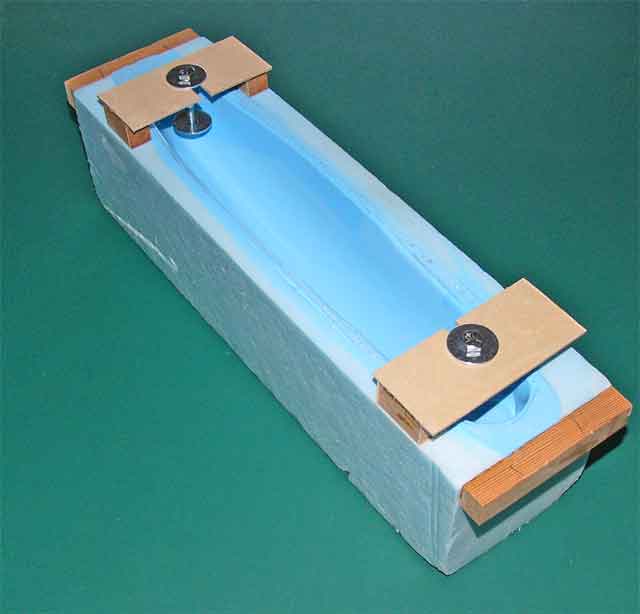

To the ends of the foam 'box' I epoxy'd on scrap pieces of wood that will be used to support the ends of the canopy holder. Two slanted troughs were added along one side to allow topping off the silicone since the canopy holder covers most of the cavity.
The canopy was then coated with Vasoline which was buffed smooth with a soft towel. Vasoline was also wiped over the filler block at the back of the canopy – as thick as the silicone is, it will key into the wood pores and I didn't want that to happen on a part that has to slip out of the mold vertically!
Finally a couple of pieces of double sided 1/32" foam tape were attached, one at each end of the canopy frame, to hold it in place on the wood strips while the silicone set. (Since the canopy will be filled with water there is no tendency for it to float and so the tape just needs to hold the canopy centered in the cavity.)
Finally it was time to mix and pour the silicone. Two batches were used, each with about 6 oz of material. The first batch was poured into the cavity and most of the second. Then the canopy was lowered into it and water added to the inside of the canopy until it was full to with 1/16" of the top. Silicone was added via the troughs until the cavity was filled to top.
Then all one can do is sit around and wait.
If you haven't used this stuff, it's thick, slimy and very messy to handle. On the other hand it forms around almost anything and will replicate #600 sanding marks perfectly. And it releases mixing bubbles very well in all but areas where they can't rise to the top.
It's a curative silicone – as opposed to the hardware stuff which is a condensate silicone – and uses a curative additive. It's pure white and the curative is deep blue, which turns it a baby blue color when it's well mixed. Pot life is about an hour and it takes at least 24 hours before de-molding.
There are a lot of formulations on the market for mold making silicone, some with widely varying characteristics. I use a Silpak product I get from Fiberlay which is a local fiberglass retailer. It's farily stiff cured, yet has a lot of give without breaking. This makes it easy to get molded parts out of it that wouldn't be even close to possible with rigid molds.
Neat stuff.

Success!
I parted the canopy from the mold with my usual anticipation. As with any molding job like this with deep, steep sides, getting an initial movement of the plug (in the case the original canopy) is the hardest due to suction. A steady prying from both ends and the canopy came out quite easily. (The best process for parting rigid plugs that are having trouble coming out is air pressure by the way – but that was not an option here.)
The canopy is in perfect shape and the mold is just fine.
Next step is to cast a canopy plug for vacuum forming

Before casting the plug there's one more thing to do – I need a couple of 'handles' to help pull it out of the mold. The idea here is to embed 2 cap screws with nuts and washers in the plaster. When the mold and plug are apart, the cap screws will be unscrewed, leaving the nut and washer inside the plug.
I made temporary supports out of wood from my scrap box for a couple of 1/4-20 X 2" cap screws to be suspended over the mold. The slotted holes in the cross piece will allow each support to be slipped out from under the bolts when the cast is set (otherwise I'd have to cut them off the bolts – been there, done that!). The threads above the nuts were coated with Vaseline to help them unscrew later.
The picture gives a better idea of what's being done than the description.
Now it's time to cast the canopy plug for vacuum forming.

The mold has been filled with Hydrocal plaster and is busy curing.
More waiting!

This morning I removed the plaster casting from the mold. It came out quite easily using the embedded bolts as finger grips.
The plaster has to dry until it feels dry to the touch before prepping it further. Then I will remove the bolts, sand the base flat and dress the edges. I'll also need to fill a couple of bubbles that appear to be the result of my not having mixed enough slurry on the first pass. (I knew what the volume of the canopy was from having filled it with water during the making of the silicone mold. What I forgot is how many ounces there are in a cup when I was mixing the plaster. So I didn't mix enough and had to add a second layer. Rookie mistake!)
Overall, the plug looks good and should be ready shortly to make some canopy's.

The pull bolts came right out without a hitch - they were finger tight . However the plaster took longer to dry than expected. And the mistake that caused me to have to cast a second batch of plaster resulted in the base of the casting having lots of bubbles in it (I suspect some of the water in the second batch was absorbed by the partially setting first batch which didn't allow it to expel all the bubbles produced by mixing).
When I cast the plaster I filled the mold as high as possible even though the OEM canopy had some extra material at the base. This left a flanged area that is now faired to the basic canopy contours. And the bottom has been planed fair. A Sureform file was used for basic trimming, followed by final sanding. At this point only a couple of tiny bubbles remain to be filled with spackle.
(The lightweight Hydrocal I bought for the project when my old supply of regular didn't look good is softer than I would like. So I'm going to put a coat of thinned polyester resin over the surface to help protect it against 'hangar rash'. Polyester is the better choice vs epoxy because it has better heat resistance and sets faster.)
Despite these minor irritations, the plug should work just fine.
