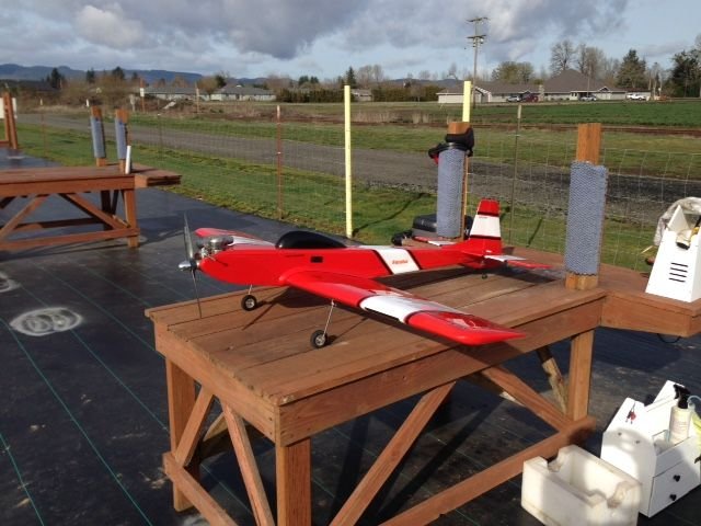

I was fortunate to pick up a sweet Kaos from a buddy at the field who felt the Kaos was way beyond his abilities. He wanted a nice used Saito 82 that I had, so we made the trade which was a steal for me. Looks like a scratch built Kaos, with an Enya 60, and in tail dragger configuration. Flies great as you all know, like on rails, but it looks about as thin as a pencil when flying by low and fast with wheels up! I have had some probs with the retracts location causing the plane to nose over on landings in the grass. I have shimmed the back edge of the LG mounts so as to move the wheels forward when down. So far the shims are about 1/8" thick! If the prob continues, I might have to put on larger wheels which will require enlargement of the wheel wells, an idea and task I am not thrilled about. Whoever did the original build must have flown from a runway other than grass.

Looks Nice!!! Yeah they look like TINY wheels for grass.. Move your model tables to the grass and fly from where they are!! I have the exact tote you have. Two drawers, the battery and starter holder come off the main tote.

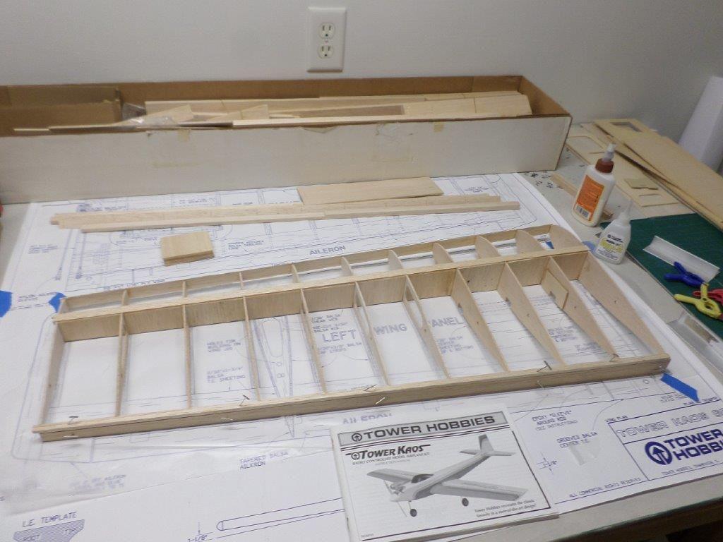

I am starting my Tower Hobbies Kaos 60!!
First question. The last Kaos I built was not a Towers Kit, I believe it was the Great Planes. That kit the wing ribs had tabs on the back of each rib to keep the wing straight. As can be seen from the photo this kit the ribs are, well, just the ribs. It mentions the holes are for using a wing jig. I don't have one and have never used one. Is it better to use one or can I make measurements and support the back of the wing in several spot to keep it straight? And if you suggest a wing jig, it is as simple as making one out of wood clamps on the ends and "What do you use for the rods"??
The manual for the build... And the plans title section with a wing rib... See the holes for the jig... Should I use one????

I've built a Kaos wing with tack-glued stand-offs to hold the ribs "level". Laying the rib on graph paper helps speed up the process of properly positioning the stand-off. Space the stand-off far enough away from the trailing edge to allow installation of first, "bottom" pieces of TE sheeting while retaining the stand-off.
Also built a wing with a jig. Examples in the attached link. Rods can be 1/4 inch diameter music wire, fiberglass shafts or carbon-fiber shafts. Need high stiffness to avoid sagging in the middle.

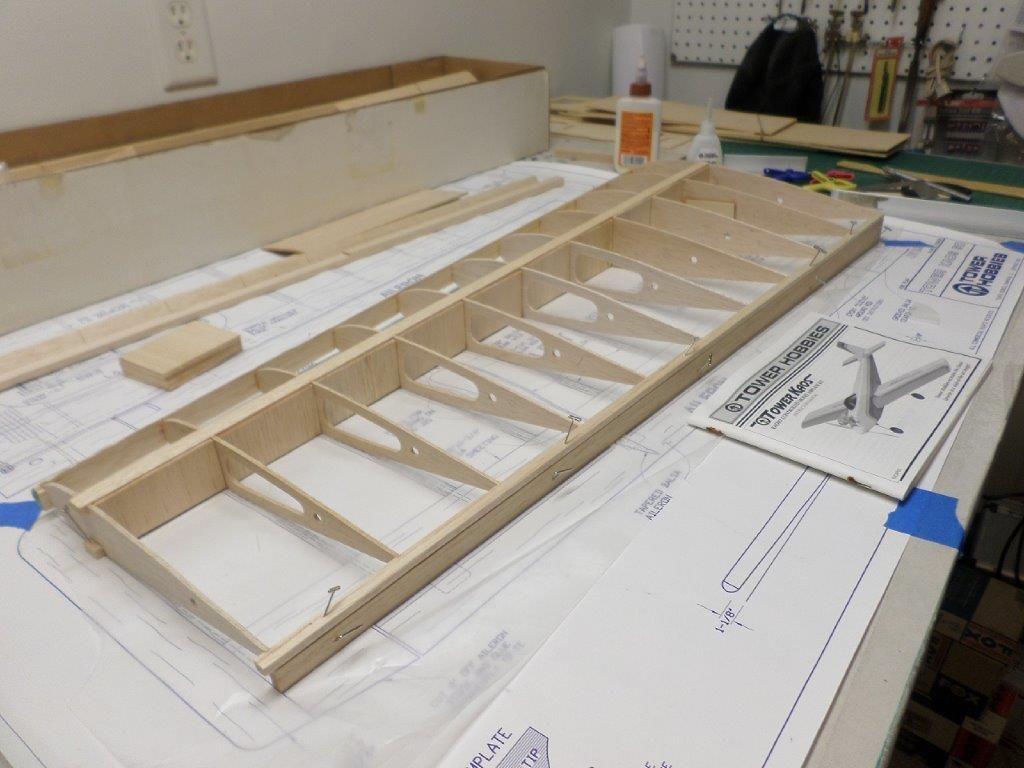

I did a bit more looking at parts in the kit and found they indeed included a jig for the trailing edge of the wings.. So... I got this far... It is the left wing. Going together very well. It is an easy kit to build.... I enjoy building just as much as flying so I take my time and do things right!! :

Well, not much happening on the Kaos, I have sheeted the top of the wing shown on the photos above, I also installed the landing gear mount. Sorry no retracts for me... I am in the process of mounting the aileron servo in the one wing, one in each wing.. Then I broke my ankle so not much standing in the shop for a bit.. Will show more photos as I get going again..
