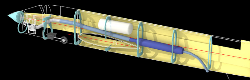

I built a preliminary 3d model to visualize how the guts of the plane are going to work out. I've got the header running up and over the wing, to a piece of long silicone tubing into a Soundmaster muffler beyond the wing saddle. There's also an option of putting the tank right behind the engine, but that would be a tight fit for the nosegear. I would also lose the "trendiness" of having the tank at the cg. I think I might do an alternative layout with the exhaust running up and into the turtledeck Magic-style. It might make it easier to put some servos over the wing.

Ok, I've got a new layout with the muffler running up into the turtledeck... looks much more user friendly with regard to the radio installation.

Just a word of caution - using a long, small ID diameter exhaust tube like that may (will?) result in unacceptable engine performance. All manner of pressure distributions will occur (experience with this) which ma result in undesired back pressure issues, and there are some temperature/heat transfer issues to consider as well.

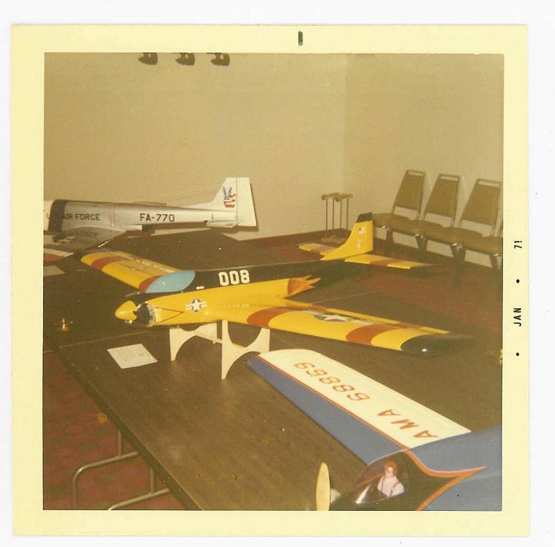

Ralph’s Gladiator was Kitted by Fliteglass, located at the time near Ralph’s home in South Seattle. I do not recall ever seeing any Gladiators other than the Fliteglass kits that were pretty popular around the Northwest.

Thanks, 8178. Was it a good flier?

The ones I saw flew very well but were a little heavy and had a pretty big frontal area. I believe other than the fuselage it shared the Crusader parts. Of course it had a foam wing but looked like the Crusader wing. The one you see in the picture above was before the one he built and flew for the Masters.

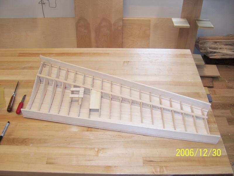

I managed to get the wings framed up. I'm currently sheeting the bottom this evening. I hope the swept wings don't do any weird saberdancing in flight.
A big thanks to Joe Bridi for the "lost jig" idea for building straight wing panels.

Very nice work. The only tricky part with swept wings are the retract gear mounts and fitting the wing to the fuselage.
