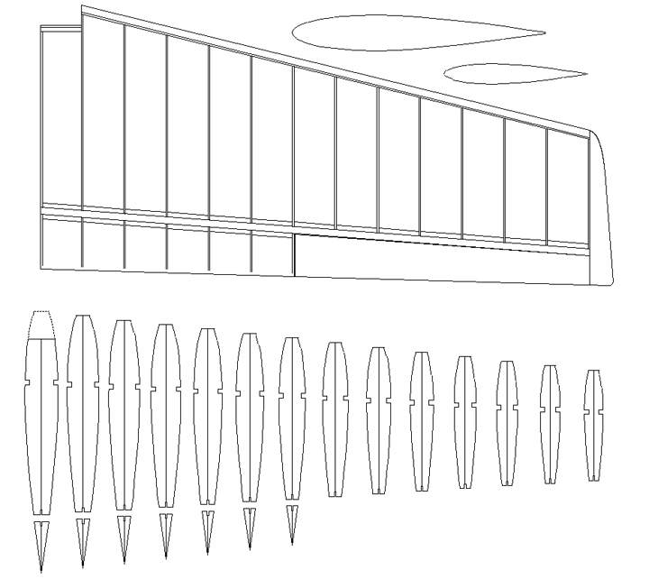

It's going to be a long, arduous task, but I've got a start. I'm trying to remain true to the original construction methods, including the tongue and groove trailing edge assembly. The only changes I've made so far are to round off some of the metric dimensions to the closest fractional inches. I'll probably work on a laser cut file for the ribs tonight. I'll add holes in the ribs for a wing jig, too.

A bit more progress. This might not take as long as I thought.

Thanks for the encouragement, y'all. I want to take my time and do it right. No rush on this project.
I'm working on the forward engine/nose gear sub-assembly now.

Are those root and tip ribs you show on your wing plan accurate? If so, is that the exact center rib? If those first two statements are true, (and I'll bet they are), can you do a foam wing template? That would be simply taking the root/tip templates and taking 1/16" off top/bottom to account for the wing sheeting. It would sure make my life easier and then it would be much easier to make foam wing/stab of the Aurora. Let me know either here or in PM....and think that a few people might like a set of cores..
Dan

The root rib is accurate. It is not the pattern shown in the side view, which is smaller than the root rib - as you know. On the plans the wing's center section is notched to fit into the fuselage. I drew extension lines on the root rib and LE to get the correct root chord (see drawing). It's very similar to the NACA 0013, but slightly different. The front 25% is tiny bit more pointed.
Since the tip airfoil is not shown on the plans I used the root airfoil, so it's a constant airfoil like what you did for the Blue Angel. If anyone here knows the tip airfoil to be different, chime in, since the plans don't provide that info (at least not in English).
