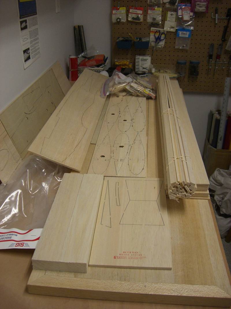

Well, relative's gone, inventored the Qwic-fly man I gotta till you this is one first class kit from jeff! took the new 55AX and layed on the plans to see how it would fit, its going to be a tight fit, see pics ,jeff talks about Phil Kraft made an aluminium back plate for the engine, its petty involved I don't think I'll do that, just use beams of the fire wall. Will send more pic's soon.

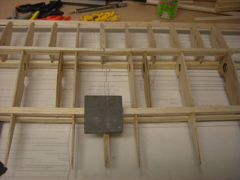

Started the wing, you must build 4 spars the splicing of the spars to make a one piece wing is were you must pay attention the wing dihedral is set with the spars The remaining of the wing is easy, just keep everything pinned down as long as you can so warps do not develop. still have the sheeting, landing gear, and wing tips left. I'll be out of town around 10 days so no building until then.
Pete
