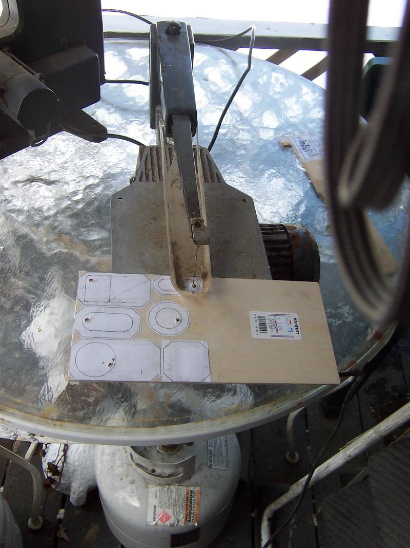

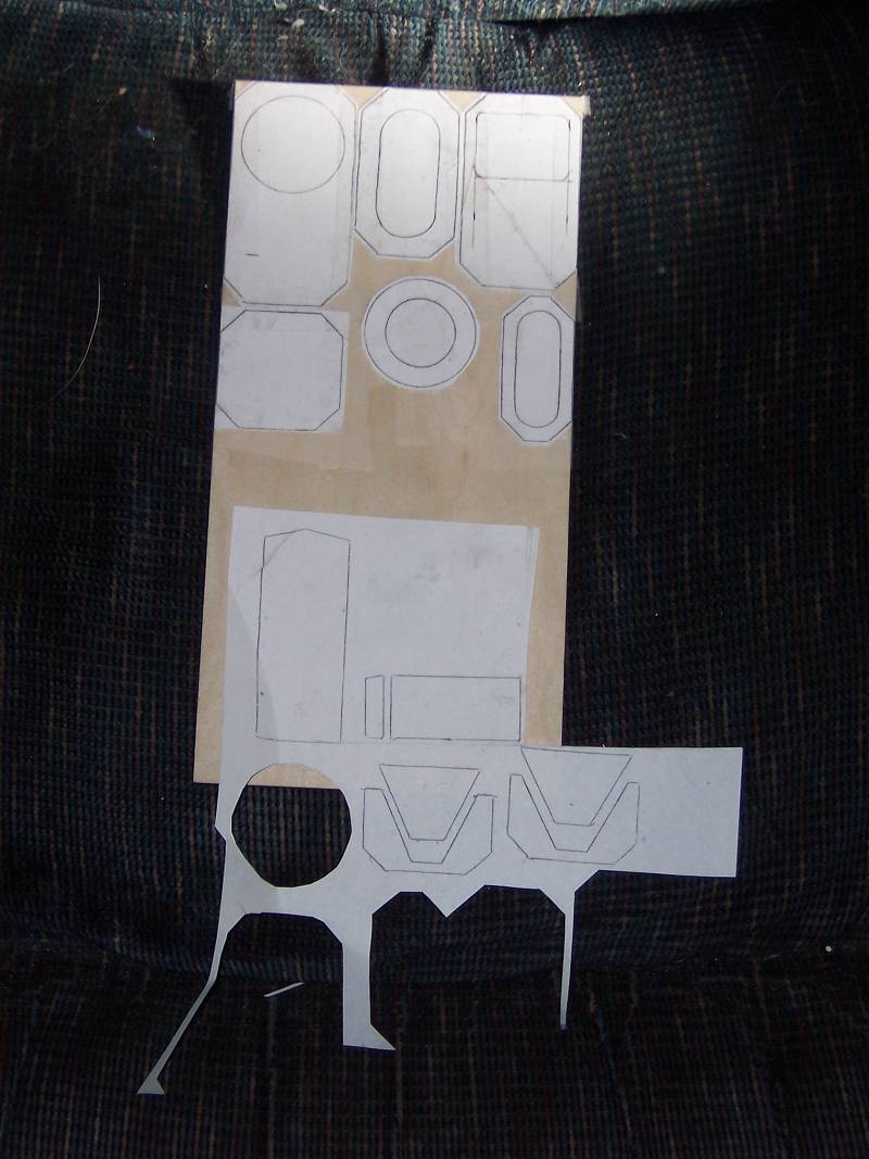

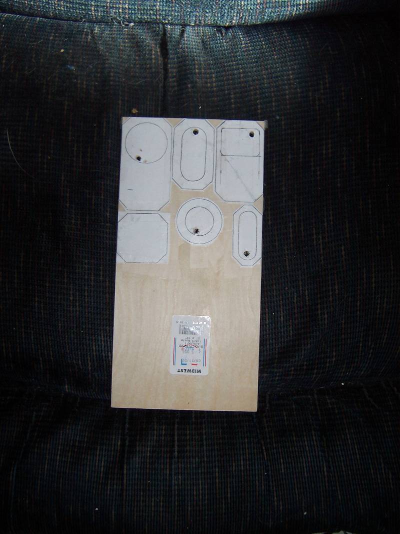

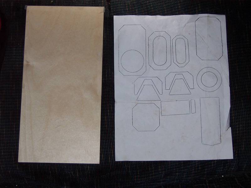

I had the fuselage formers traced out from a kit and scanned into my computer for quite awhile.now they are printed out and then cut out and either taped or rubber cemented to the 1/8 ply.

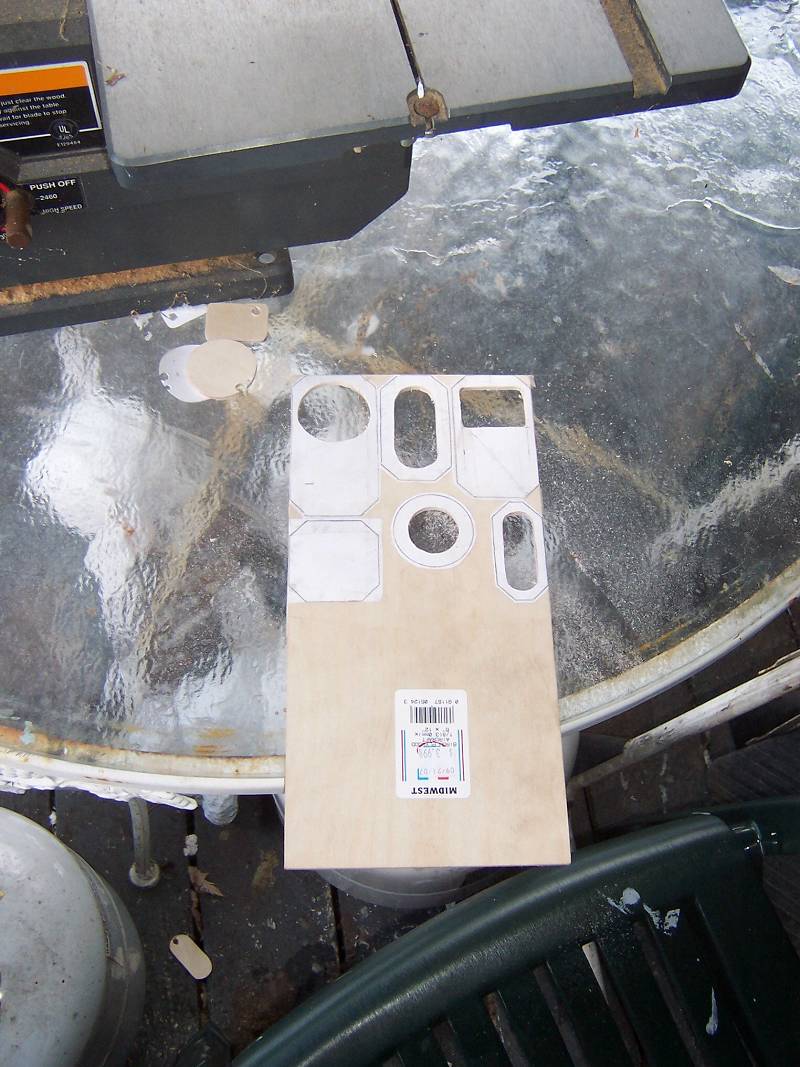

once they are secured to the ply,I like to do the inside cuts first and have drilled holes for the jigsaw blade to pass through

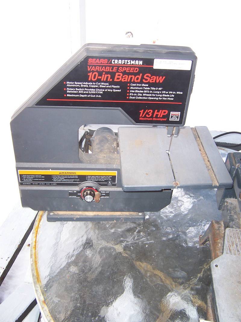

now that the inside cuts are done ,time to switch to the bandsaw for the outside cuts.

Just a question. Is it easier to make the outside cuts with the bandsaw rather than the scroll saw?
Jim
Old 01-23-2008, 06:17 PM
aerowoof
Join Date: Jun 2006
Location: pembroke, NH
Posts: 2,985
Default RE: Peppermint Patty build
in this case it was because other than the nose ring all the formers are basically rectangles and therefore the cuts are straight.I can cut faster with the bandsaw as there is no vibration like with the jigsaw.

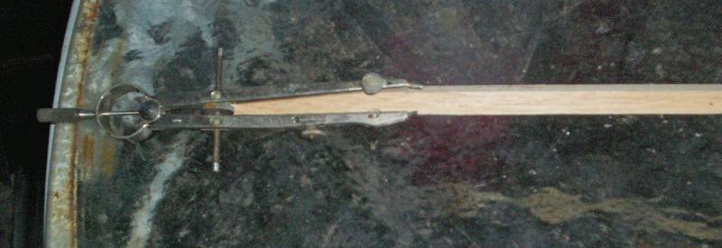

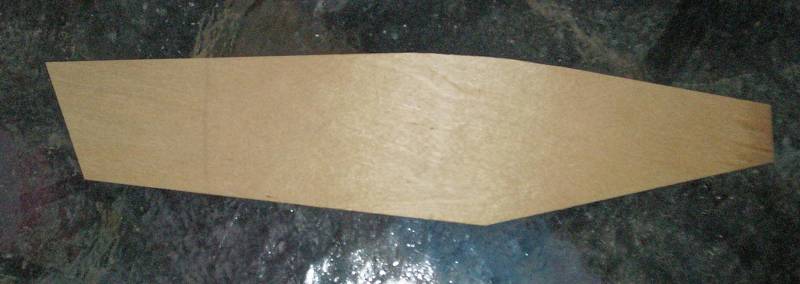

it's been a while and the fuse sides have been cut as well as the ply doublers andnow it's time to cut out the wing saddle and hatch.old drafting compass was used after it was set to the thickness of the 3/8" tri stock to mark lines for gluing and to make the ply doubler

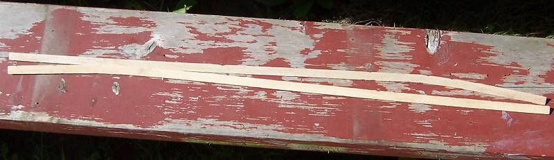

while the bend for the tri stock is not gtreat I like to relieve the stress in the wood by preforming,this step os not really neccassary but it something that I like to do and does not take much time,it will be dry by the time I cut the lawn.both pieces of tri stock are soaked with hot water'put in the tub and tuen on the hot water for a few minutes,pin the sides to a stout wood block here a scrap of 2 by 6 is used then using the doubler as a form bin the outside edge starting at the nose and slowly bending around the doubler,pinning the outside edge to keep the stock tifgt against the doubler

after drying the tri stock takes a permament set to the curve of the fuse botom, note one right and one left.
