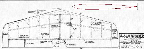

Here is a link to Jim Kirkland's A6 Intruder. I had these plans scanned a couple of months ago.

David (and gents) that’s a nice plane but?
Why that horizontal sheeted tail plane has a diamond shaped profile?
And that Wright Flyer fin?
It looks like a jet with Wright Flyer tailfeathers.
This plane is for shore not designed by Ed Kazmirski.
Or diamond shape and silk covered (1961 and older ) or sheeted with a good profile (1962 and younger).
Will the plane be SPA legal with a good profiled tail planes? At least it will fly better for the same investment costs because all you have to do is throw away less wood.
NACA 0009 smoothed, me seems to be a good choice! What do you think?
And if you already fly the plane?
I would remove the diamond shaped and modify the plane with a profiled one and would do that with that fin also.
Or do I say something wrong?
Cees

In the original article by Jim Kirkland he explained why his choice of a diamond shaped horizontal stabilizer was diamond shaped.
"Horizontal stabilizers have bugged me almost as much as wings have, and for almost as long! There is something about the stab's small size that just yells for inattention, especially after working on a wing! The natural tendency is to build it flat and get it over with! Howwever, after many hours of flight evaluation it became obvious that a flat stab just couldn't measure up to a symetrical section. About all that I can say today about a flat stab is that it is adequate for horsing around. ........
The diamond stab has better flight characteristics than any previous airfoil stab I have used in the past! I do not know why, but the diamond stab seems to make a pronounced difference in the way the Trition and Intruder handle just before landing touchdown. It is as if the stab helps tremendously in holding the model off until the last instant, and then holds it just a little longer! The phenomenon must be experienced to be fully appreciated. In flight, while performing various maneuvers, I can tell no difference between this stab and a symetrical airfoiled section of the same thickness and with the same leading edge shape."
He also claims there was no intention here to claim originality in the use of a diamond stab on the Trition and the Ed Kazmirski used a diamond section on the Taurus.
I can't make a comment on the difference, as I have never built the plane or flown it. I would like too. A lot of these older designs were eye catching and suppose to be great flyers. I used to see koas's, mach 1 and other pattern planes at the local club field when I was younger.

Although I've never tried it, I have read more than once that the diamond airfoil softens the elevator. Basically, it was supposed to function like having a little bit of Expo, before the days when radios had this feature. But, it's important to emphasize that I read this somewhere and it might not be true.

Sometimes I do start a discussion to hear others ideas about the differences in our airplanes and thank you for explain.
My opinion is that the incidence of a airstream on an profiled stab can be a little worse than a diamond shape and still working.
Best of all is what we in the Netherlands call the ”pendel” elevator, all moving stab?
The same thing we can think about the ratio stab versus elevator, the bigger the elevator the less problems with the stall speed of the stab until you also in this explanation reach the limit, 100 % elevator so “pendel” elevator, or all moving stab again the winner.
The difference between a profiled and diamond will not be much I think, but when we look at the low speed and at touchdown, it think the profiled is the winner.
Sometimes it is good to look at the gliders.
About the fin, as like a non-profiled stab.
The corner of an incoming airstream more than 8 degrees from the centre line, I think it is over with this fin. Diamond will be better and profiled the winner. So in all low speed maneuvers and problem situations maybe a good fin is a profit.
Question, was the A6 also designed for the ‘knife edge’ maneuver?
I can explain it all as all the profiled planes have a balance of forces up and down. (Fin left and right).
Any curved surface, so also the top- and bottomsurface of the profiled/diamond stab, generate a underpressure, (Bernouilly) in an airstream.
The balance of these two forces changes with the incoming corner of the airflow.
No profiled result in, no underpressures in a central airstream with central elevator (and oké CG!), so no balance of forces in the neutral situation, result is hysteresis and sometimes waggling of the tail, up/down, left/right.
And that is what they mean Rainedave, like a little expo, profiled
And less stablility in the neutral situation, adequate for horsing around, for the Non profiled.
