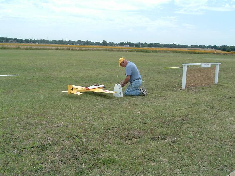

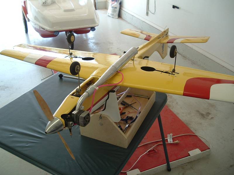

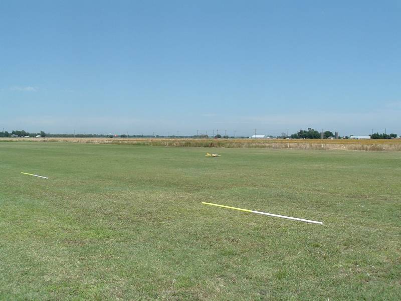

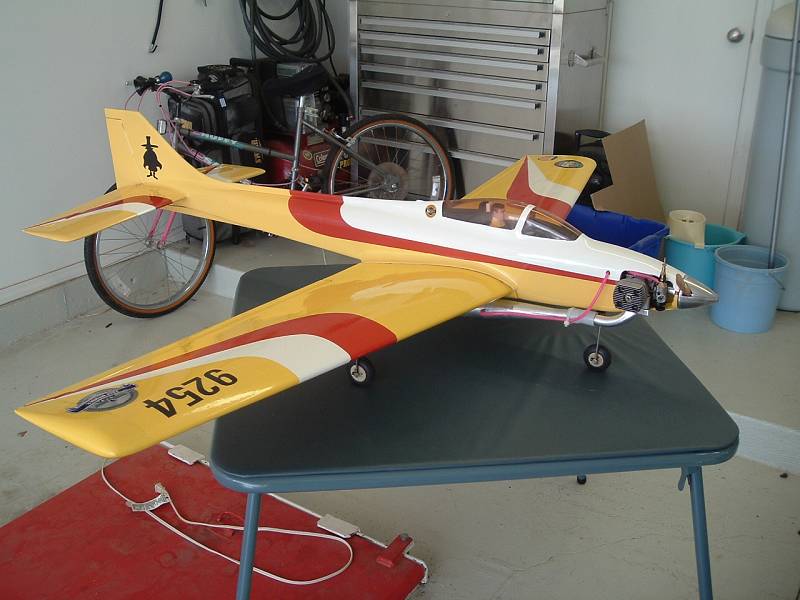

Took the Revenger out this afternoon for the first flight in 30 years. Everything worked great (should with nee radio and engine) and only required minor trimming. I am attaching a few pictures for your enjoyment.
Dick

Dick,
Looks real good.. wish it made the SPA cut off date !!! It would have been nice to fly one..

Very nice - looks "slick" in the air. Welcome back. Kinda feels like riding a bike, doesn't it? You never loose the feeling.

Way to go Dick! For those who don't know, Dick Russ is the designer of the Revenger. I reviewed a "Model Merchants" ARC kit of the Revenger in Jan 1980 Model Airplane News. Mine ultimately fell to radio failure, but was a very sweet-flying bird for quite some time.

The original Revenger photos I posted earlier crashed turning final after the fourth flight. I had seen some stress cracks in the tail (and should have paid more attention to them); but why not a few cracks after over 1100 flights and thirty years. Apparently after doing some high stress aerobatics, it was more than the tail could handle and snapped off as I was turning final. I still have another that is built but not finished that I will complete and fly soon.

Regarding the failure of the empenage on the original Revenger I designed. As I mentioned before, the plane was over 30 years old and I stopped keeping a log after 1100 flights. After bringing it out of storage I noticed a crack around the entire empanage near the leading edge of the horizontal stabilizer, but thought it was just the old epoxy paint cracking since there was several cracks in the old K&B Epoxy paint.
After careful examination of the wreckage, it apprears the stress cracks in the balsa sides were quite old. I could determine this by the discoloration of the balsa wood on the fuselage sides where it failed versus the fresh cracks on the ventral fin and the dorsal fin. which was all that was holding the tail on.
I'm not worried about the strenght of the tail on my new Revenger that I am nearly finished with, but if I were to build a new one from scratch, I would change the design to add two 1/64 plywood doublers to the fuselage sides below the horizontal stabilizer and extend them at least one inch forward of the leading edge. This would add substantial strength to the tail and have very little effect on the weight and balance.

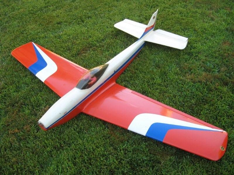

Here are a few pix of the Rustler, hope they come out OK, my first try at posting pictures!

Thank you for posting the pictures. They bring back great memories of when your Dad and I started Allied Hobbies Manufacturing and were flying the Pattern Contest Circuit.
You are right about the Rustler. It was a plane I designed between the Integra and the Revenger. It flew better than the Integra but not as well as the Revenger. Each of the designs had special flight characteristics based on the class the pilots were flying. Each plane flew very well but as the pattern manuevers became more difficult, I made changes to each design that I felt would improve the way they executed the manuevers. As you may remember, each design was capable of winning any pattern contest. Back in the seventies you could always find an Integra at a contest and the flyers normally always took home a trophy
