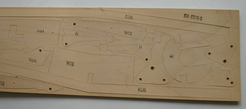

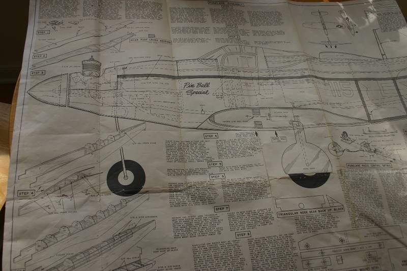

The UPS man just delivered the Sterling P-63 kit I won on ebay. Talk about a trip down memory lane. The plans look just like those of the Sterling Ringmaster U-Control kit I built 100 years ago as a kid. There are text instructions and isometrics filling about every inch of space on the two side plans.
The parts look as though they have never been out of the box. On the top is a die cut ply sheet with little brass eyelets installed for all the control horns. There must be a million little parts, and huge precarved balsa blocks with carving both inside and outside. For a Sterling kit the wood seems quite good. I took a crack at a Sterling Flying Fool kit about ten years ago. The wood on that one was so bad (hard, heavy) that I gave up on it. This kit is certainly buildable with the original wood.
In summary, worth every penny.

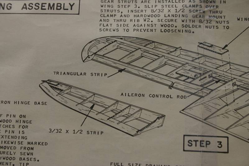

Here are some details of the aileron hinging as mentioned early in this thread. The ply die cut sheet has preinstalled brass eyelets for the control horns and for the hinge pins. The back view shows how they are riveted in place. Imagine a kit manufacturer doing that today. The die cutting quality and ply condition may also show up in the photo. One end of one die cut sheet has the ply delaminated and those parts will have to be replaced. Luckily it's not the sheet with the eyelets.
The ailerons are hinged on the end ribs only. The pushrod from the bellcranks comes out the top of the wing. It appears that the Cobra shown in the link (post 11) was built with the original aileron setup, because the pushrod can be seen exiting the tops of the wings. The plan shots also give an idea of the level of construction detail on the plans.

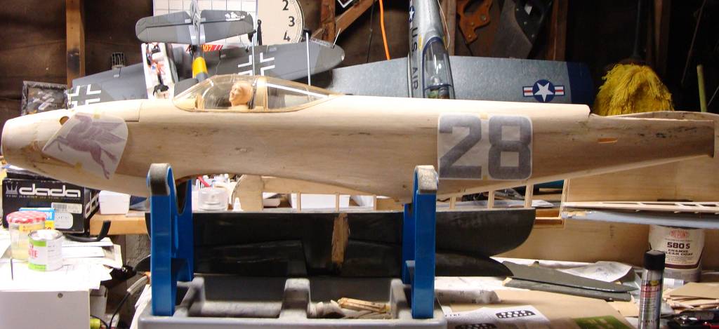

King Cobra model is bare, wing is kinda finalized, fuse is shaped with cockpit and canopy to go on then I'll c/f the body. I'll cut the tail off and rebuild the stab and fin and rudder.
Quick, all-white paint scheme (Lustrekote spray cans) with famous racer markings (Charlie Tucker #28 with red pegasus on nose). Wing and tail Monokote. Williams Bros. racing wheels with hub caps and hopefully a test and trim day before a Scale contest (Fun Fly really) on the first weekend of November.
Chris...

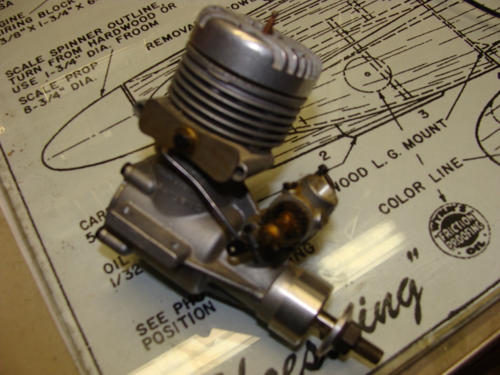

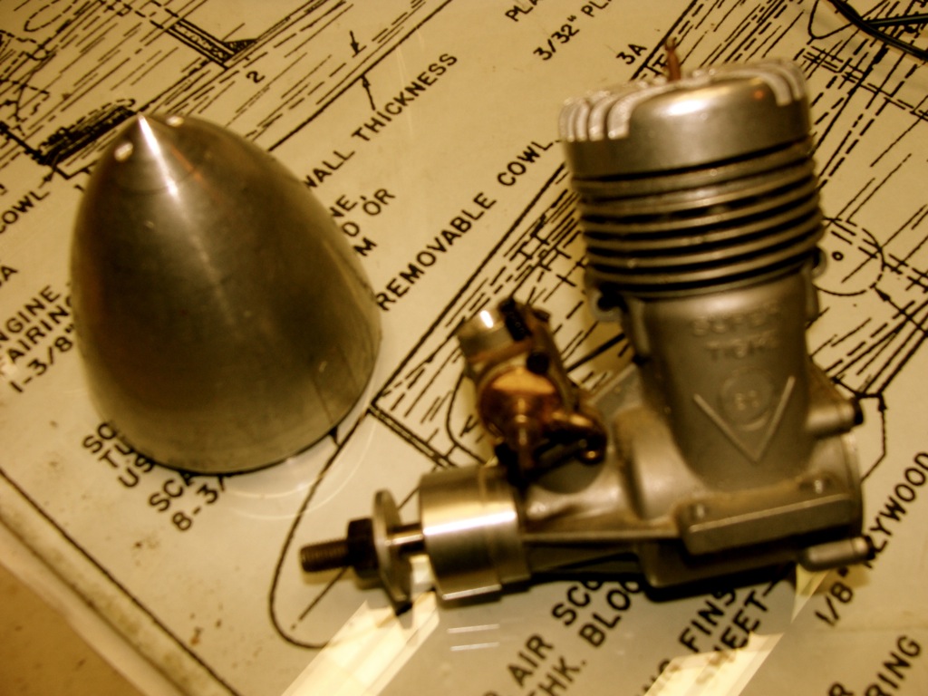

I bought a NOS Super Tigre V60 with an uncut NOS Froom Spinner. Quite a nice find. Does anyone know of an available MACS open front muffler for this engine?
The ideas I had for mine 3 years ago all seem better suited to the models I have acquired since. It'd be better to make this one a tribute to Maxey Hester.
I kinda got the idea from the Kaos I saw at the AMA Convention last year. Period stuff is cooler for this ship.
Chris...

My good friend Tom Lay found an old open face Super Tigre/Semco/Macs/? muffler for my NIB V60 R/C and my son has just left for his mother's after a lot of flying here on summer vacation, so I've started back on this model by mocking up the cowling.
Also a challenge is that the motor mounts are too wide to catch any of the Tigre's mounting bolts. I may have to gut the front end to install a firewall motor mount. If that won't work, possibly rock maple mounts. This thing hasn't been easy from the start, but I'll get it flying no matter what.
Chris...
