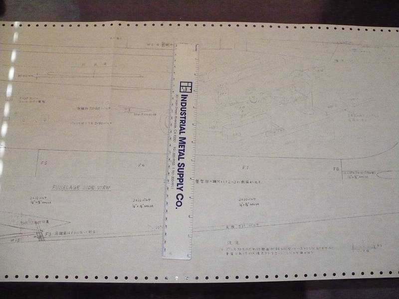

Doxilla. Tiff files only lose information if saved with jpeg compression. If you use LZW or Zip compression when saving the file no information is discarded and you have no loss in graphic quality. From a scaling stand point PDF's do scale semetrically. but that's only if you have the Pro version of Acrobat.
I have all my plans scanned at my local comm. printer and placed on a USB Drive. My experience with them is that they use tiff as the medium for graphics and scan most of their plans at 400 dpi.
If you have the Professional Version of Acrobat it includes a PDF printer driver. This is a great feature of Acrobat Pro in that it allows you to print anything to a PDF file form any application. Once you the PDF you can open it back up in Acrobat Pro and save it to a graphic file of your choice, tiff, jpeg, etc. The only problem with this method is that Acrobat Pro has a problem saving large scans, like our model plans, to editable graphics files with a dpi larger than 200.
I have not seen a commercial or retail printer that does not use photoshop so I would say that that tiff's would be best for the graphically challenged. I say this because there are alot of inexpensive graphics applications that will read tiff files. This would allow a novice to scale his drawings to whatever size he chooses.
I personally perfer tiff's in that I cut and paste directly from the tiff to a new tiff, which cannot be done when it's a PDF.
This saves me dollars printing costs in that I can print out my own plans on an older inexpensive wide carriage printer without having to scotch tape the pages.
