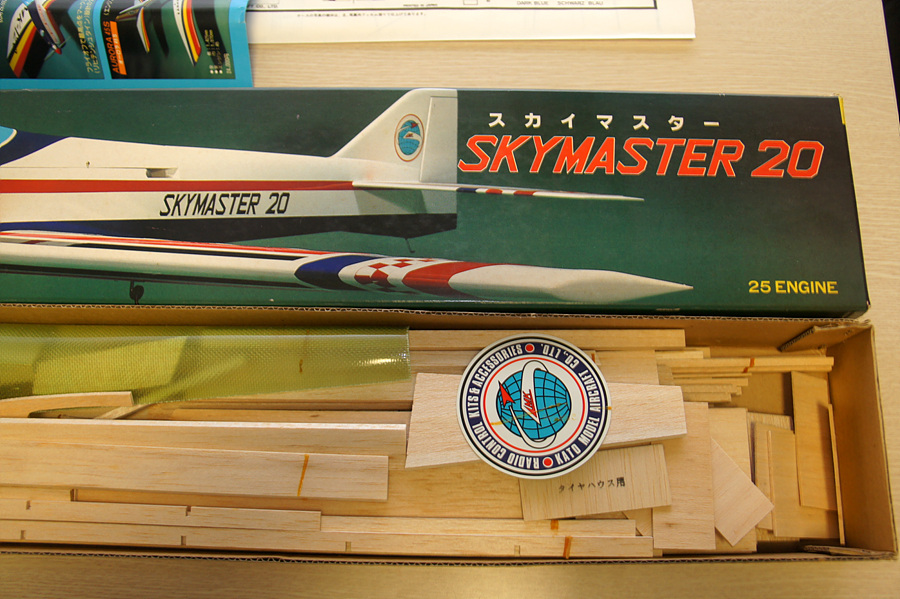

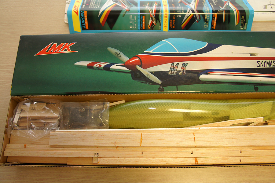

Originally It is recomended a MK 150cc fuel tank, but I used the MK 190cc oval type fuel tank for the aurora 25.
And a.u.w without fuel is 1395g+ 55g(prop + spinner ) with 1600mAh 6V 5cell Ni-MH battery.
I saw a Hatory header for Arrow 20 (OS 25vf abc), but never find the MK arrow 20 in Korea & Japan at least today.
I like MK SKYMASTER 20 so much , but next project is other one,
Here is one complete set of MK SKYMASTER 20 of mine,(thanks for providing glass deck for me)
JHMIN

JH,
I hope you're enjoying your Curare's!
The 190 cc (~6.5 oz) tanks for the larger MK and OK 20 size birds (Aurora, Cosmos, Joker, Kingbird, Mystic, Rubin, etc.) makes a lot of sense. I'm hoping that in re-designing them I might be able to fit a 7 to 8 oz tank (200 - 236 cc) particularly if they have plug-in wings (Aurora, Cosmos, Mystic, Arrow?). For the smaller guys (Curare, Magic, Mattlas, Skymaster) a 5-6 oz (150 - 175 cc) seems more than enough as these are using 25-32 size engines instead of 35-40 size.
Originally Posted by JHMIN (Post 11906724)
I saw a Hatori header for Arrow 20 (OS 25vf abc), but never find the MK arrow 20 in Korea & Japan at least today.
Yes, I'm not certain but I suspect that MK had plans to do the Arrow 20 and maybe Hatori got ahead of the plans (literally) making the appropriate header for the 25 VF. In any case it should be a standard 1/2" or 1" fuse top header. An Arrow 20 would be just too cool on the fight line! Now there is even a very powerful NovaRossi 28 RE (not a Japanese OS but given the Arrow is a European design, an Italian engine seems fitting. :))
I like MK SKYMASTER 20 so much, but next project is other one,
JHMIN
I guess that makes two of us - SM20 perhaps my favorite RE design with the Arrow 20. One day I hope to have a pair on the flight line side by side. But you'll probably get there much before me! if I only spent more time building and flying and quit all this conservation effort stuff! :rolleyes:
One of my ideas (and I'm not the only one) has been to modify the Magic 20 design to a RE (Skymaster like) inverted engine setup - like its bigger 40 and 60 size siblings. But there is much to do already. Working on a Mystic 45 CAD design at the moment. Hope to be prototyping it before years end!
I'm eager to see and hear about your next project.
David
