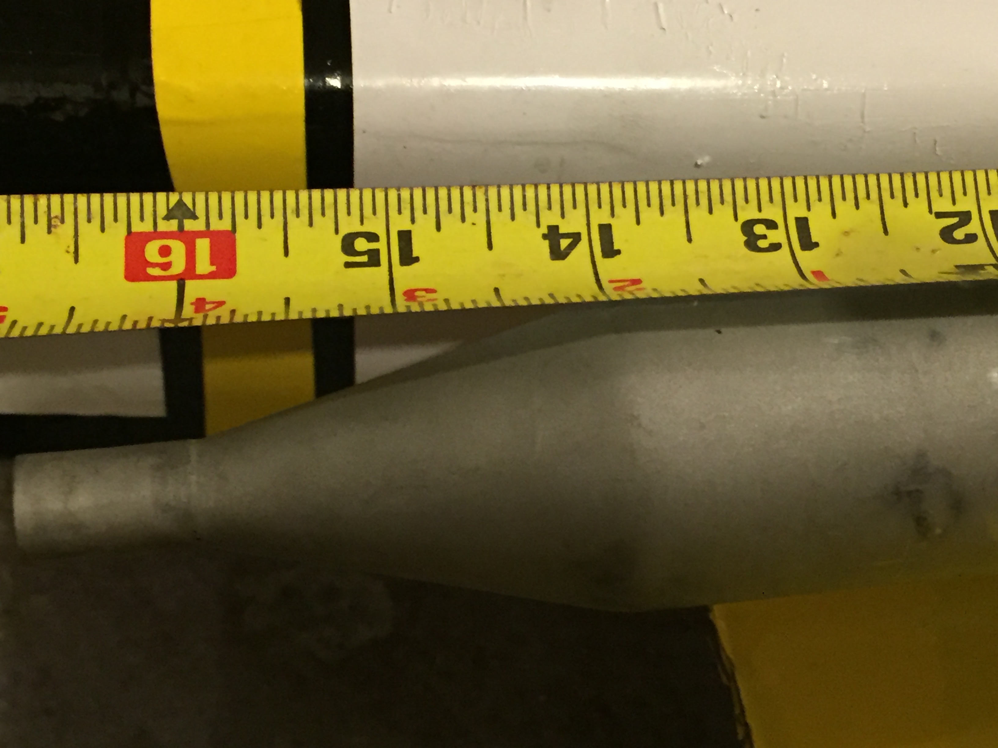

the macs tuned pipe measures 17 inches end to end.
the header measures 4/12 inches from glow plug to end.
the coupler has a gap of 1/12 inches.
Where is the restrict or located?http://www.rcuniverse.com/forum/atta...mentid=2128092http://www.rcuniverse.com/forum/atta...mentid=2128092total lengh of pipe 17 inches

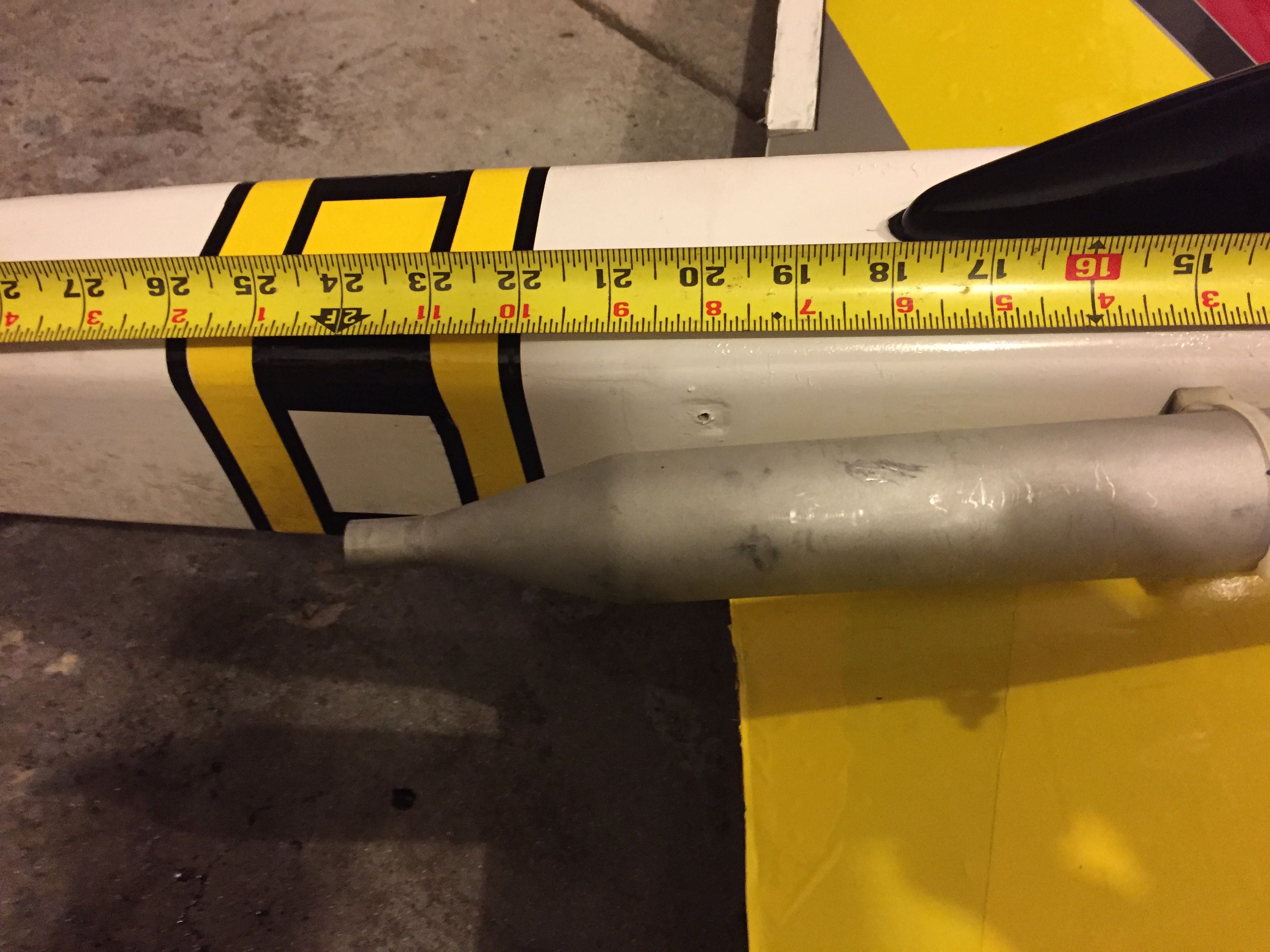

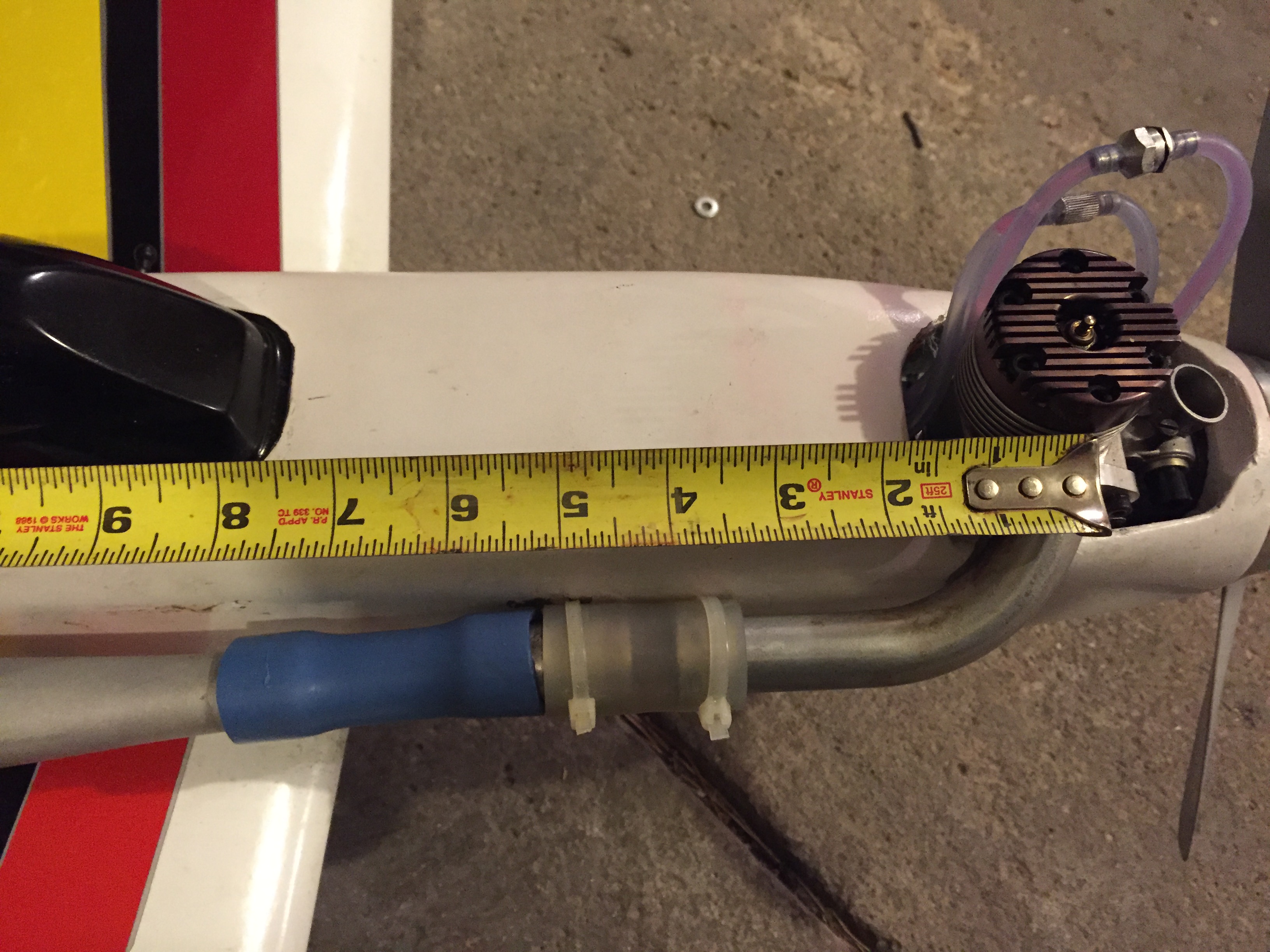

Cbfn1 10-28-2015 04:10 PM
1 Attachment(s)
http://www.rcuniverse.com/forum/atta...mentid=2128093Length of header.

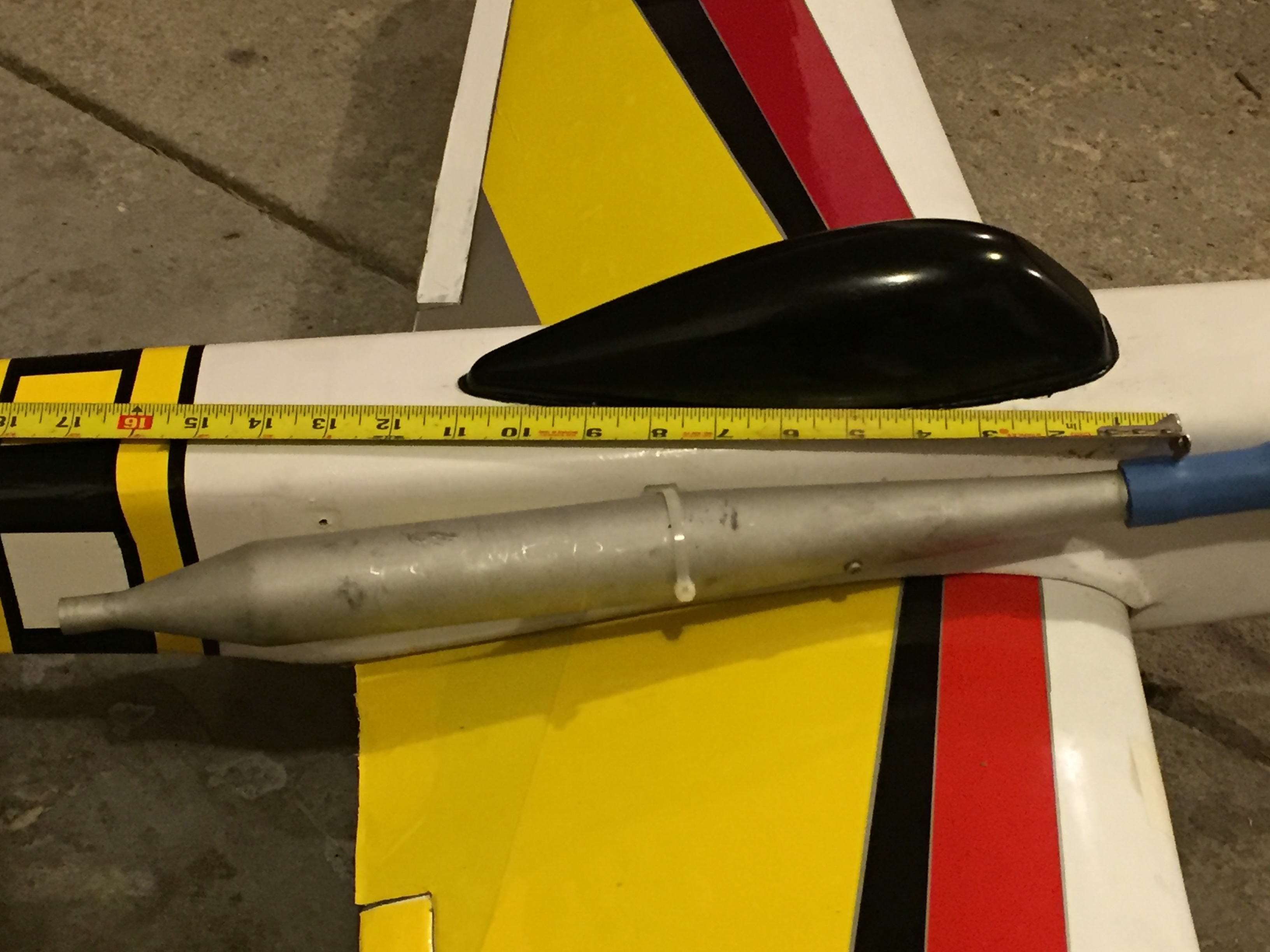

Cbfn1 10-28-2015 04:13 PM
2 Attachment(s)
http://www.rcuniverse.com/forum/atta...mentid=2128094http://www.rcuniverse.com/forum/atta...mentid=21280952nd photo is total length from glow plug to end of pipe
doxilia 10-28-2015 04:34 PM
Why are there two couplers? You should use one and keep the gap to about 1/8". The second blue coupler appears to be lengthening the exhaust by over an inch! A squeeze like that in the exhaust is not good.
If your header is cut too short, then add alum tubing as you have but use the couplers as such not as pipe lengths. The length of importance is the one Will described. You want to be at ~15" from plug to end of expansion cone around the header on an 11x7 or 11x8 and YS 20/20 fuel and tune from there.
David

...To find the cone, run a dowel or balsa stick into the entrance of the pipe until it hits the cone. It's a 'cone' so try to keep it against the wall of the pipe. Mark the stick, and take it out and lay it on the pipe. That's where the cone is.

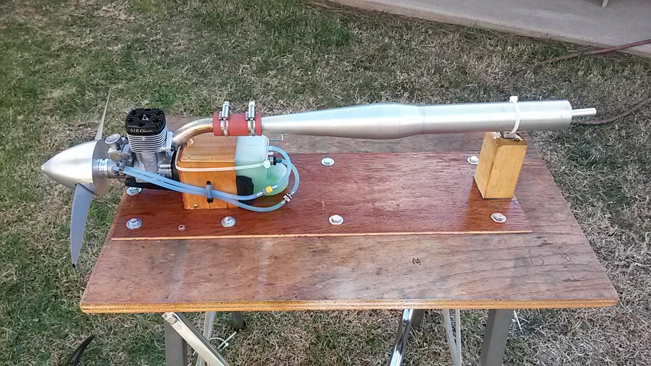

To extend Matt's comments, what is often misleading is the cylindrical shape of pipes aft of the diverging cone stemming from the header/pipe junction. These pipes are often referred to as "muffled" or "quiet" tuned pipes because they consist of a cylindrical outer shell welded about the converging cone at the widest diameter, or aft of the baffle(s) in the case of a pipe with such a design. These sections act as a silencer when the tuned exhaust passes from the converging or baffle exit hole. Because these longish muffled sections don't contribute to the resonance aspect of the pipes function, the length of importance of the pipe can often be hard to assess by simple inspection. In this case Matt's and Tim's system must be used to determine the "resonance length" of the pipe.
A good example to look at are Macs aero pipes since they have three different types: tuned, muffled and quiet. The first, "tuned", is a pure double cone resonance pipe with no muffling ability other than that offered by the virtue of the pipe presence over an open exhaust. These pipes are sometimes referred to as "speed pipes" as they are purely performance oriented. The second "muffled" type is the kind that has a cylindrical aft muffling section and are therefore quieter than the tuned version. The last, "quiet", is a muffled pipe with a longer muffling section and either a baffle in the muffling section or a second stage muffler (i.e., two concentric muffling sections).
In principle, the muffled and quiet versions of the pipes offer most of the performance advantage of a pure tuned pipe while also offering substantially quiter operation. Muffled pipes are sometimes used on sport models while the longer quiet pipes are often used in 2-stroke engine pattern designs like the classics discussed in this forum.
The pipe images below might help to better understand the comments.
David
time907356 10-31-2015 05:03 AM
1 Attachment(s)
This is a pic of Robert's pipe, and the one I also have. I am using a Macs 15deg. header though. Notice how short the header is!? This pipe is the one I referred to as having a baffle at 13" from the inlet; quite long! I'm going to examine a little closer before cutting again, based on the input above, but I'm still 2-3" longer than Robert's set up here, and shooting for the same rpm/engine/pipe/prop combination. 14000rpm's on an 11x9 will carry any classic design around well. Even at 13600, the Brushfire I saw fly last weekend had a great hookup; nearly the same speed through maneuvers at ~8.5lbs.
http://www.rcuniverse.com/forum/atta...mentid=2128490
Jim Oliver 10-31-2015 11:17 AM
That appears to be a Mac's Flatback pipe; I have two or three of them; mine have no baffles, just converging cone with a muffler section added on.........daylight visible from each end.
